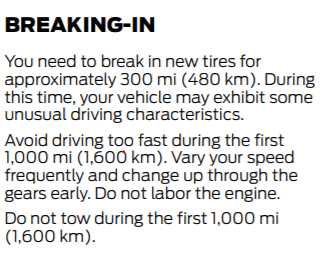

I found this article a few years back and it really made sense for all cars...
