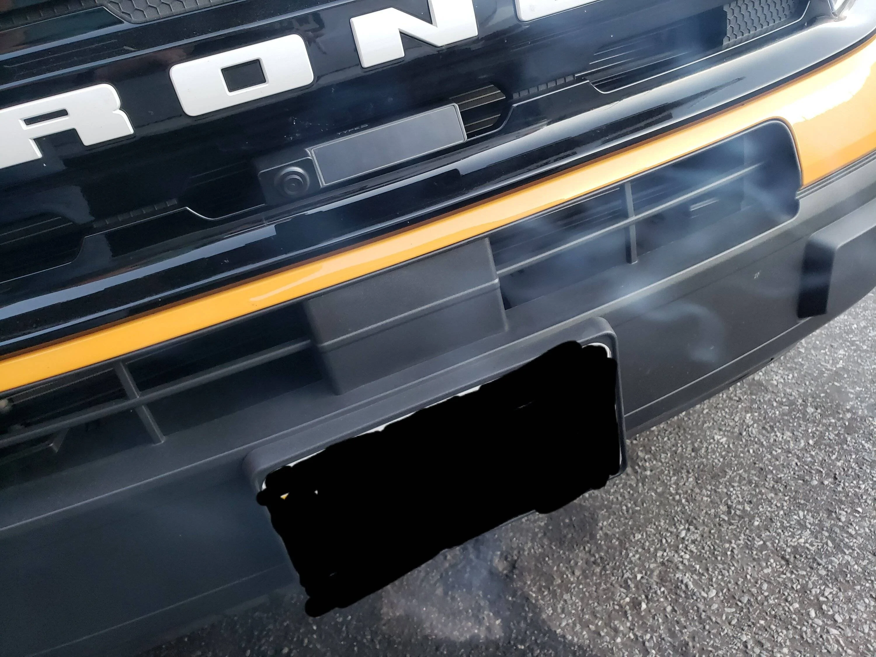

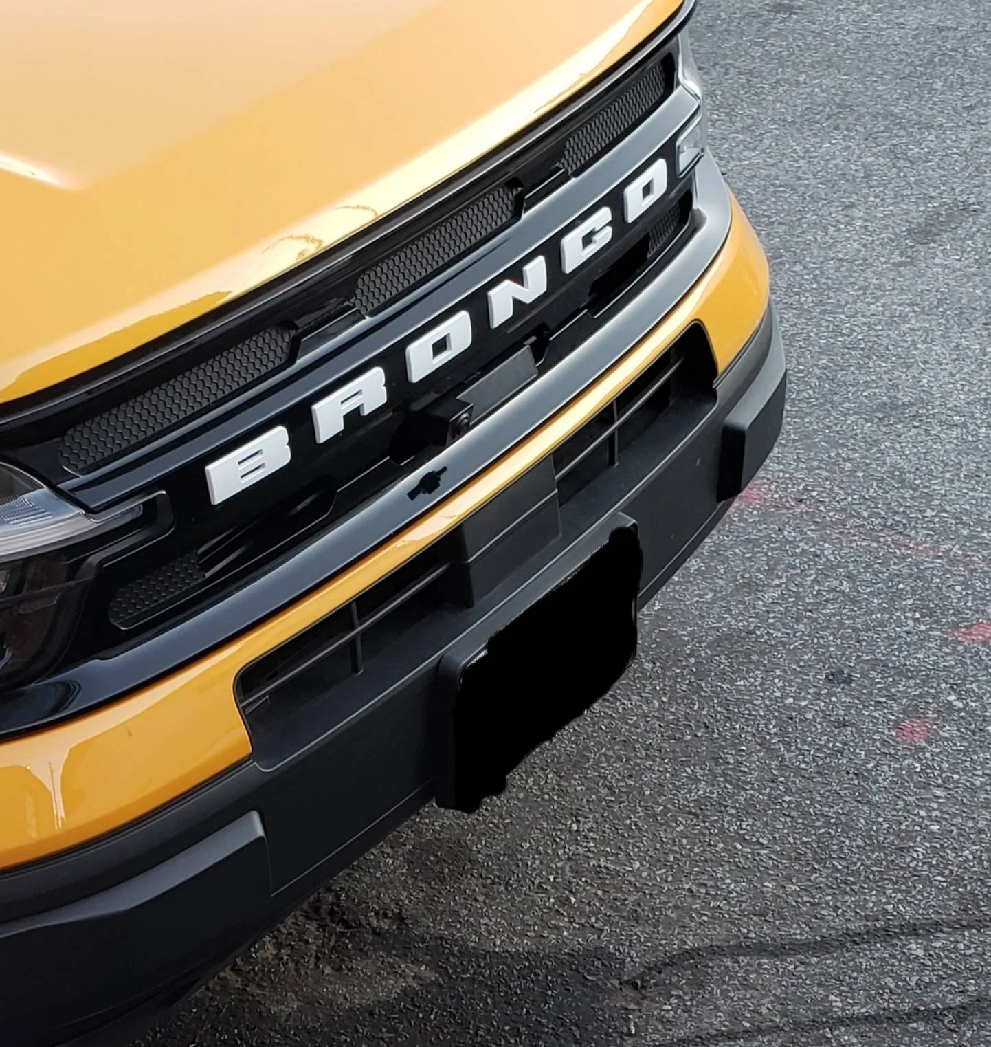

Update: After some research, I've decided to go wireless.
https://typesauto.com/collections/backup-cameras/products/type-s-hd-solar-powered-app-view-backup-camera-bt57799
TYPE S Solar Powered Smart 1080p HD Backup Camera-130$
Ford Bronco Sport Front view on touchscreen 20220819_085633
Picture comes up on my phone. Disadvantage is you've got to connect to the backup camera every single time, connection delay 30-35 sec.
Ford Bronco Sport Front view on touchscreen 20220819_084135
Good thing: has no cables. Wireless and Solar. Battery is always full, after 7 days. Double sided tape will do the job.
Ford Bronco Sport Front view on touchscreen 20220819_090355
Ford Bronco Sport Front view on touchscreen 20220819_084303
Also, found solution to have front view on touchscreen, but it's but expensive/no point to spend extra.
