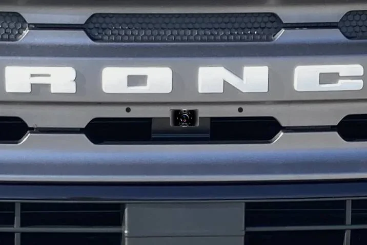

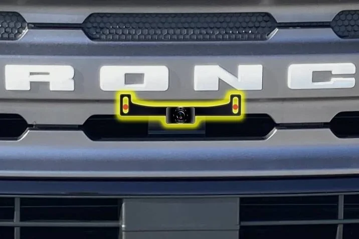

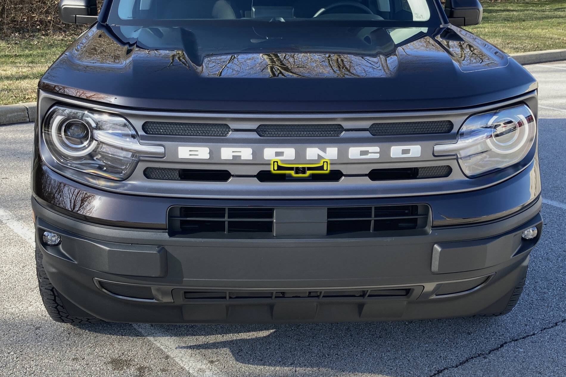

I bought one from Amazon and it looks like it's going to work. The way the bracket for the camera is designed allows it to tuck up under the grill opening. Just have to drill a couple of holes. When it's mounted you'll just see the camera and it can be adjusted up and down. There are a couple of issues that can be corrected (more or less). 1. The camera will be mounted upside down. 2. The screen must be mounted upside down, too. This is what it would look like. 3. You'll also have to mount the screen upside down as well (making the menu items upside down, too). For $44 it's worth a try. I'll let everyone know if it works.

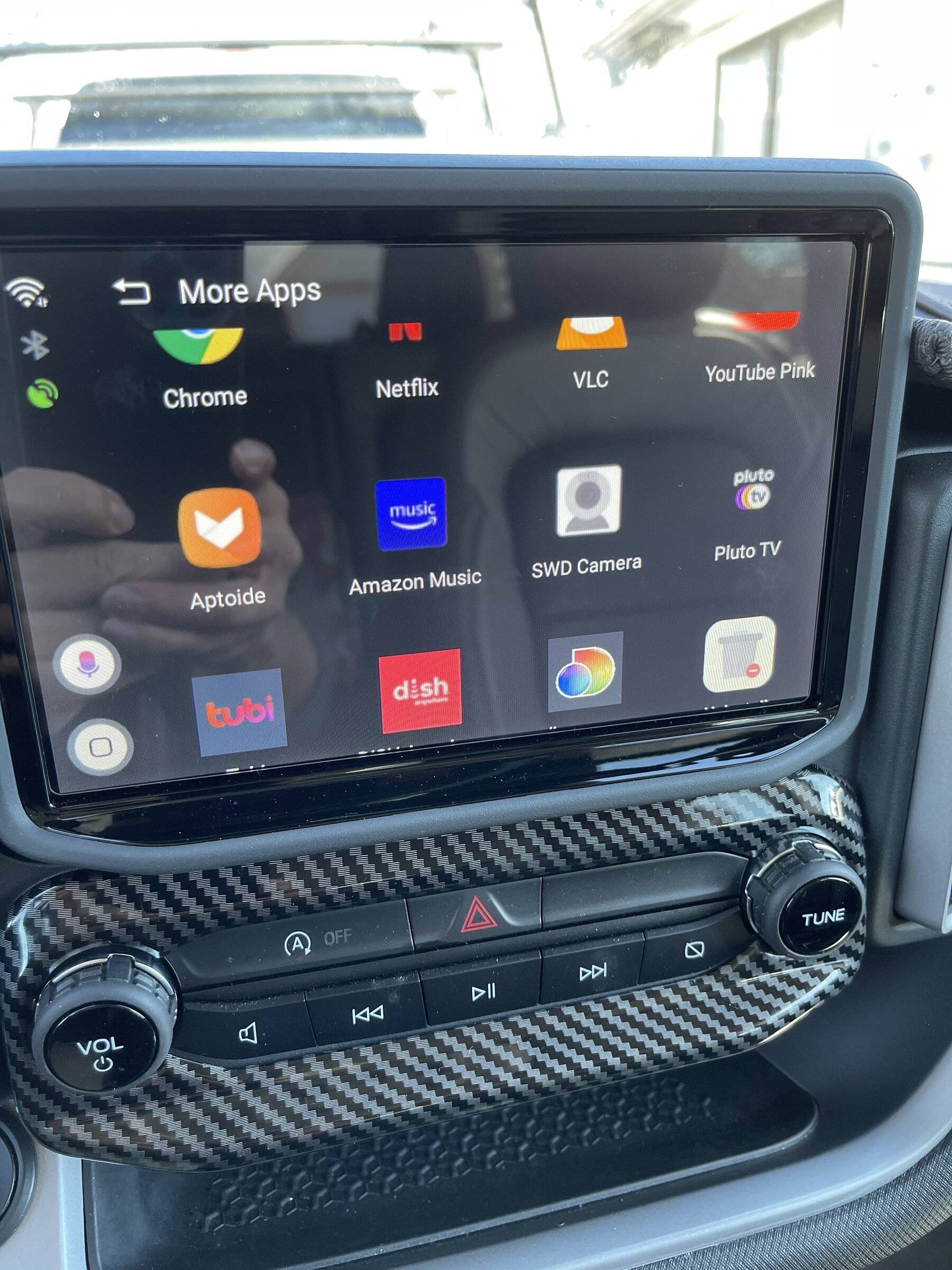

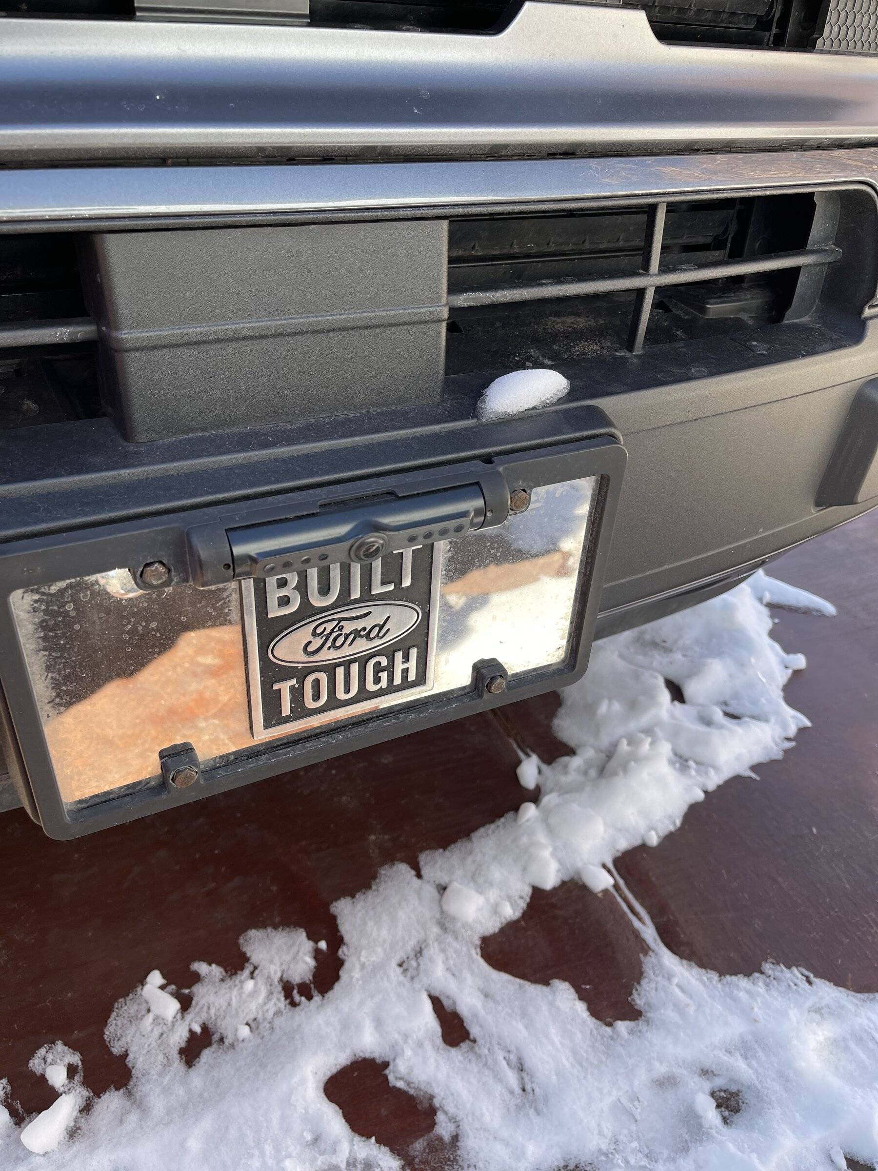

I did mine, it’s WiFi the issue was getting it on the screen. I found a module that plugs into where you’re phone plugs in and allows you to down load any app from the google play store. So it mirrors on the screen through WiFi. It works good wired it with a remote control to turn it on or off.

Here are pic on screen
Ford Bronco Sport Can a front 180 degree camera be added to an OB? 6E63F43A-FDD9-4E67-8F36-14F8D7829989
Ford Bronco Sport Can a front 180 degree camera be added to an OB? D47B0110-DDE0-4CE3-A743-F823903BBF80
Here is the module and remote
Ford Bronco Sport Can a front 180 degree camera be added to an OB? EF805E8D-042C-4A79-B921-267A41B4222C
Ford Bronco Sport Can a front 180 degree camera be added to an OB? 42DBA557-DDF7-4207-AA1B-B452AA33B79A
Im a bit a confused with how each component works together - could you provide a link to each product instead of a screenshot, and be a little more detailed in your install process?
