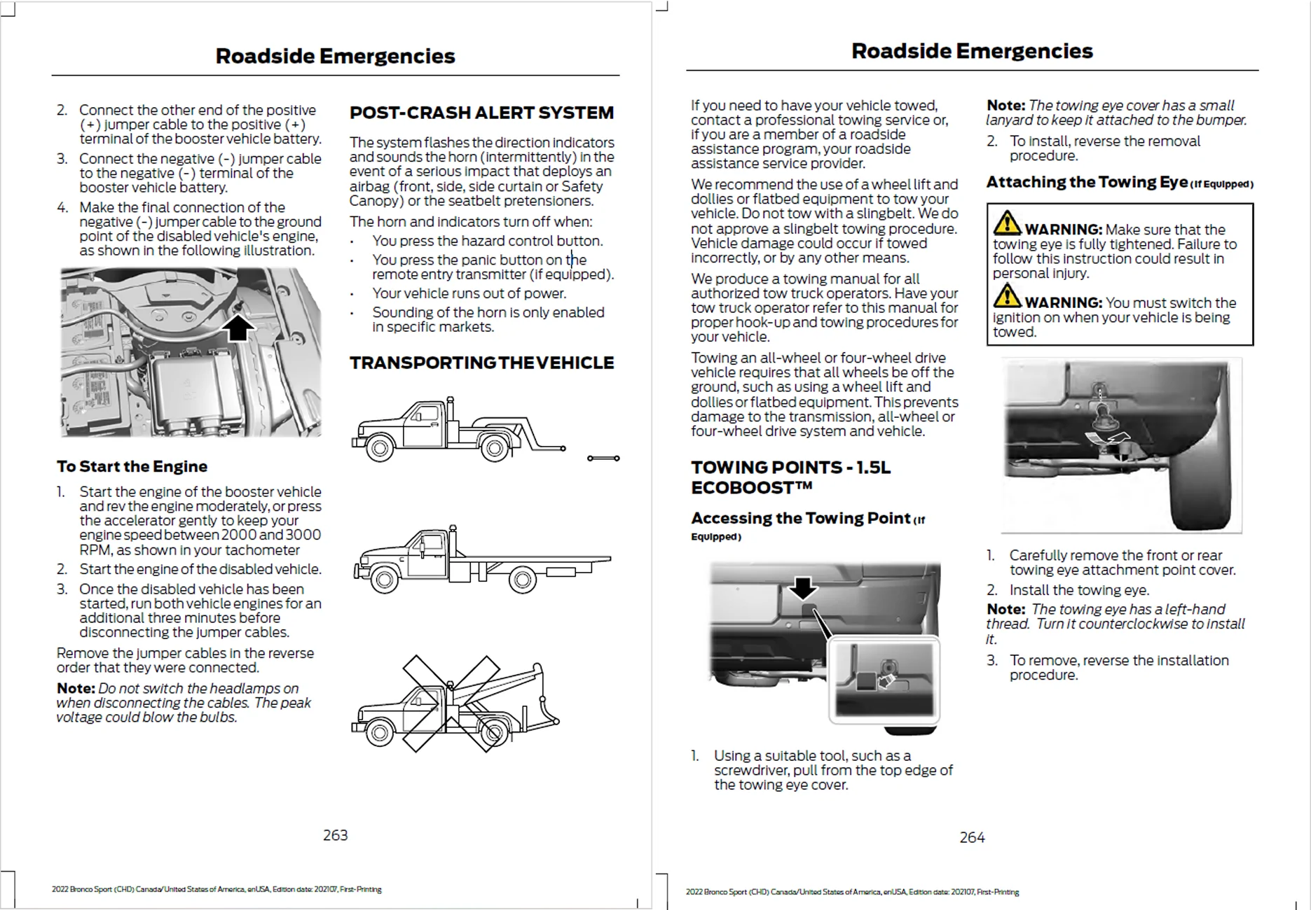

I am new to the Bronco sport heritage ,I would like to know if ther is a front spot that you can tow from.I don’t want to modify anything on the truck because it’s my wife’s vehicle and she don’t want anything done but I think I need to know if per chance it has to go on a rollback or be towed out of a ditch or something like that . Ant help would be appreciated!

From the 2022 Owners Manual:
Ford Bronco Sport Front towing Bronco sport Picture1
Cheers!

If it's got recovery points on the bumper, that's your first choice. other than that, most tow operators will hook lower A-arms or similar for winching up.
From the 2025 owner's manual:
If you are using recovery points, I would suggest a long, properly rated bridle to distribute the load on the unibody.
