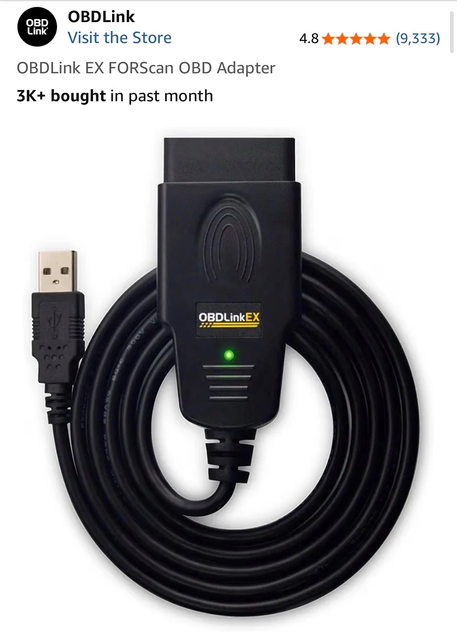

I want to use the FORSCAN system on my new 2025 Bronco Sport Heritage.
I’ve never used or had FORSCAN.
I know I need the FORSCAN software.
But I don’t understand or know what hardware I need to buy
Help please.

That's the same one I use and have for years. Just FYI: This one is not on FORScan's list of officially supported devices any more. The only one they vouch for on their site now is the OBDLink:
https://www.amazon.com/OBDLink-EX-FORScan-OBD-Adapter/dp/B081VQVD3F/ref=sr_1_7?crid=FGXYMU3JQKU5&dib=eyJ2IjoiMSJ9.tc9-PyIOqqUxKU4f8hwUdV0RzYMviZyzvprck1P10HRxCZ4cckHgpzXjN1_SZs2QeY_J6L4z2xb1R891NrdSmTXZGvk2XO0JKgDByiZRzGNohFXZOzDrAcYG6vThwj-lkxbADJ3cEZAlo3PiLe1YZx2xbURM0ogtDO-SP9UndUUO23Anou1fCZ593OIKaGTL2OgiDLr0c42vEsKzRk7E1MqXzxnAUIPr1jyNpTwuldAKMnvNYlU87ZlqbjLH4fpkhN-t_PxzThjqJJ8xHV_uQqlYiDqwRjLWWqhf4iaad2g.EcaiW4-Fl9JMm5DMF7n5e8VV4j0pFfl0IPcbLH5vjRU&dib_tag=se&keywords=forscan+cable&qid=1761236079&sprefix=forscan+cable,aps,124&sr=8-7
With that said: I still use my VLinker with zero issues and I use FORScan for a lot of things most people don't even know you can do with it. I can vouch for the same cable you recommended.
@tekoontz All you need is a cable and a license from FORScan to use their software. A 2 month license is free, and a 1-year license is $20 and gives you access to be able to use FORScan beta for advanced module programming procedures.

I also have the officially supported OBDLink Adapter… $50 a couple years ago now listed at $70, the camel says it’s been as low at $60 in the past year
