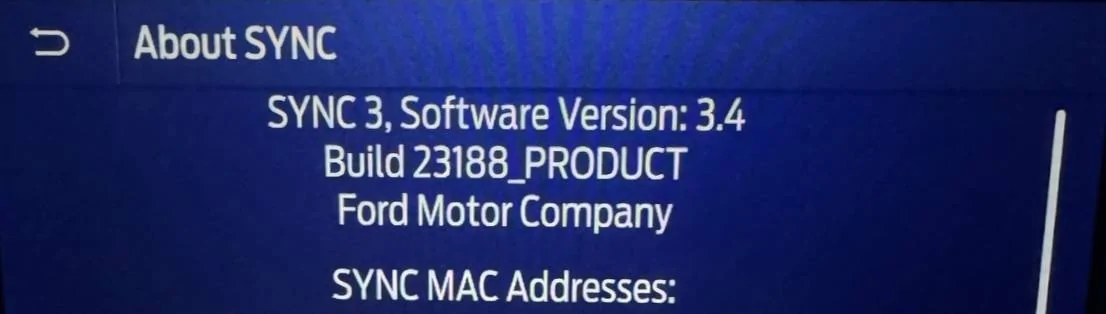

All ‘21-‘24 Bronco Sports are Sync 3, you need the specific version -
called Build xxxxx_PRODUCT
here is how to find it:
To find your Sync 3.4 Build Version (do not scan for updates):
Select SETTINGS tab, then
Select GENERAL tab, then
Select ABOUT SYNC tab
It will show the Build Version

Current Build of SYNC 3.4 is 23188
Is this what you have installed?
Please check all of the above and respond back.

Yes, iOS 18.4.1
Yes, FordPass Connect 5.17.1
I’ll check the current build of SYNC when I go out to the car later this morning.

The good news as you said in Post #1 is FordPass App is working fine now and you also have iOS, FordPass App and Sync at their latest versions
