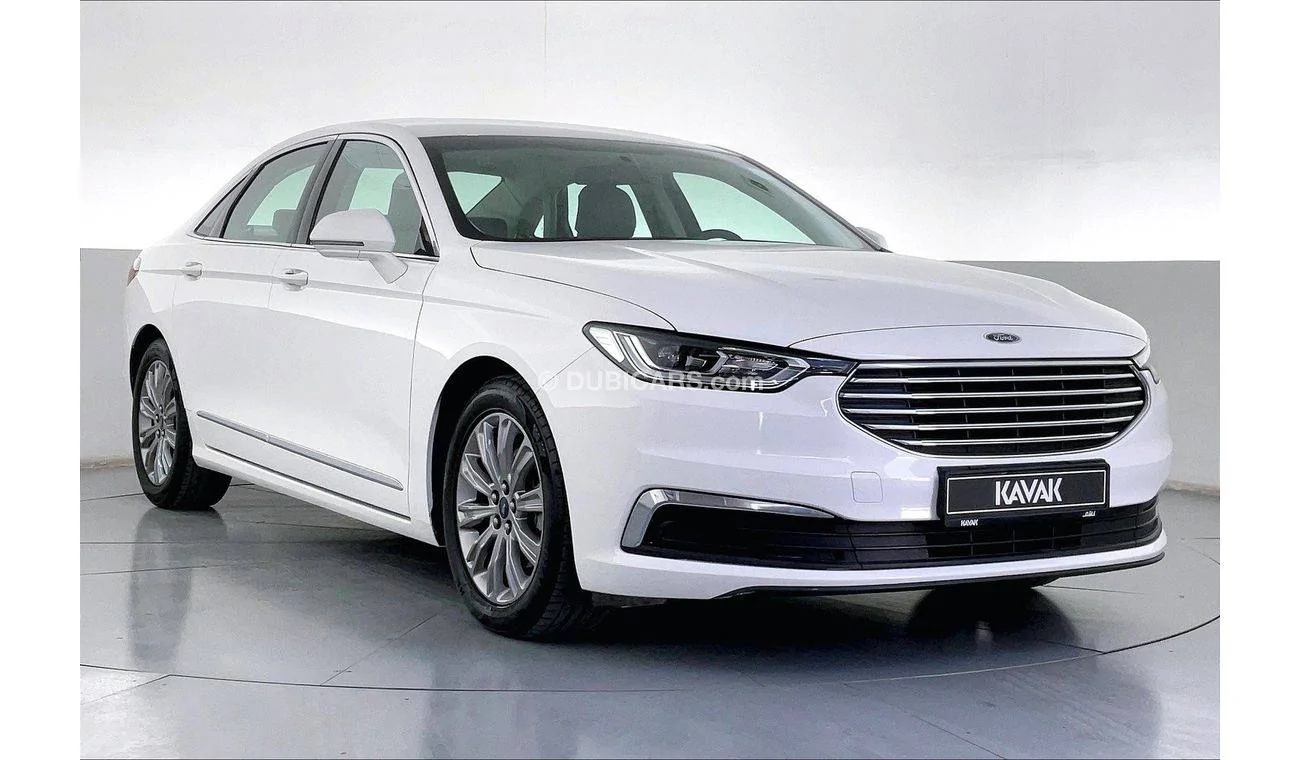

Here in Saudi Arabia we have all models of ford Taurus, it’s made by Changan so it might have a different name where you live, here is a reference picture of the model from the internet
Anyways, you skipped the whole point? It’s a helpful post btw.
