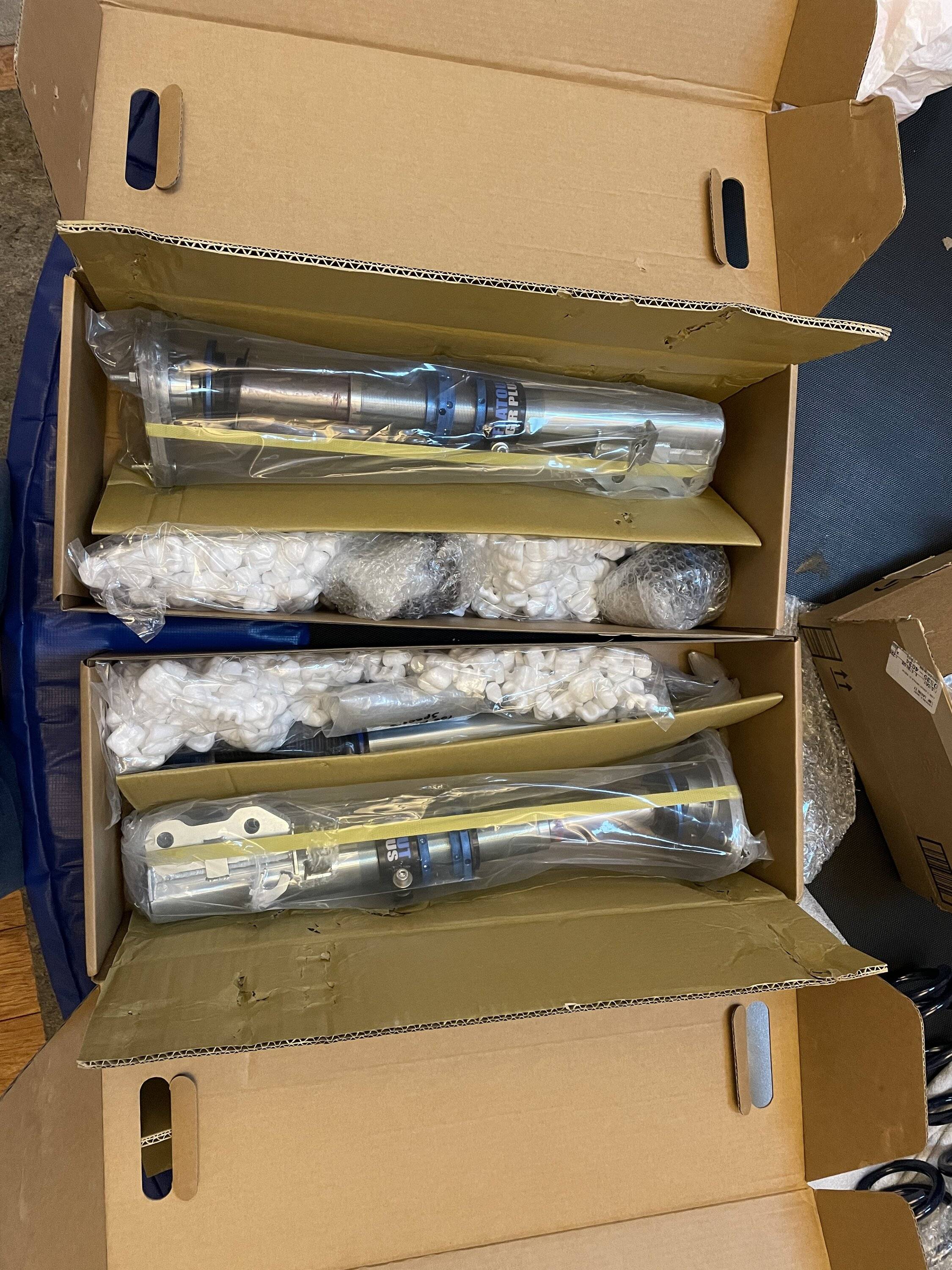

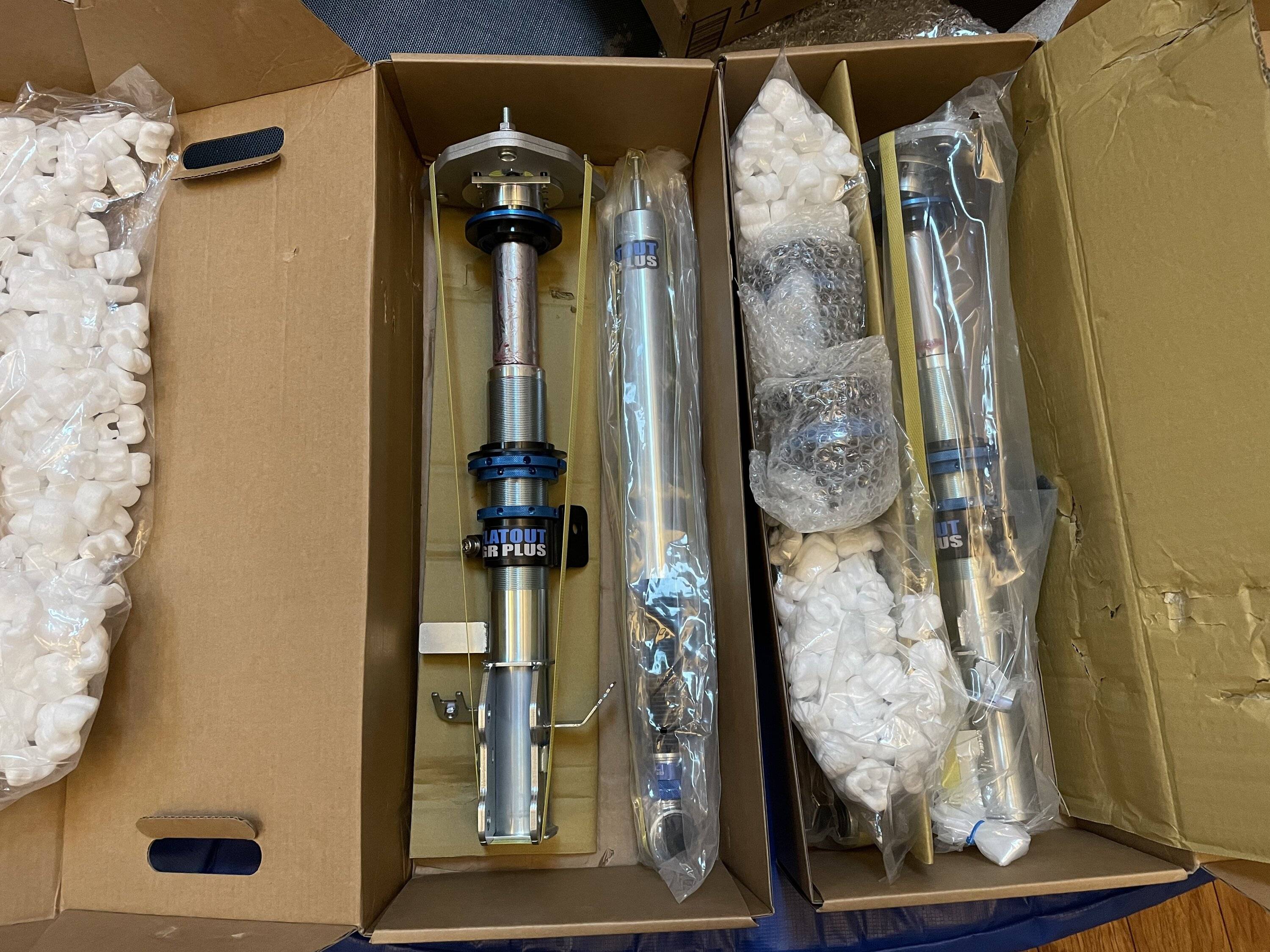

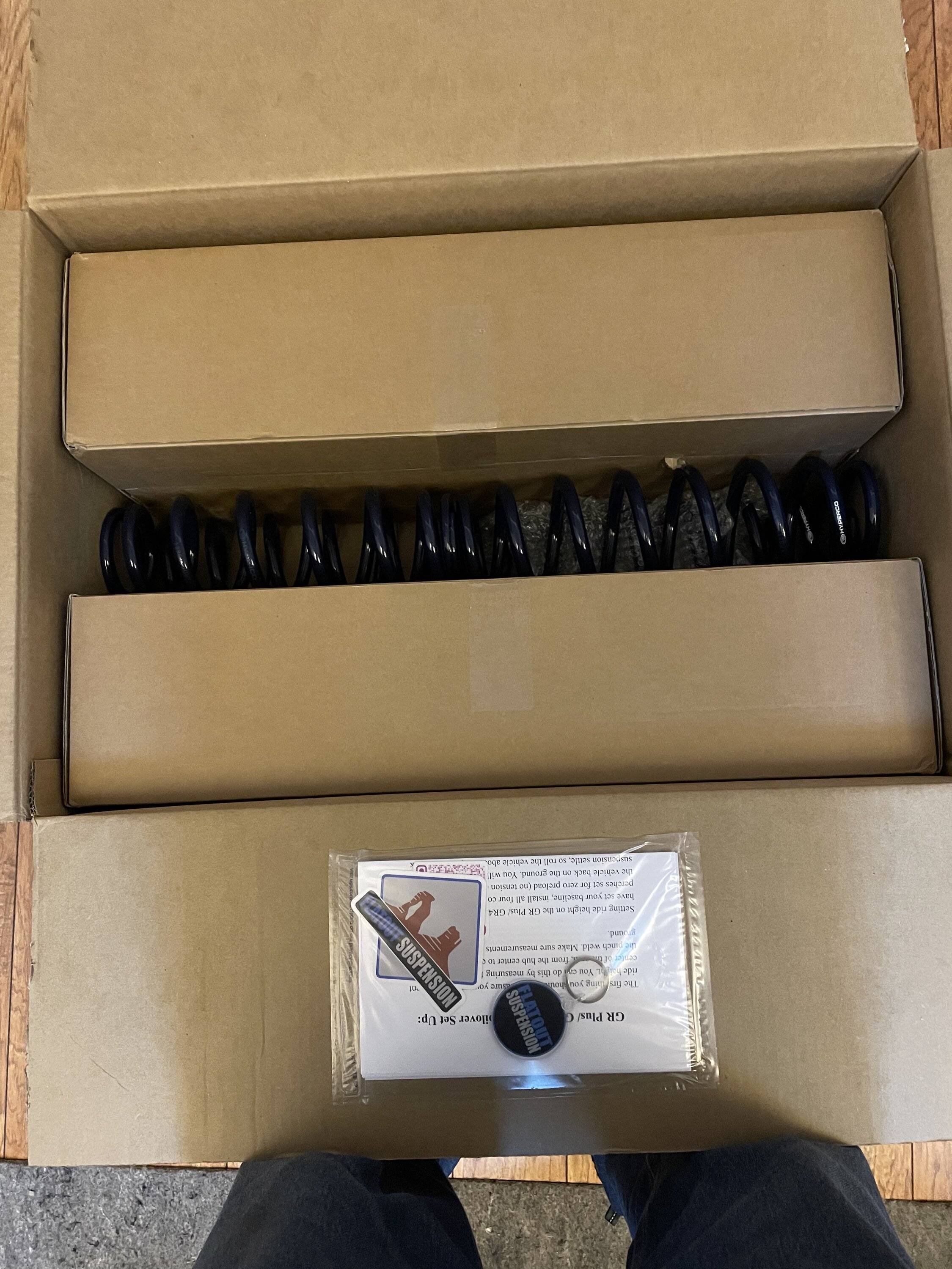

I took delivery of my clovers today! They were well packaged and the boxes were undamaged by UPS. Two minor glitches, that I guess we’ll get straight shortly and they are, The coil overs Were delivered with the camber plates and not the OEM style top mounts, I had specified. The second glitch was the adjustable end links were not in the box.
On a positive note, Flatout let me spec my own Springs and after some discussion with Them. I decided to go with a 14 inch 212 pound hyperco front spring and a 250 pound 12 inch rear spring. I had told them all along that I was not in a hurry to get them on, as I wanted to put some miles on the OEM suspension and go to the bronco sport off rodeo in New Hampshire before I put them on.

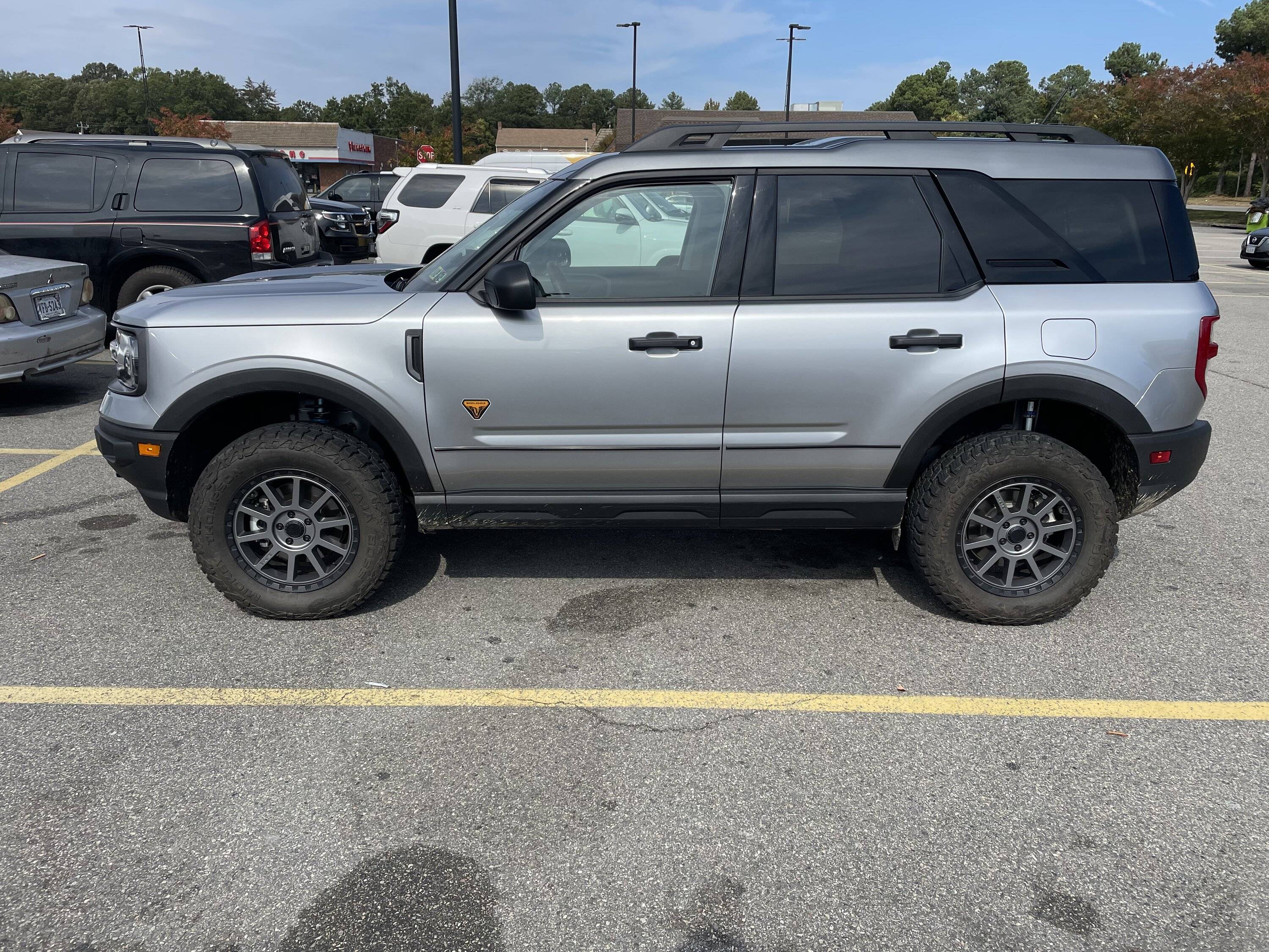

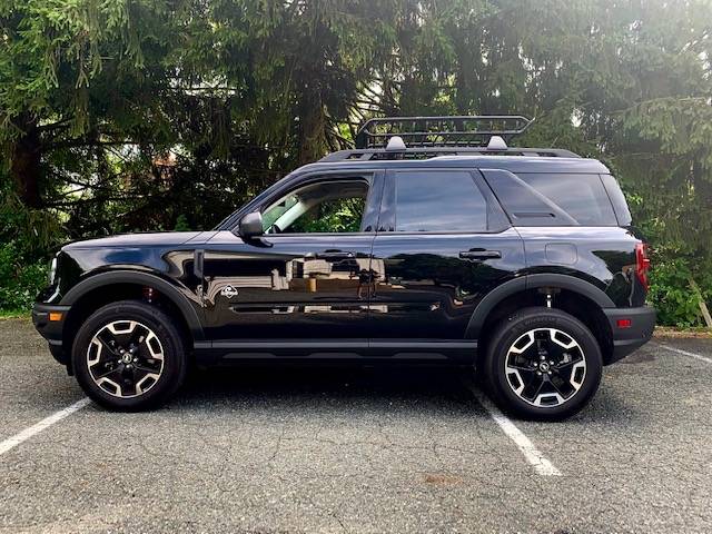

If you can, try to get a side profile picture of before and after.
I have this if it helps; before, lifted, lifted with wheels and tires..
Ford Bronco Sport FlatOut Suspension ordered & Installed CE43E052-1630-4EEA-8DAE-B75628E54A27
Ford Bronco Sport FlatOut Suspension ordered & Installed 8F668695-FC2F-4EFF-B3E8-7F63B3DD0D31
Ford Bronco Sport FlatOut Suspension ordered & Installed 7FDF0C8A-2A7D-4EB7-8860-FAFC922AC4B2
(Ride height at +1.5”, kept the 3/4” rake and chose not to level it)

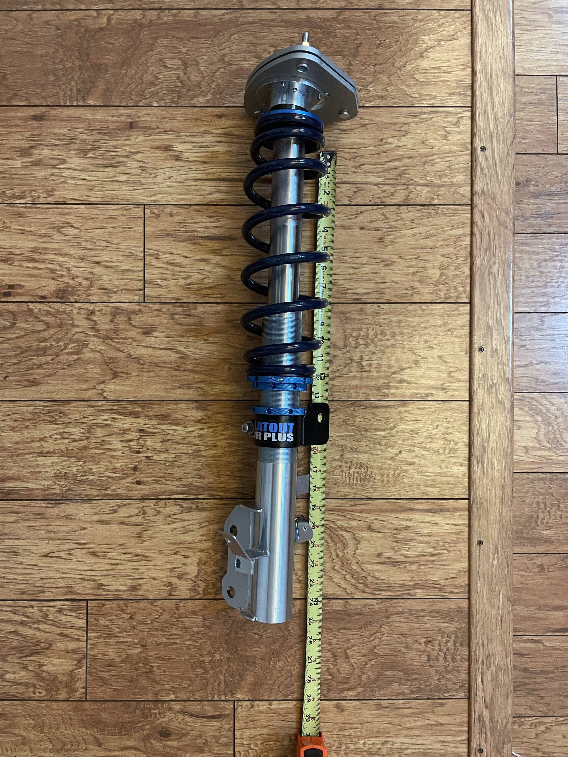

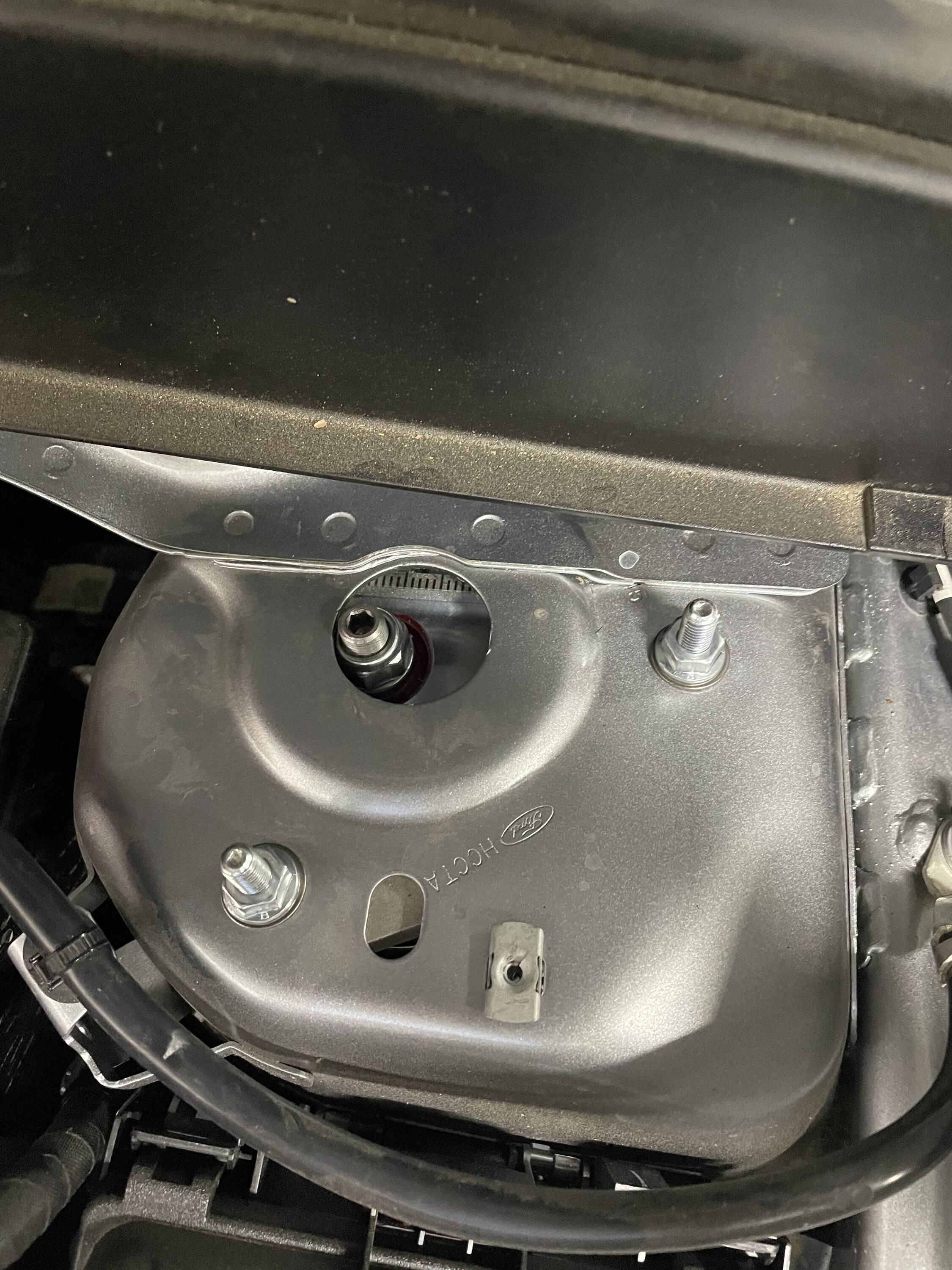

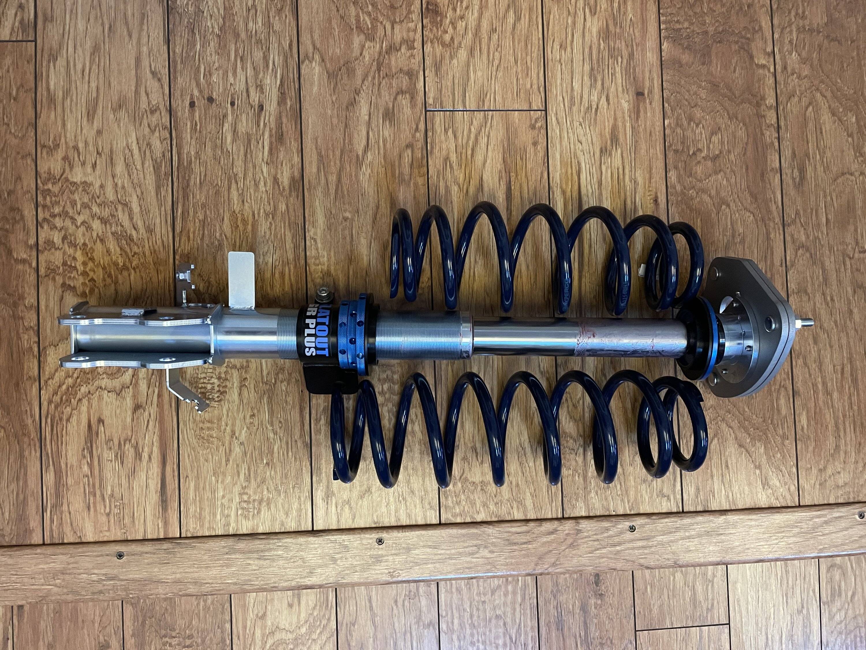

After a recent talk with Flatout and while I am waiting for the endlinks, oem style top mount and the addition of the camber links, I just ordered, I decided to take some measurements, of the fully extended struts. Extended, there is 8.25" of piston exposed. Now I can see the possibility that the piston may extend into the strut body by 1/4" or that it doesn't go all the way in, so, lets say it has 8.25" of travel +/- .25" of travel. Flatout claims it has 2" more travel than the OEM struts, which has 7.44" of travel. Flatout says the OEM bump/rebound stops are very long and I'm assuming both companies are measuring travel to the fully compressed stops. So, I'm theorizing, that if the Flatout indeed has 2" more travel, it must have a shorter internal bump stop, which means the spring rate will ramp up faster, than the OEM, once the bump stop is engaged.
In the first pic I show the fully extended strut with both the 14" and 12" springs, I ordered. The adjustable end link mount, which Flatout says is randomly placed, during assembly, sits 3/4" higher than it's lowest possibly position and the bottom of the locknut for the spring perch sits just over 3/4" higher, than the end link mount with no preload on the 12" spring. 2nd pic, This leaves 3.25" of space before coil bind would impact travel. Eibach's 12" 200lbs spring has a stack height of 3.28", Hyperco's 3.15" and Swift's 2.8", which I find somewhat suspicious but who knows.
Assuming the link mount is in it's exact final location (an Unknown), the 14" springs I bought for the front, instead of the standard 12", will need to be compressed 1.375" to fit that space. Which means my 212lbs springs will be applying a 291.5lbs preload, at the minimum and that my 9.8" of travel springs will be reduced to, at most, 8.425". which would seem to me to be perfect. The only possible issue, I see, is what will that 291.5lbs of preload do to my ride height? Any spring will need some preload and I haven't heard if Flatout has a recommended minimum but preload is also the only way to adjust ride height, on the GR+. More preload = higher ride height.
Flatout said they thought I'd have to compress my 14's about 1" and that the minimum bump in ride ht would still be 1". I'm planning on 1.5-2.0.
As a side note, in my spring research, I found spring availability of Hyperco's very limited at this time and that was partly my reasons for getting 212lbs fronts and 250lbs rears. I'd probably have gotten the 275lbs 12" rears, had they been available. Eibach's were somewhat more available but don't offer as many rate choices and both are basically the same $ if you were to buy them separately at $97 & $95 each and, pre-Covid, could be found discounted, from their suppliers. An equally good choice for springs are Swift's but they do cost more and I'm unsure of their availability. But in my recent research I found that in their 12" Barrel springs, they consistently beat both other springs, travel wise. As Flatout is specing 12" 200lbs front and 12" 250lbs rears, as their "Comfort springs" Here are the specs for, in order, Eibach's 8.72" & 8.34", Hyperco's 8.85" & 8.36", Swift's 9.2" & 8.8". I doubt if any other springs, offer the travel of any of these three and many will sag quicker and more. If specing front springs you may want to ask yourself how much preload will you need to get to your desired ride height and if that will impact your available travel?

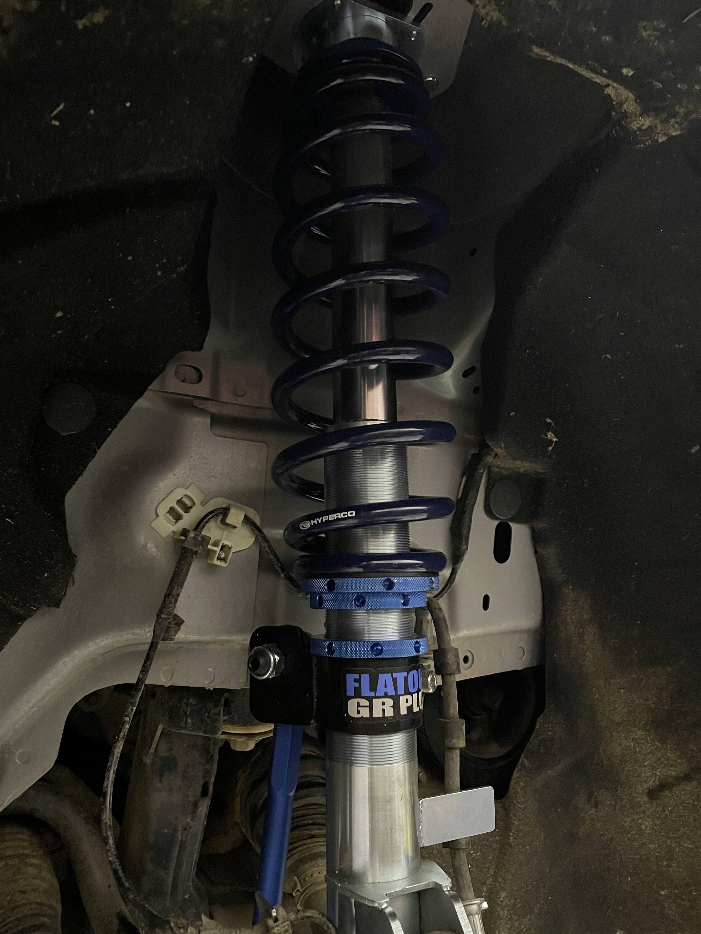

Update. Now that my Flatout GR+ coilovers are installed, I thought an update was due. I got what is considered the "Comfort" spring rates. The reasons for that are I don't think I need the Overload springs and I hadn't yet measured the OEM Spring rates but now that I have I have two recommendations. Based on my measurements and a spring rate calculator,
IF you have a Badlands, get a Barrel shaped 14" front spring (Hyperco does not call theirs Barrel but instead (UHT) Ultra High Travel) with a rate of 200-225lbs. Near as I've been able to measure and calculate the OEM front spring is 11- 12", 160lbs spring. There is no reason not to get a 14" spring and it's increased travel should more closely match the Flatout's increased travel(?). The OEM rears are 13" and 250lbs, yet Flatout specs a 12" comfort spring of 250lbs. In my mind this doesn't match up well to their front springs. To the best of my knowledge no one makes an aftermarket 13" spring and a 14" spring might be possible with some added installation difficulties and you kept the rate at 250-275 but with High quality Barrel springs a 12" spring offers a little more travel than the OEM 13's and a 14" spring would probably mean a minimum of a 2" rear lift. I recommend a 12" rear spring with a rate of more than 50lbs higher than the fronts. Unlike most of history, spring availability is an issue, now days. That's why I ended up with a Hyperco 14" front Barrel, 212lb spring and a 12" 250lb rear spring. I did not want Eibach's Red Barrel springs, though I consider them of ~ equal quality. The only other springs I would rate in their same quality and travel range are the Swift Barrel springs which may be a little more available.
You can mix brands front and rear to get what you want and I f you don't like red springs, at least they don't show in Back. So a combination of 200lb front and a 275 rear, I'd consider a good comfort setup but also 212/275 or 225/300.
I installed mine with the camber plates and have some micro vibrations that can be felt through the steering wheel as well as a minor increase in noise, that my Mickey Thompson Baja Boss A/T's drown out at speeds higher than 40mph, though the same tires may be why I'm noticing the vibrations and they were on the car, with no issue, before the coilovers. Flatout's OEM style top mounts would probably eliminate both minor problems but with my 1.625" lift and the camber plates, I was able to get -.6* to -.8* of negative camber, in front, without the use of the supplied 14mm camber bolts, which both my mechanic and I hate and that's right in the middle of the OEM camber range.
In the rear, I opted to buy the camber arms, which did not come with my GR+ coilovers, when I bought them but do come with the GR 40's and I'm glad I did and highly recommend them for anything more than a minimum lift. The GR 40's are a bargain, on sale! I also purchased a 1" sub frame drop kit, from FordRangerLifts.com because they were on sale and much cheaper than Flatout's 1.5" but in comparing the two, Flatout's have a number of advantages and I'd recommend them for any lift > my 1.625".
I am very happy with the way the car rides and have my first off road weekend, with the Coilovers, starting tomorrow.
Pics of camber plate set to max negative, front struts set to 1.625" height increase with my 14" springs and car with 1.625 F and 1" rear. I gave my guy the wrong rear height and need to go back again to get it changed.
