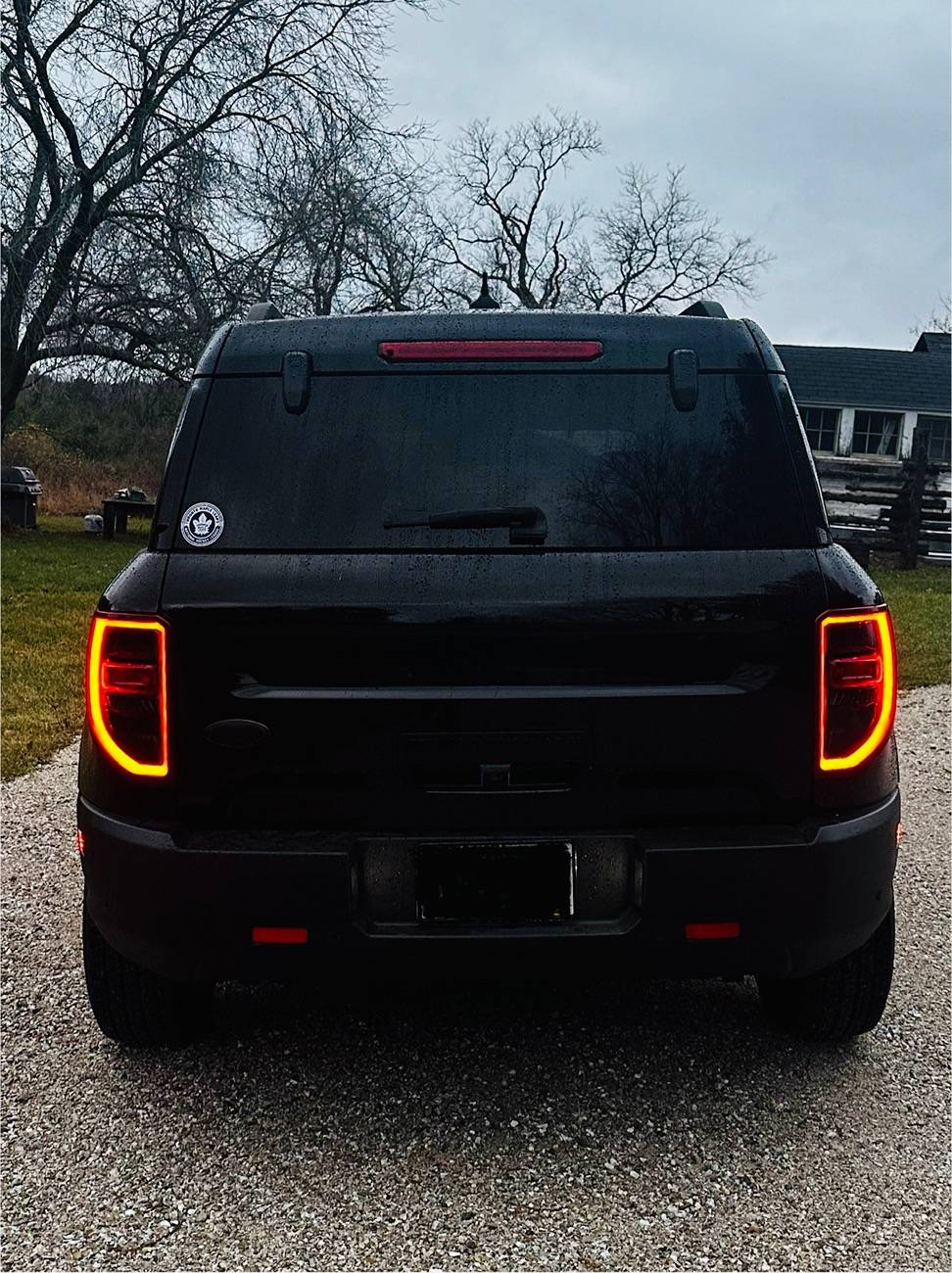

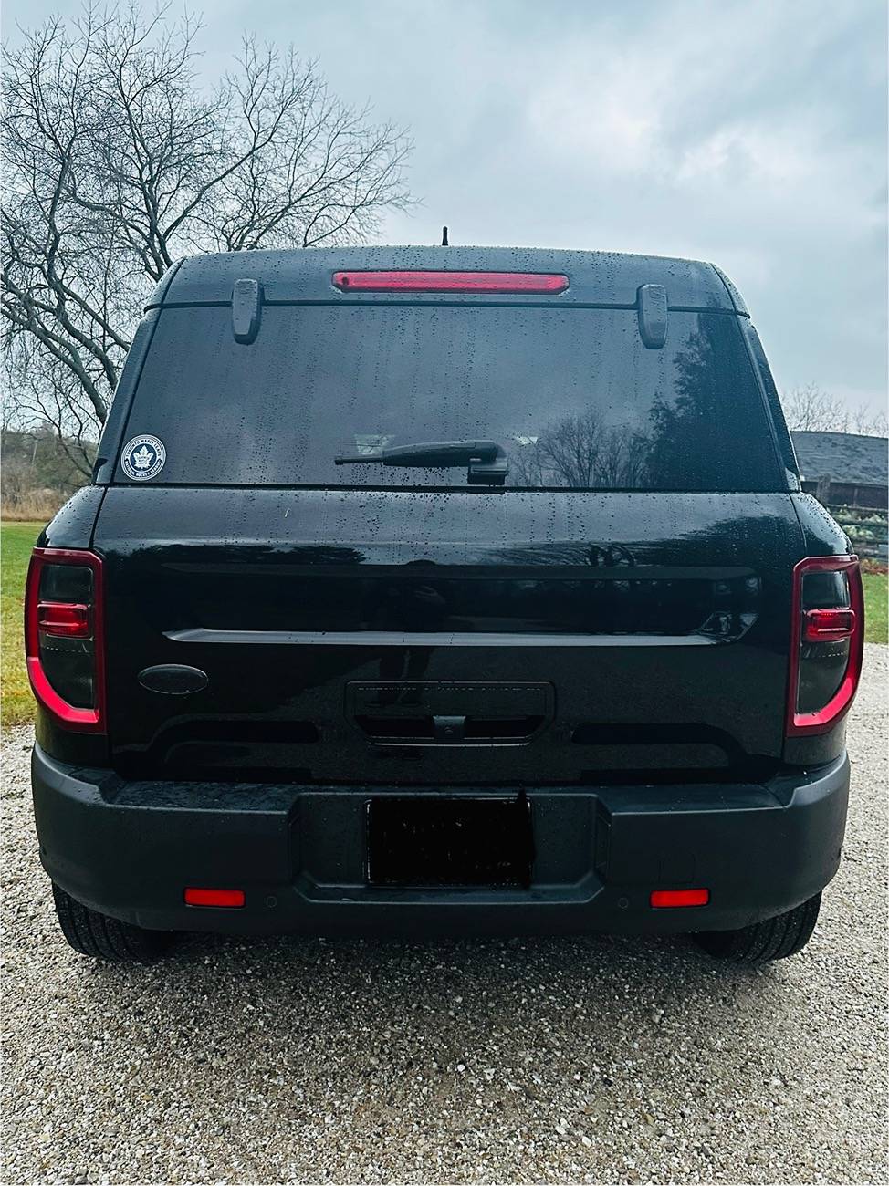

Really like how this turned out and it was easier than I thought. I got precuts from sticker fab. I’m going to attempt to apply vinyl to the windows this week. Any advice? I’m worried about running into issues tucking it in at the bottom.

“CheetahTint Performance Series Automotive Window Tint” which I believe is a vinyl film?
maybe vinyl. never heard of them though. when i hear vinyl i think paint protection film not window tint.
my tips would be clean window thoroughly with squeegee as final step. have a mix water with like a drop of dawn dish soap or Johnson's baby shampoo in a spray bottle ready and mist window and your film. start at the top edge and work your way down. obviously start with window like halfway down to get to the top edge. you can put a microfiber towel over your squeegee to not scratch film as you apply.
i would watch some you tube videos.
