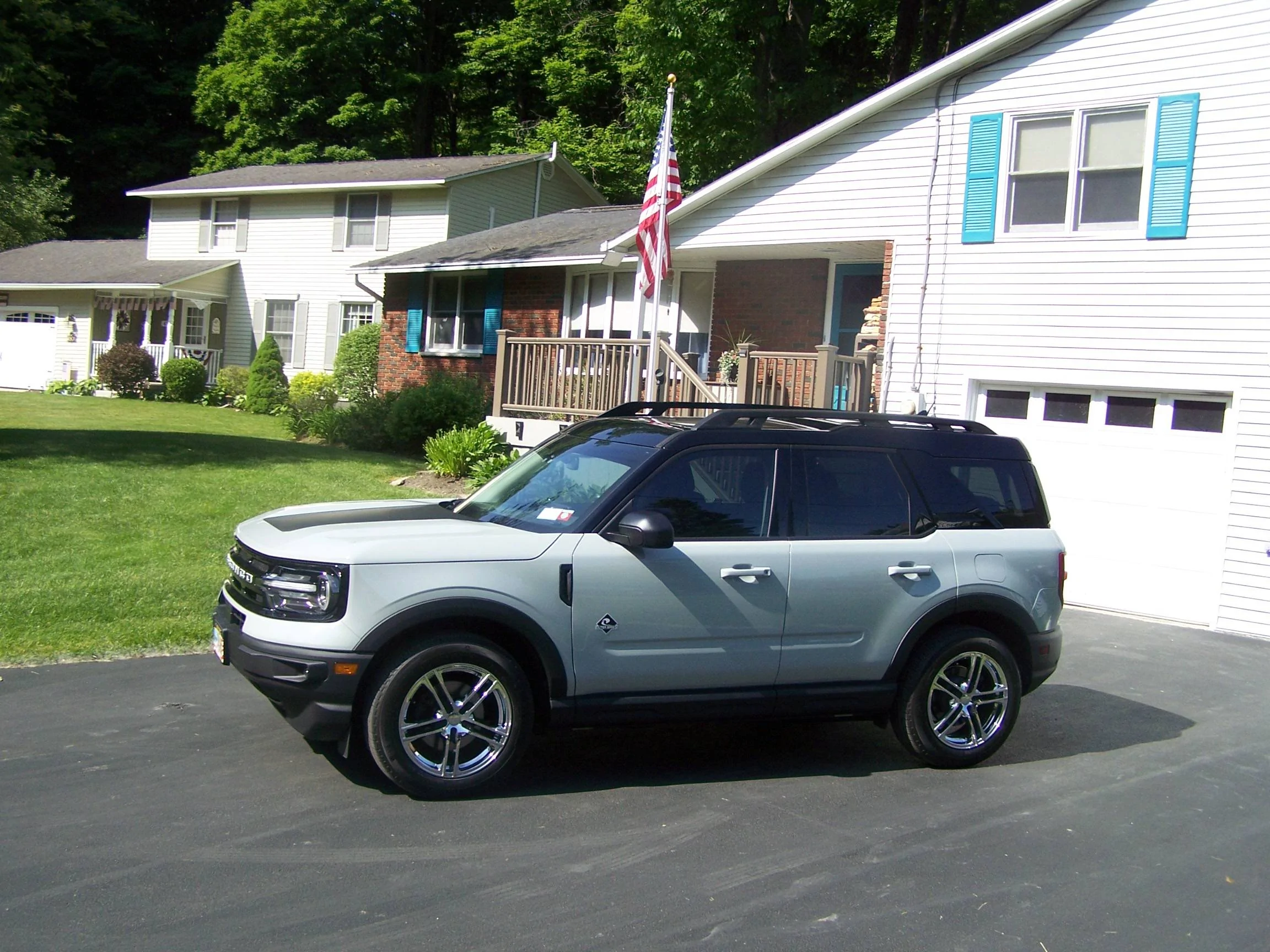

I've got my Verde chrome mags mounted on the factory tires off my '23 OBX for summer use. I bought these wheels for my '14 Escape Titanium. Since then, I've used them on a '17 Lincoln MKC, and a '19 Ford Edge. The bolt pattern is common for many different models. Don't limit yourself to strictly Bronco Sport wheels. You have other options.
