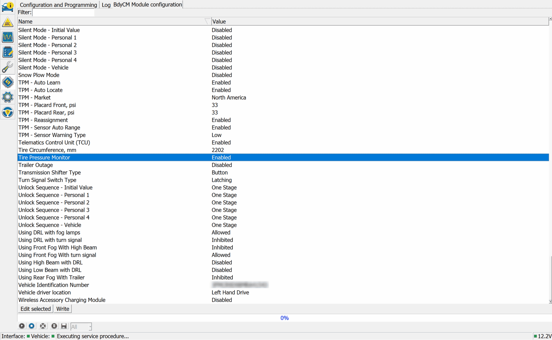

So checked this morning and for what it is worth, the ability to adjust the TPMS settings are available in the latest version of FORScan. It would be accessible via the BCM module:
Ford Bronco Sport Disable TPMS? Screenshot (62)
Personally, I'm still a fan of TPMS, but I know a lot of folks aren't and if you are comfortable making software modifications on your BS, it could be changed.
