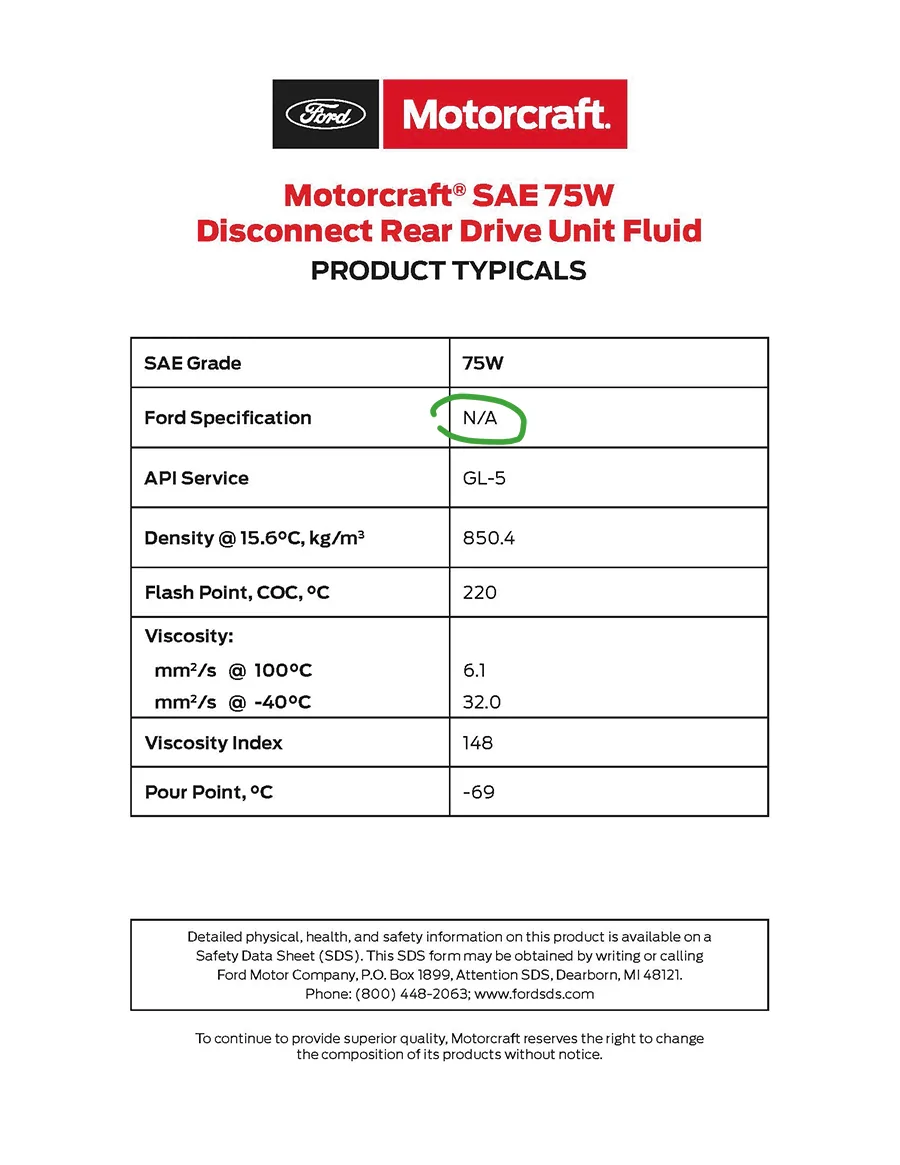

Ford also has not assigned any standard to this oil that third-party manufacturers could use as a reference:
Ford Bronco Sport Differential Oil (VERY CONFUSED!!!) Product Data Sheet SAE 75W Disconnect Rear Drive Unit Fluid_2
I've seen vague references to the "Dana lubricant" and have read that it is 75W just like the Motorcraft XY75W disconnect rear drive fluid. I wonder if it was developed with Ford.
I have not seen the Dana fluid being marketed.
