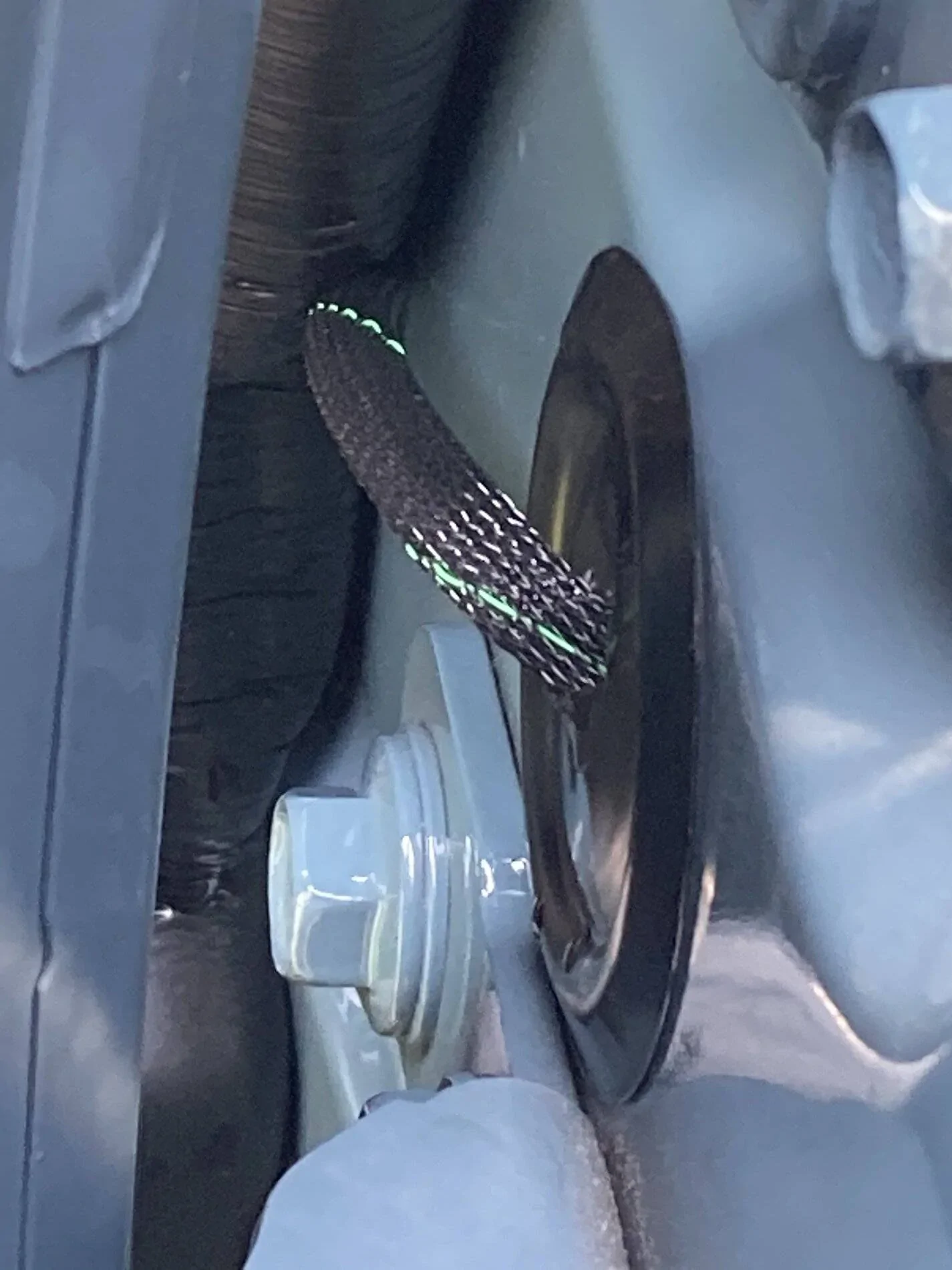

Quick easy spot I came across for wiring access from under hood to cabin area. Above driver side front door hinge. It goes right through to behind dash and wires drop easily to floor without any real fishin. ??

Is this going behind your weather stripping instead of through the firewall? ?‍♂

Just going through an existing hole they put there already had in place even with the rubber plug. The black looking stuff is the foam filled trash bags Ford used to fill the extremely larger void space. No weather stripping was harmed for this photo
