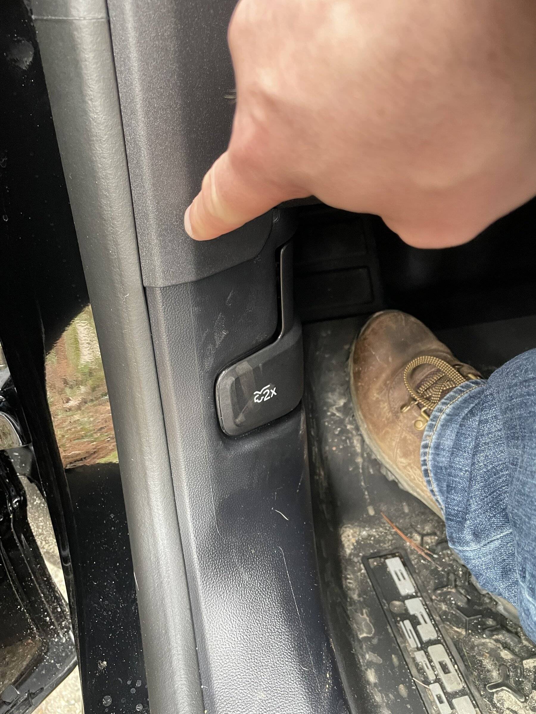

So I can stop the clicking of I push on the passenger a pillar, or reproduce it easily enough. Also found that these parts rattle easy since they don’t have a flush overlap. There’s one on both sides, this is drivers side. Open the doors and push tap on these. Even with the doors closed you can reproduce the sound. Is also right next to the speaker.

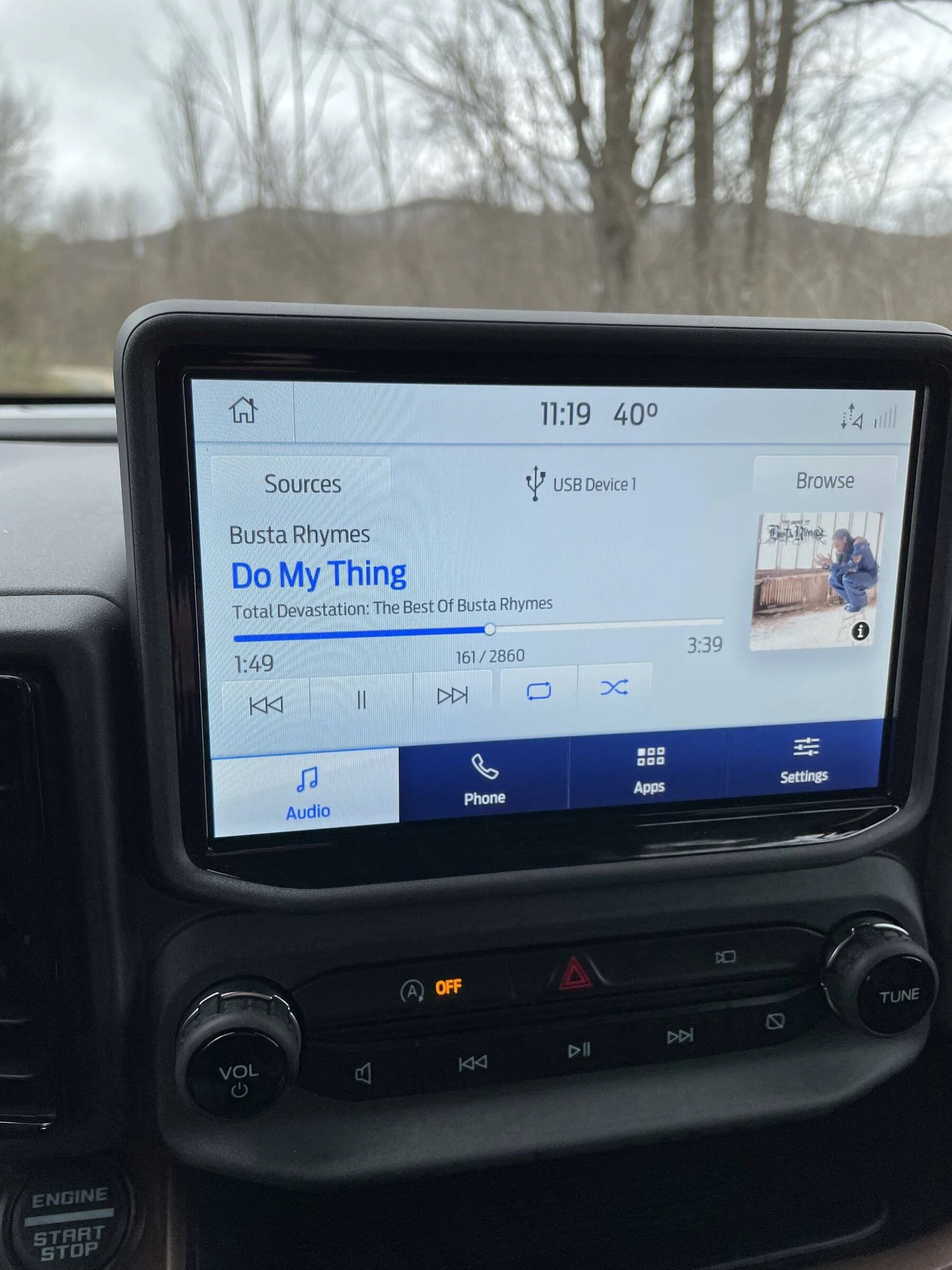

try this song even at 5 for volume. You hear it really bad with the bass frequency used. At least that’s what mine is coming from
