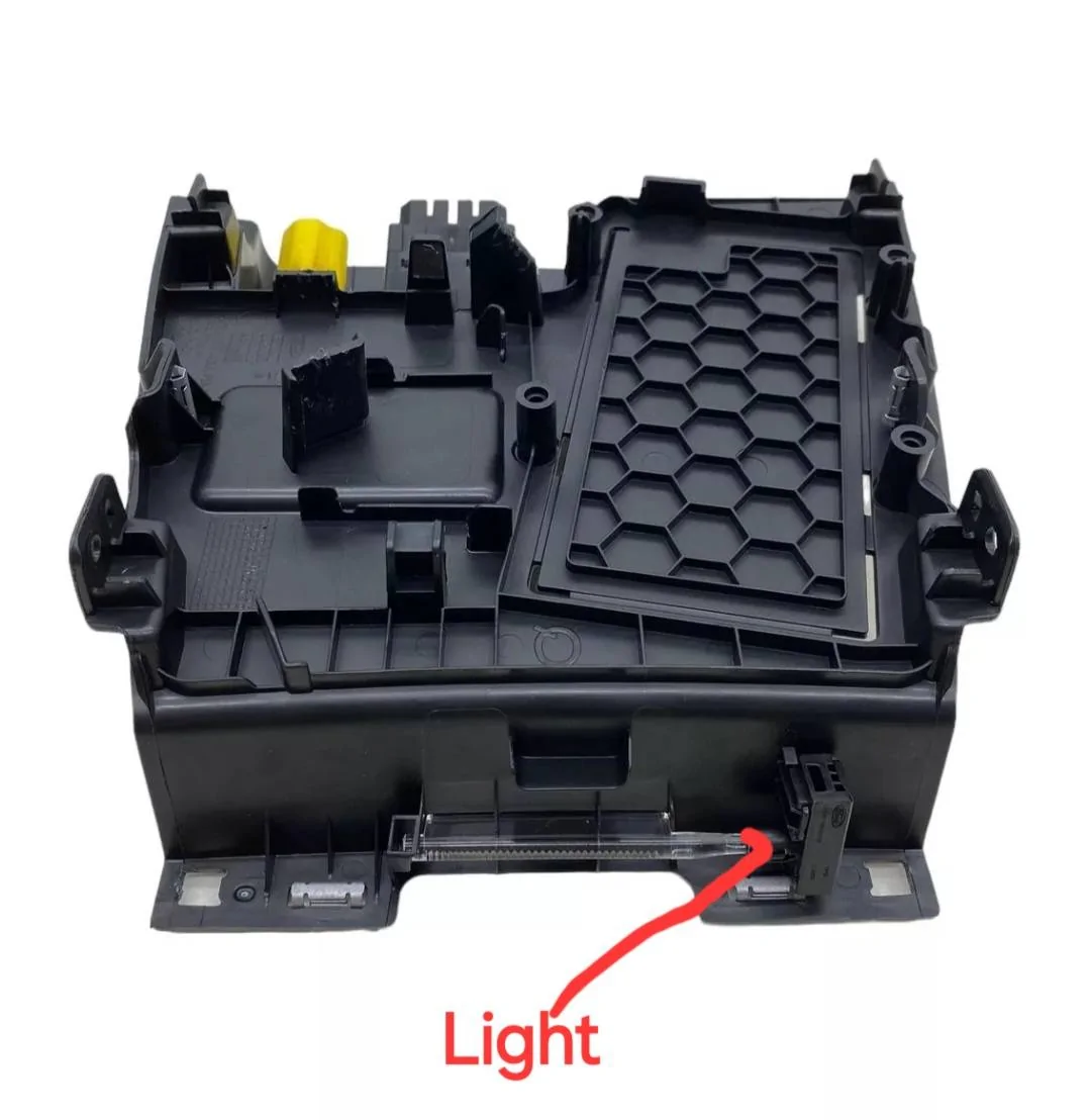

You just pick up a Ford Escape cupholder and wire it into your front foot area light. Check this forum, there are several good threads to do this. The charging tray area can be lit by several different options. One plugs in the USB port, or one plugs in the round 12-volt port. Here again look through the forum to find the threads.
if you have the Ambiant lighting already , you don't need to splice anything for the cupholder as the plug is already there. just for some reason they didn't put the lighted cupholder in, you can also use forscan to enable the color changing menu

Just an update to the cubby ambient light project, I installed it today it works fine, just have to see tomorrow morning how much it lights up the cubby area.
Also whilst I was in there, I decided to add a 12v outlet and a battery volt meter display.
Kinda happy with how it turned out, there is still plenty of room to charge my phone.
