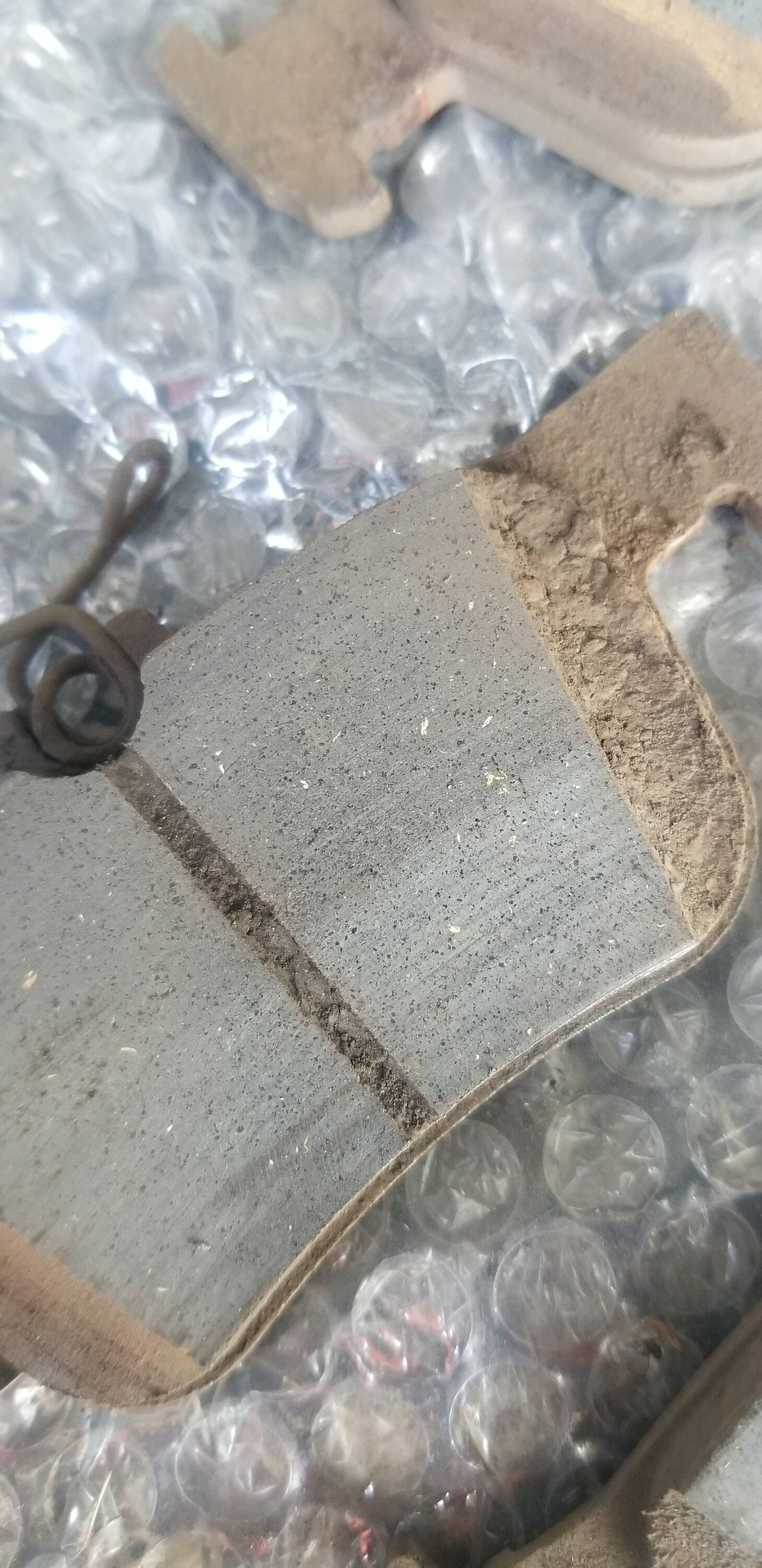

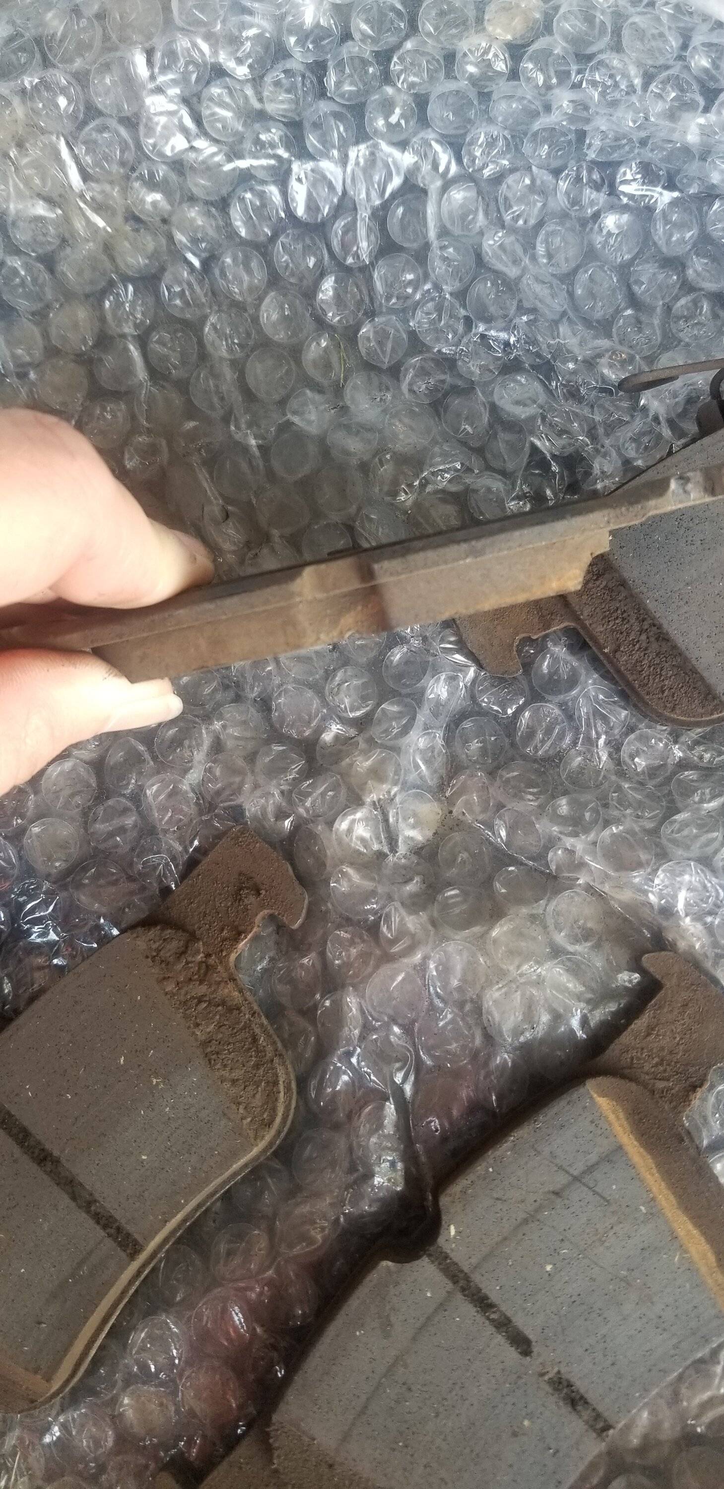

That would be worth spending an afternoon of work.
You did not resurface the rotors either, right?
I did not. They looked/felt good and were clean, no warp. The pads weren't as worn when I actually got them off. Apparently just shi++y material.
Like others said, make sure to put it in maintenance mode and don't lose the little plastic caps that cover the caliper slide pins. It was a 40 or 45 hex head... I can't remember exactly.
Do it. You'll be glad you did.

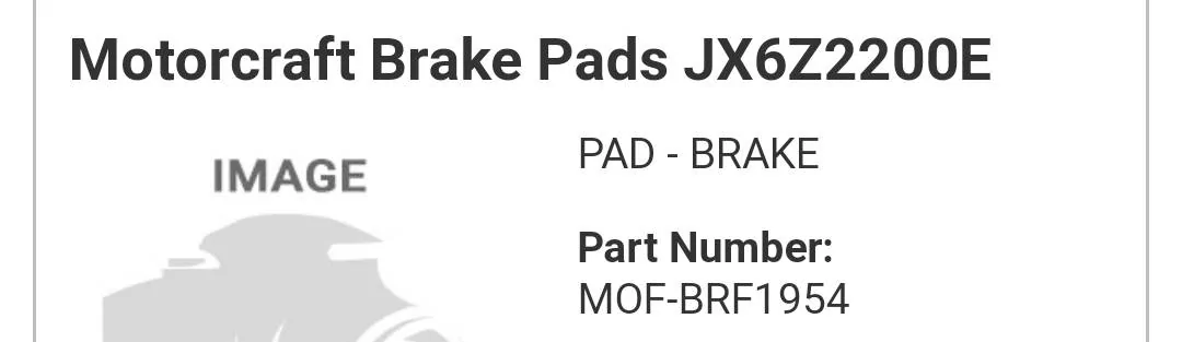

One last question and I'm good: what made you decide to go with the BRF1954/JX6Z2200D vs what Ford lists for these cars (potentially newer), JX6Z2200E?
I believe they are one in the same?

The FoMoCo. Couldn't find aftermarket. Rockauto had the best deal on them, ~30 bucks cheaper than Ford. BRF1954.
