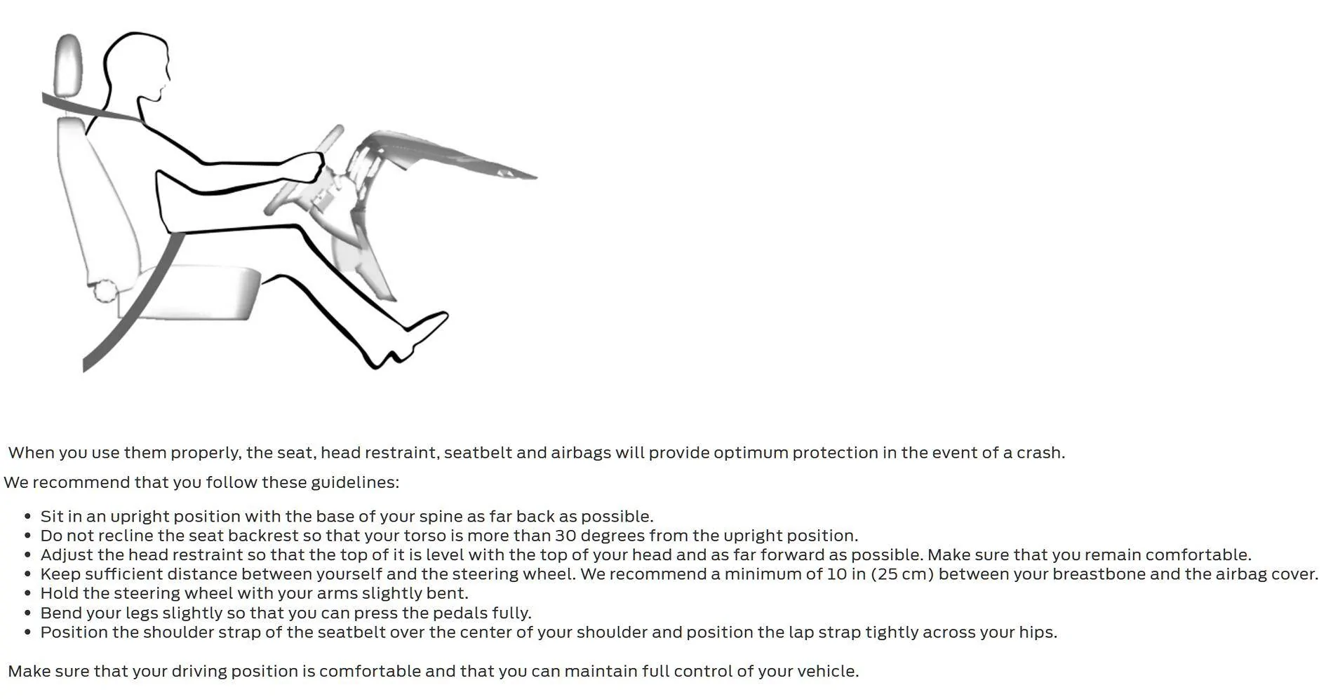

My wife is having issues touching the pedals and does not want to move the seat up to far because of the airbag. Has anyone had success in putting extensions on the pedals or have a site to purchase such a thing.
6,731
13,134

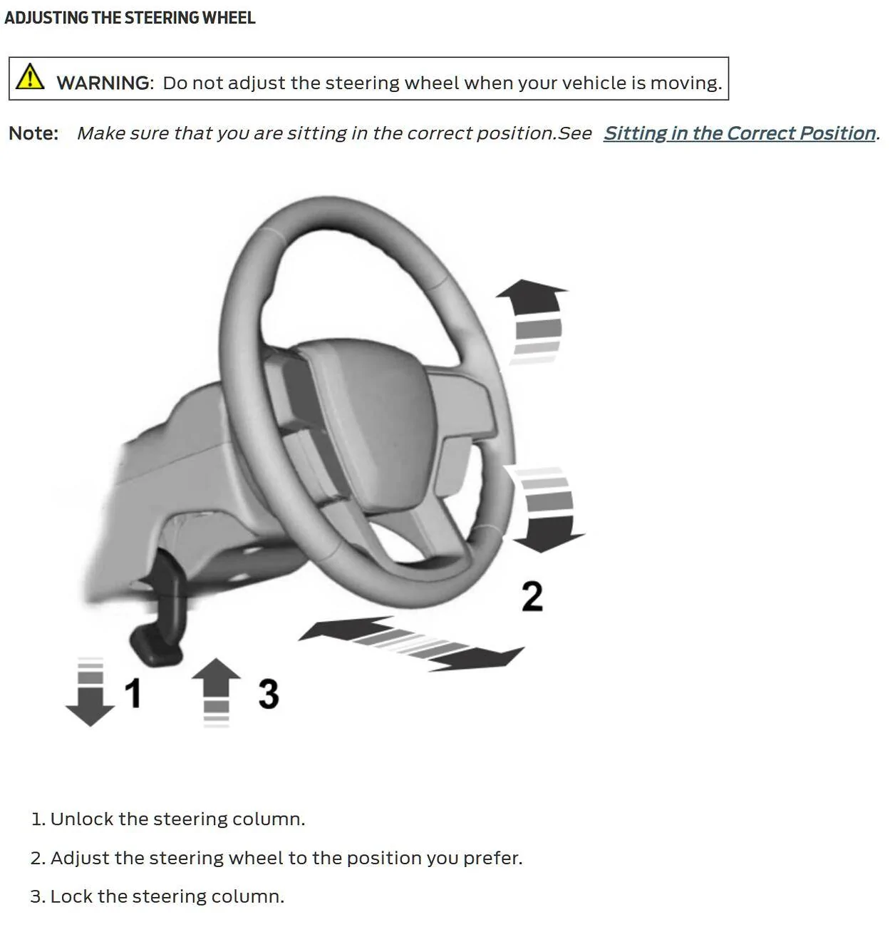

With modern airbags the NHTSA recommends a minimum of 10 inches from the airbag cover. Have you measured the distance with the seat positioned so she can reach the pedals? If you didn't know, the steering wheel also telescopes.
