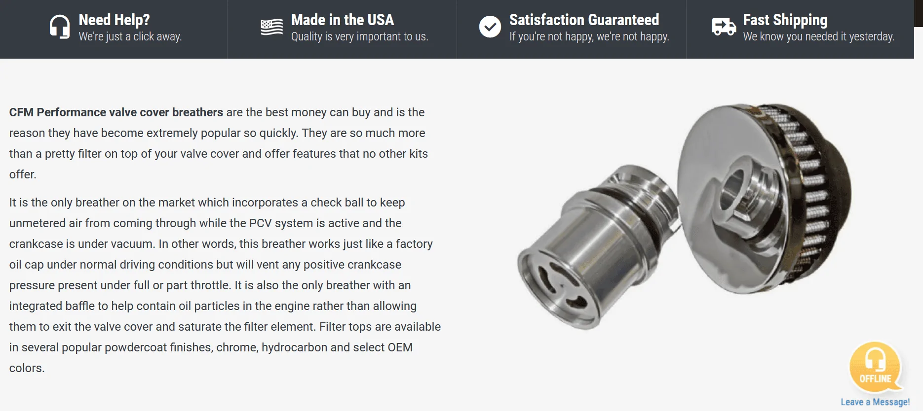

Curious about your routing and venting setup.
Modern engines benefit from intake vacuum on the PCV since negative crankcase pressure is beneficial.
Ford Bronco Sport Buschurs Maverick 2.0 catch can 1653403768292
PCV continues to operate as intended
ball check feature
only vents when vacuum ceases
blow-by pressures exceeding check resistance vent to atmosheric pressure
Dark
Apr 5, 2022
53
58
Northern VA
ball check feature
Ah, this isn't tied in to the PCV circuit at all but rather just a one way valve in place of the oil cap. Gotcha.
