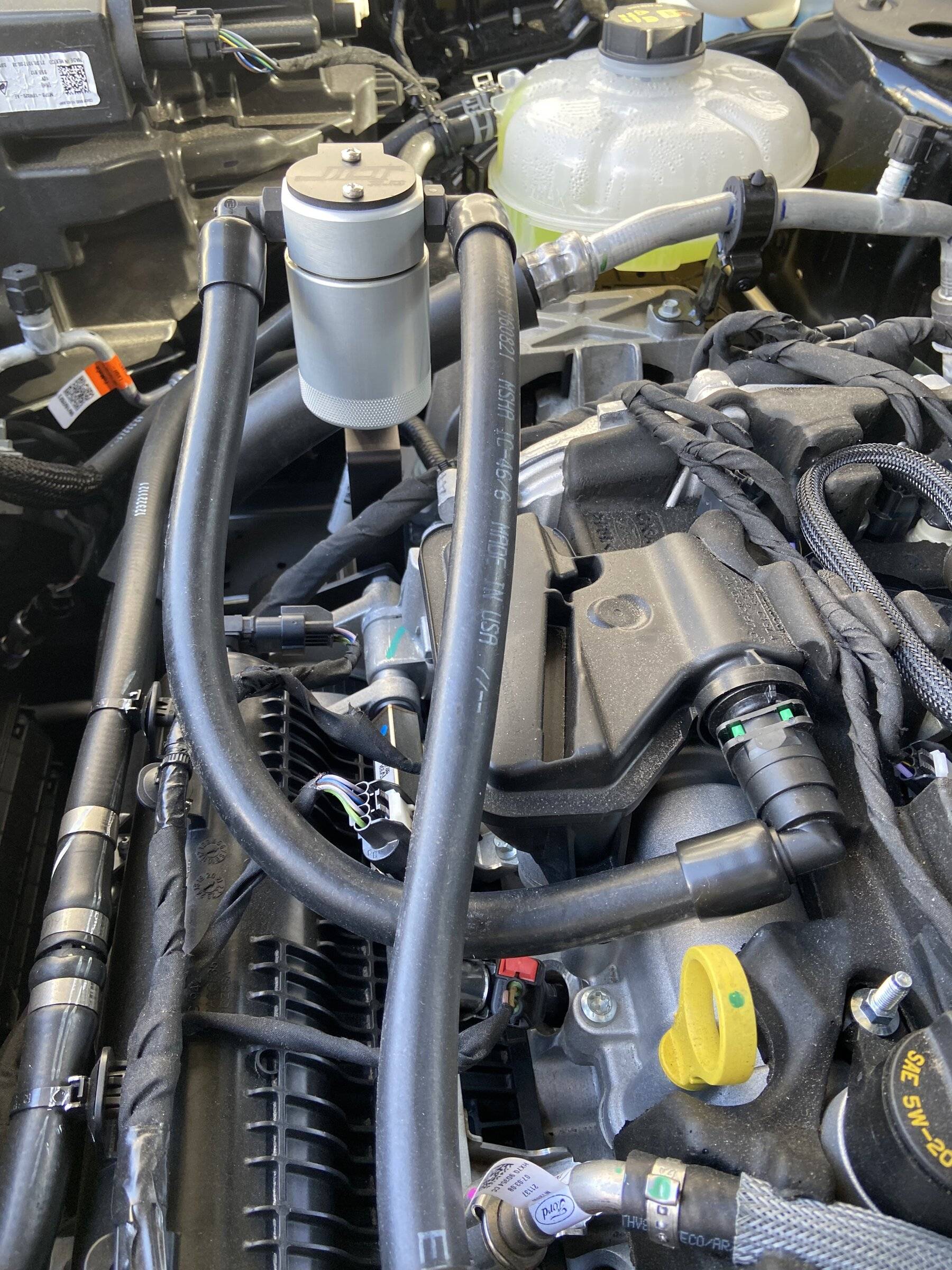

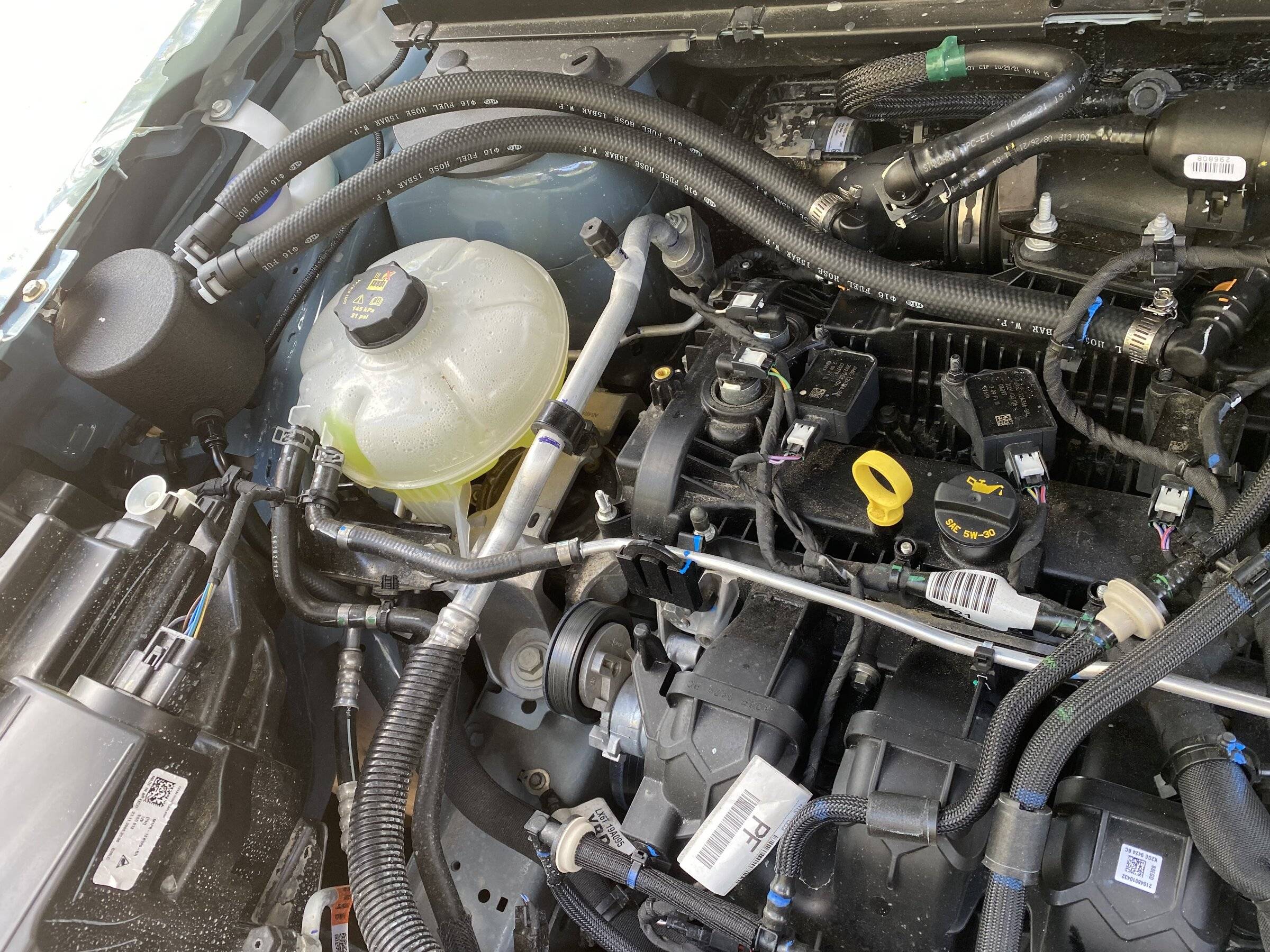

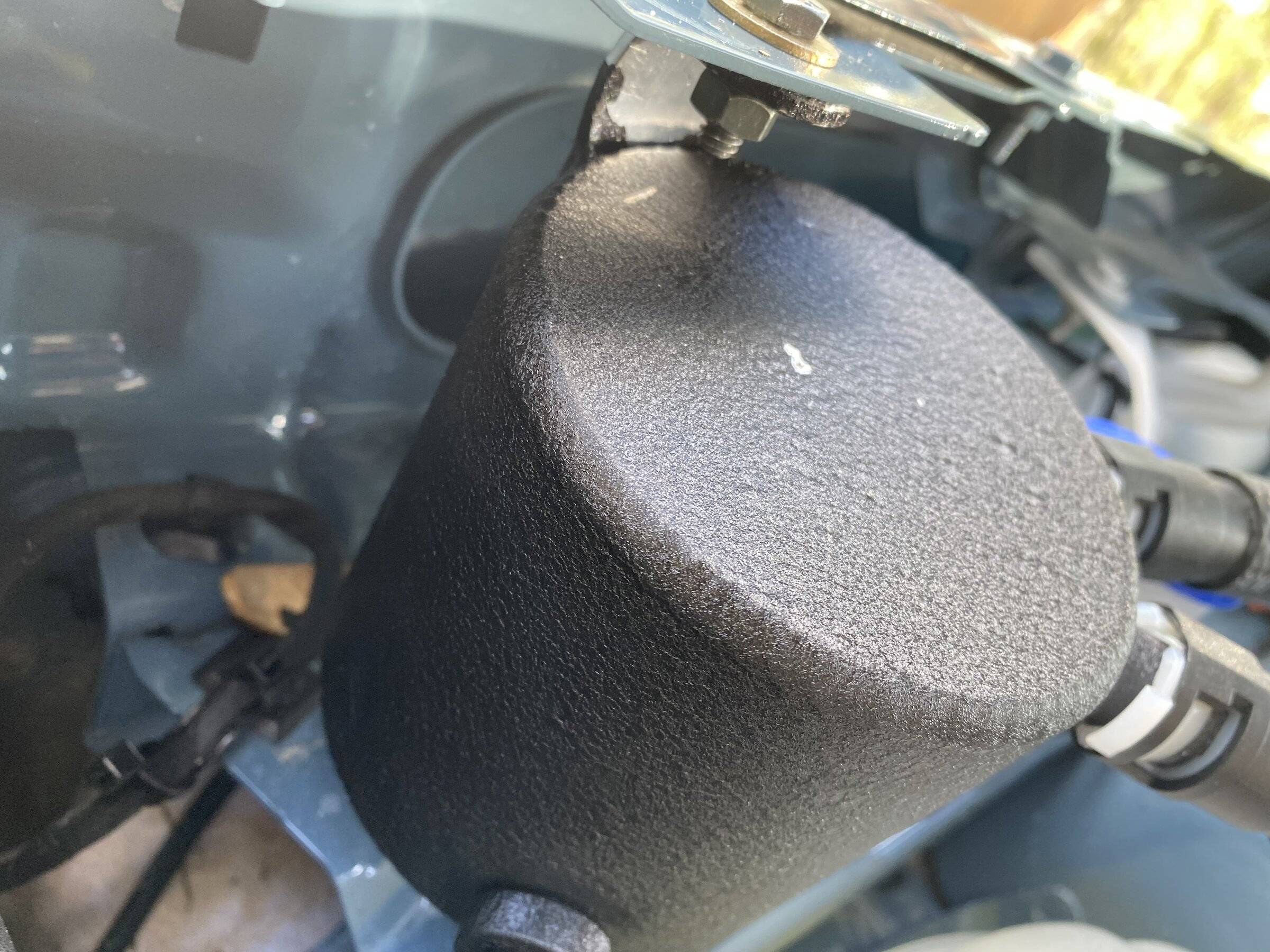

I installed a buschurs catch can for a maverick 2.0. As many of you know one of the major problems in direct injection is coking that happens in the heads. This will also prevent your intercooler from clogging because this system is pre turbo. There is another system on the pcv side to but that
Install was fairly easy just used a razor to slit the old hose off and slid new hoses on. The instructions say to use old fittings and slide the hoses right on but I installed hose clamps. The hoses were not tight without.
I did have to modify the the mount for the can. I just bent it flat and drilled a hole where u can see in picture. I imagine on the maverick the fenders are more angular and bronco is more boxy where it mounts.
I’ll give in update with what it catches in a few thousand miles.

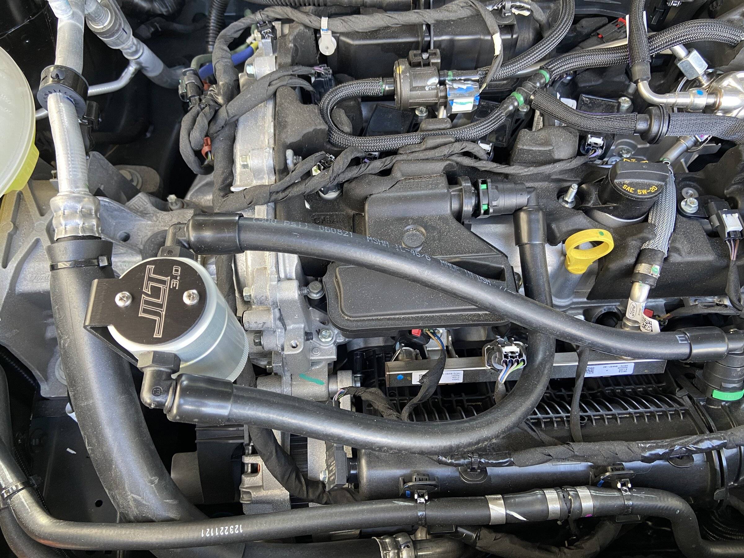

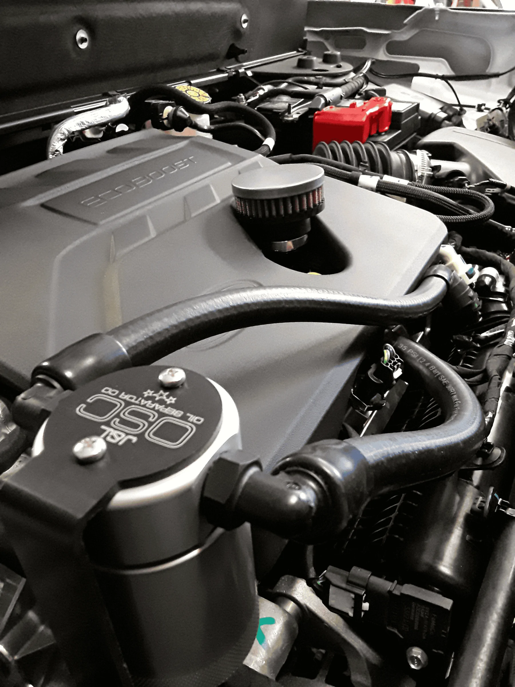

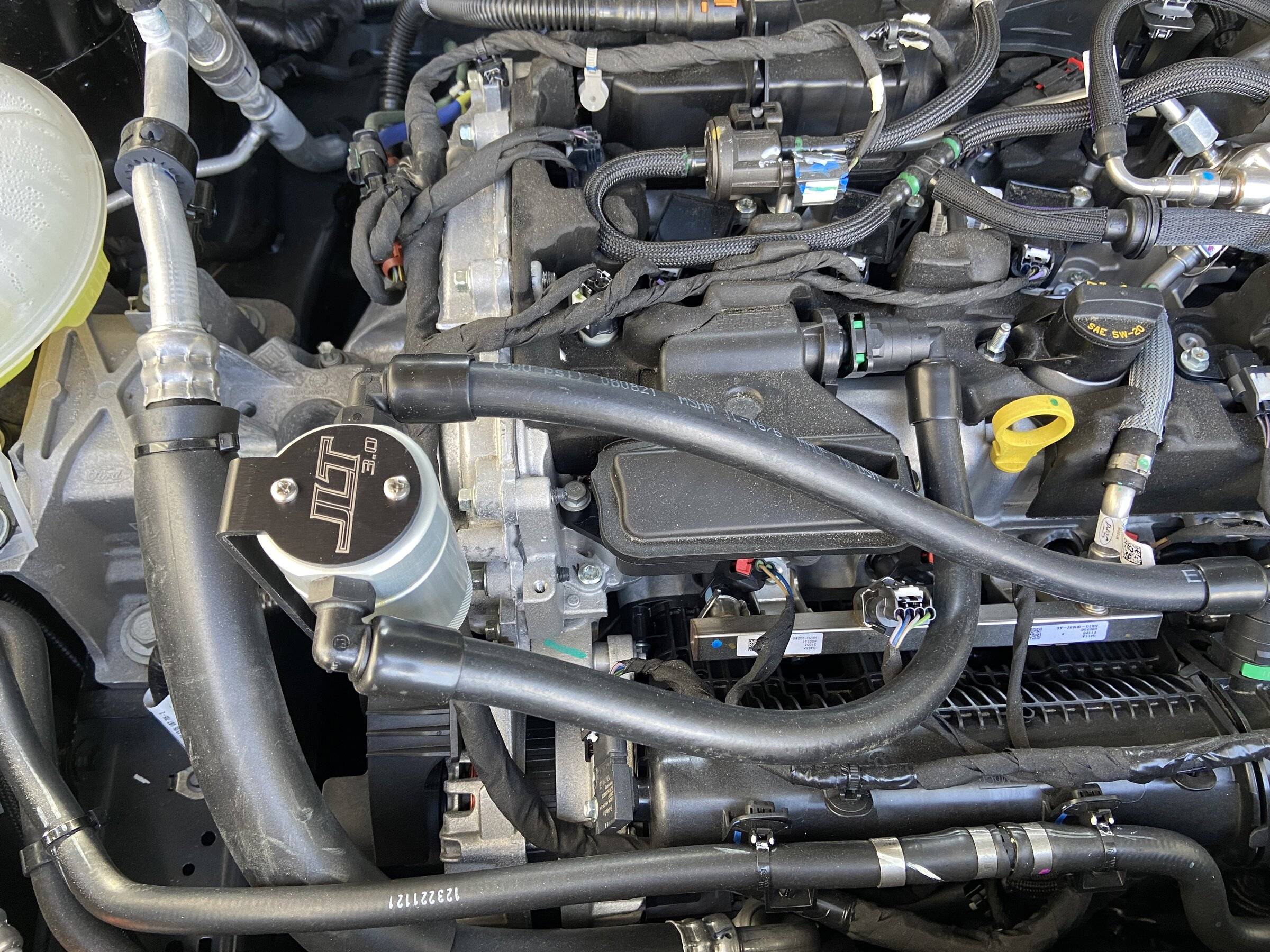

I have the other system from JLT 3.0 that ties into the PVC system
I
Ford Bronco Sport Buschurs Maverick 2.0 catch can 2C1F82CC-BA3D-42EF-9F0C-140E5835C693
Ford Bronco Sport Buschurs Maverick 2.0 catch can 7278B712-CD21-483D-B6EA-260736A238B6

If you live somewhere with cold winters, you should avoid low spots in these catch can hoses. Fluid (mostly water) will accumulate in the dip and will freeze up in the winter, which essentially blocks the PCV system. It may thaw when you drive but most likely won’t get dry and it will happen again. Basically it should all drain out of the hoses, preferably into the can.

That’s nice is that the 1.5. I have the 2.0 but plan on getting the jlt to I think on 2.0 all the pcv connections are on bottom of mainfold looked like a pita. Not interested in taking apart brand new truck. I live in Florida but thanks for the info Mean.

That's great for the 1.5 but the 2.0 has two different PCV lines (JLT and Buschurs each use a different line) and I'm hoping to see what folks experience depending on the kit they chose.
