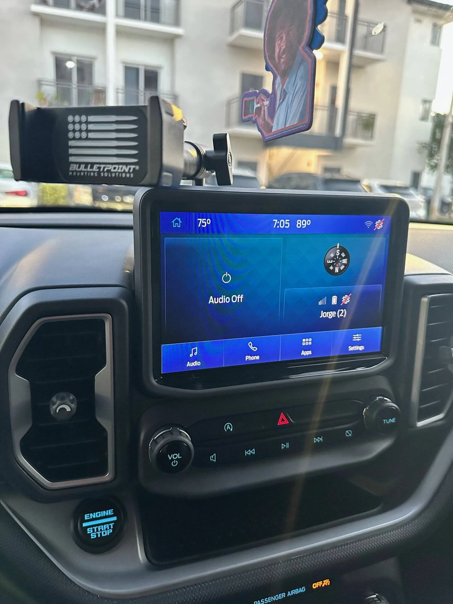

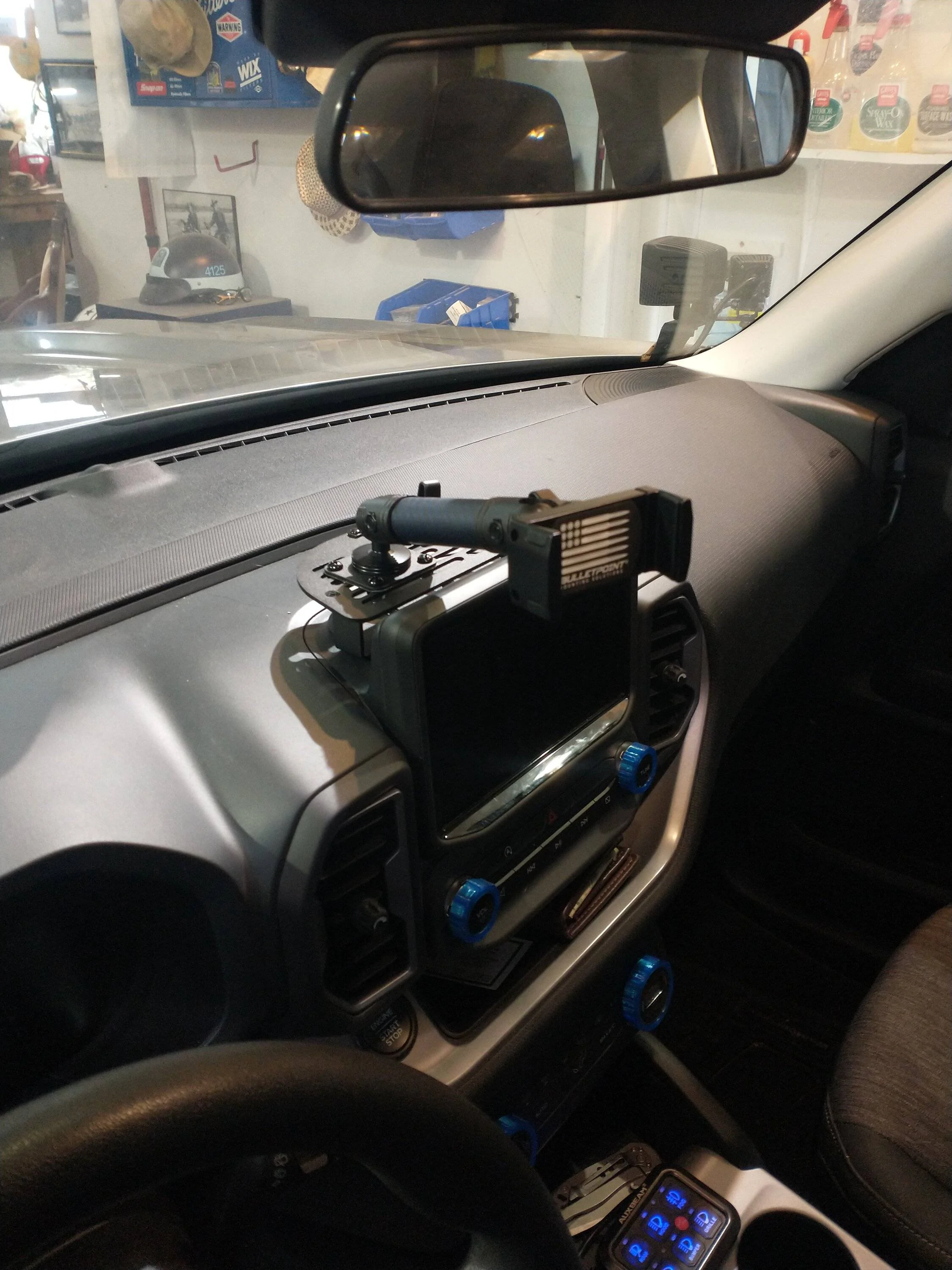

Just finished installing mine. I used the longer 7 mm arm to comfortably clear the screen. Super easy to install and appears very sturdy. I like it alot.

Looking good. Yes, the 7cm arm is the way to go with this kit. Weird how they include the 4mm which is too short imo but I found a use for it. ?

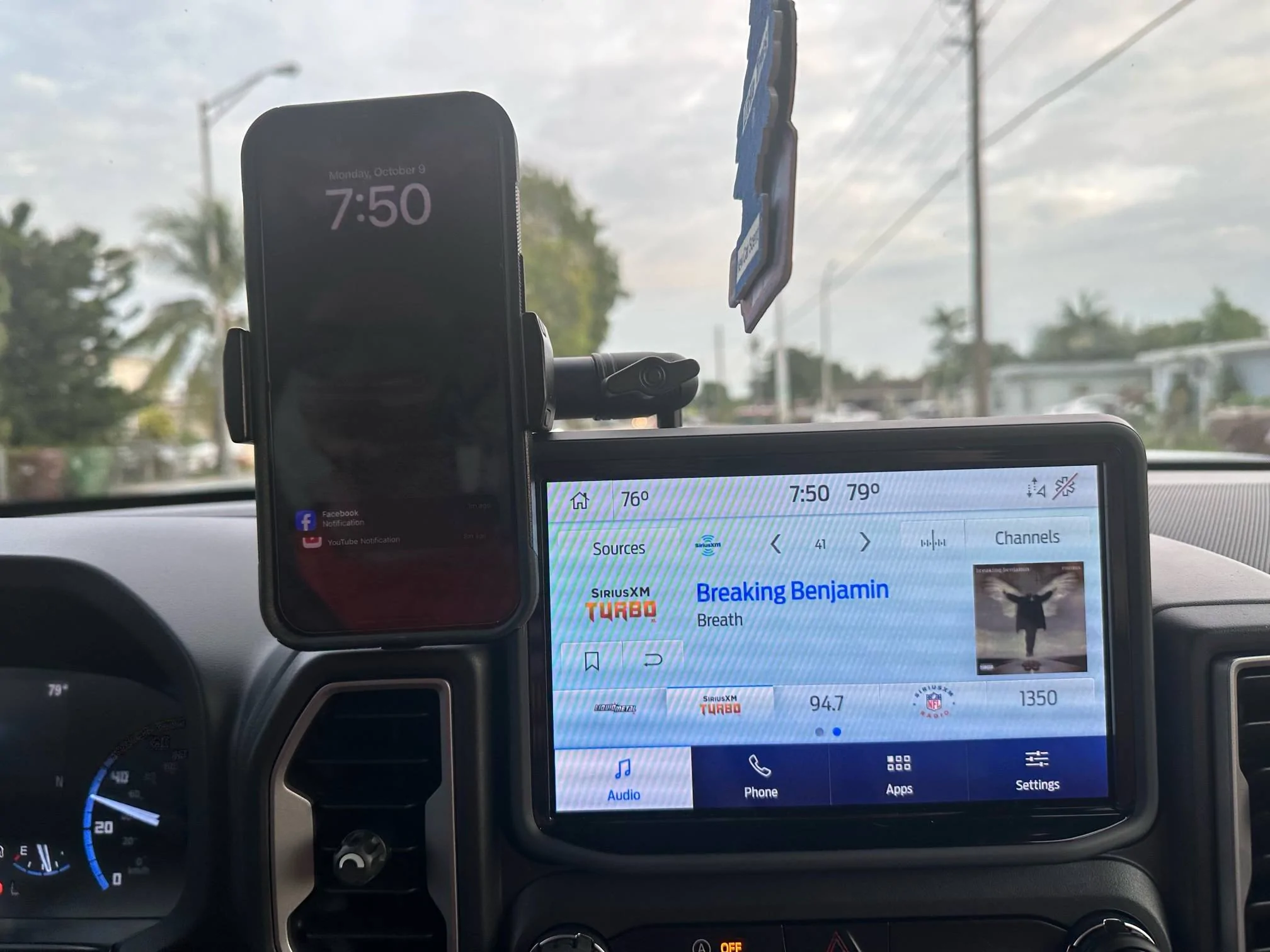

Installed my mount yesterday, and it has a slight vibration with and without phone. Does anyone else have this problem? If so, how did you fix it?

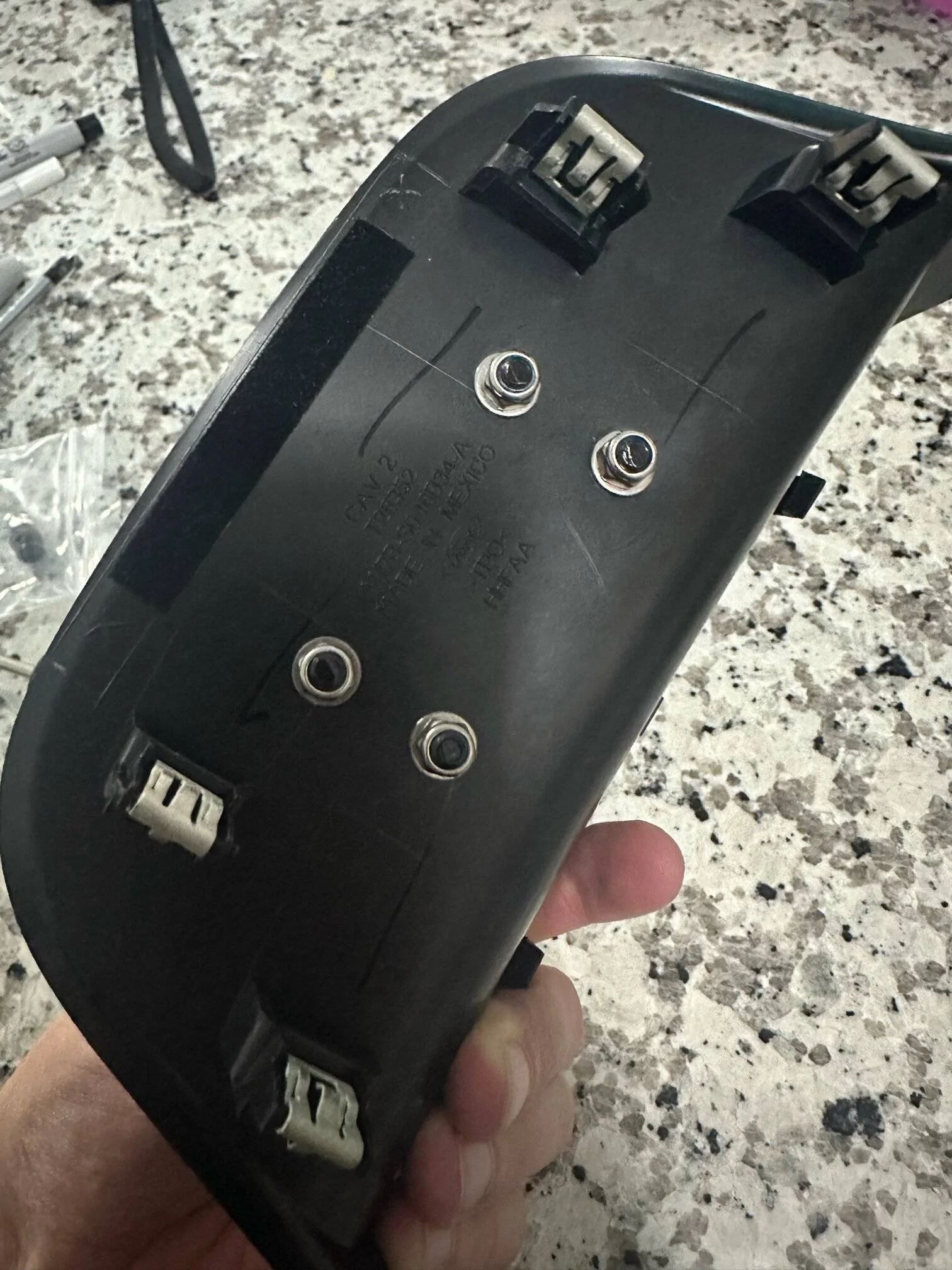

first had to remove the panel behind the screen. the trim removal tool the kit came with made it super easy.
the trick was to start at the top and make your way around. popped right off

once removed, place the whole mount on top the panel to center. i unscrewed all the screws, made sure it was still centered then made my marks with a metallic sharpie.
Ford Bronco Sport Bulletpoint Mounting Solutions Install and Review image4
then i used the drill bit provided to make the holes.

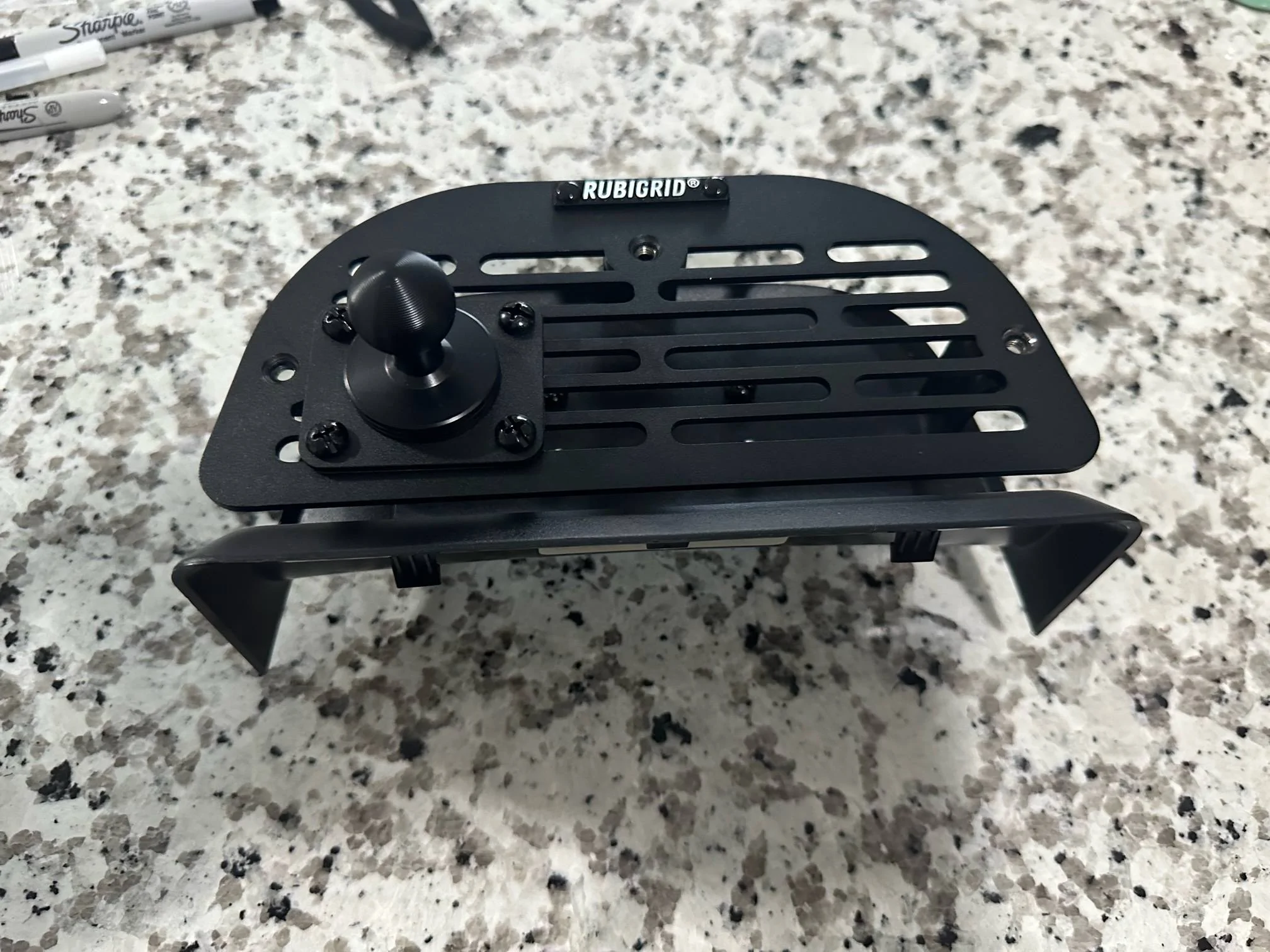

placed the bottom part of the mount back on with the screws, washers and bolts.
Ford Bronco Sport Bulletpoint Mounting Solutions Install and Review image3
screwed the ball mount onto the top plate but before fully tightening it and screwing the top plate back onto the bottom plate, i went back to my BS and pushed the panel back into place. attached to arm to the ball mount to make sure i liked its location, thankfully i did. then tightened the ball mount and top plate back to bottom plate.

phones in my face and does not interfere with the view of the road. which is exactly what i needed. the mount is super sturdy. my phone is not going anywhere.
i just wish the arm was about 1/2" longer so it would not touch the screen. it doesnt block the screen or anything, just being a little picky lol. but i will be buying a longer arm in the future just to make myself happy lol.
