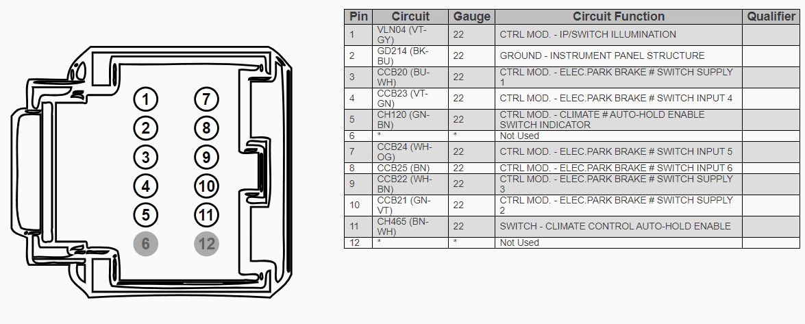

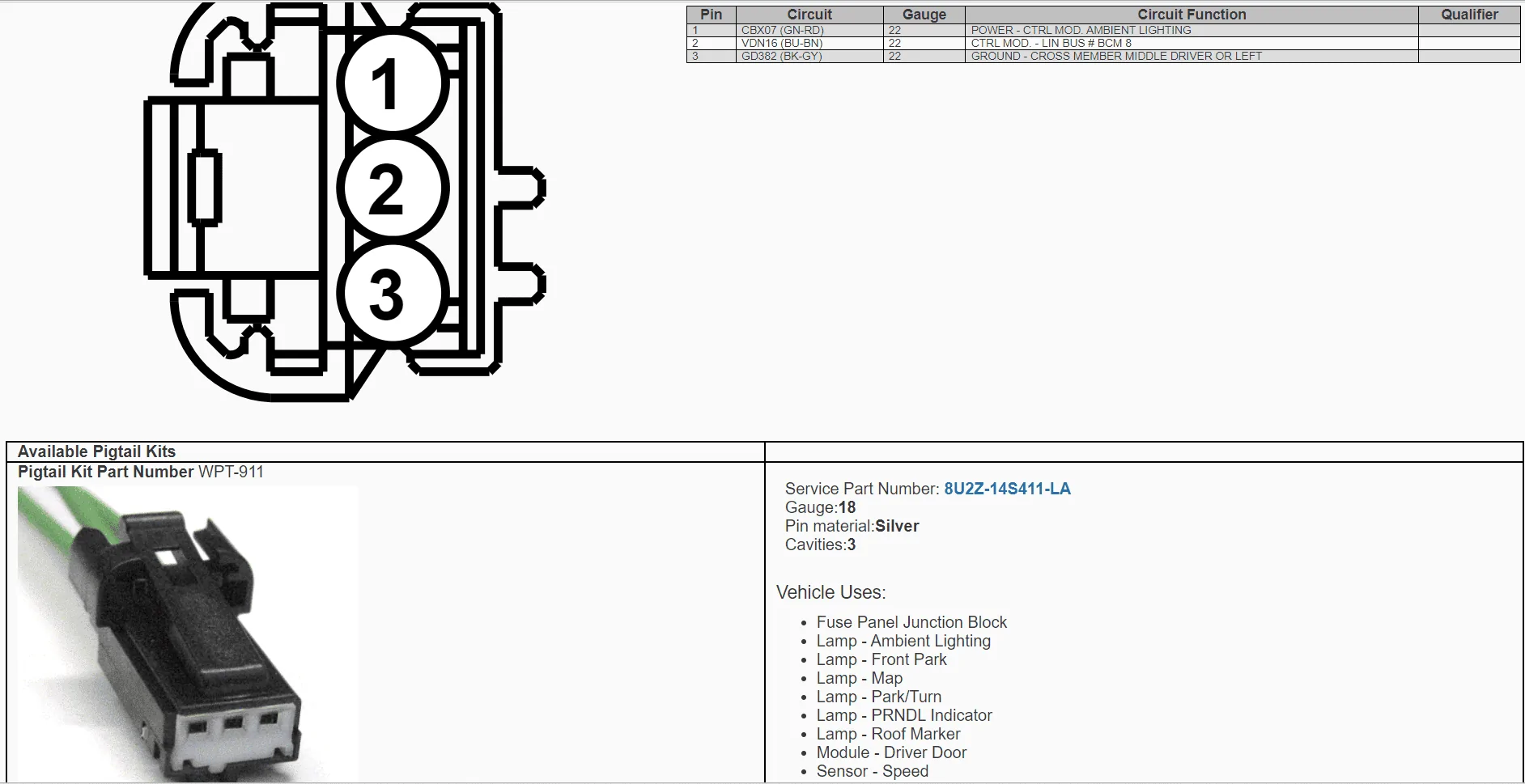

I bought that same part - I also bought the 14S411 pigtail for it once I realized that the connector was not there on my Badlands - it's a positive, negative, and then a third wire - I was thinking of connecting the positive and ground to the positive and ground on the parking brake connector, because that would theoretically work without any issues, but there is a third wire that may control dimming, or maybe it's there for the ambient controls on the sync screen, if mine actually had that.
Here is the pinout for the cupholder connector, as well as the pinout for the emergency brake connector.
Ford Bronco Sport Bronco Sport with illuminated center console cup holder AMBIENTCONN
Ford Bronco Sport Bronco Sport with illuminated center console cup holder PARKINGBRAKECONN
