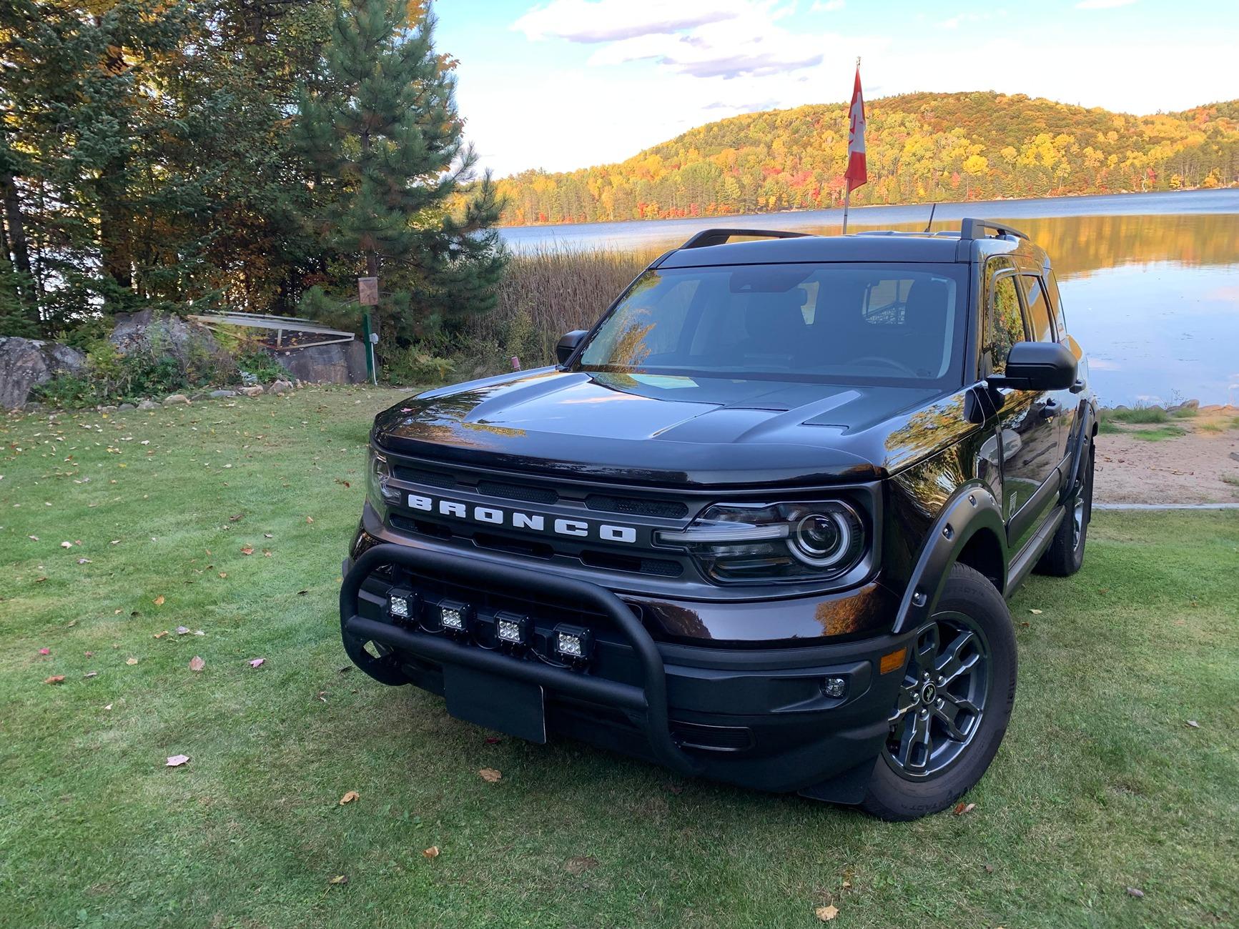

I have a 2021 Big Bend with a nudge bar from Rough Country and it doesn't interfere with my cruise control at all.

I too have a 2021 Big Bend with a Rough Country nudge bar. No interference what so ever. Looks and installs great.

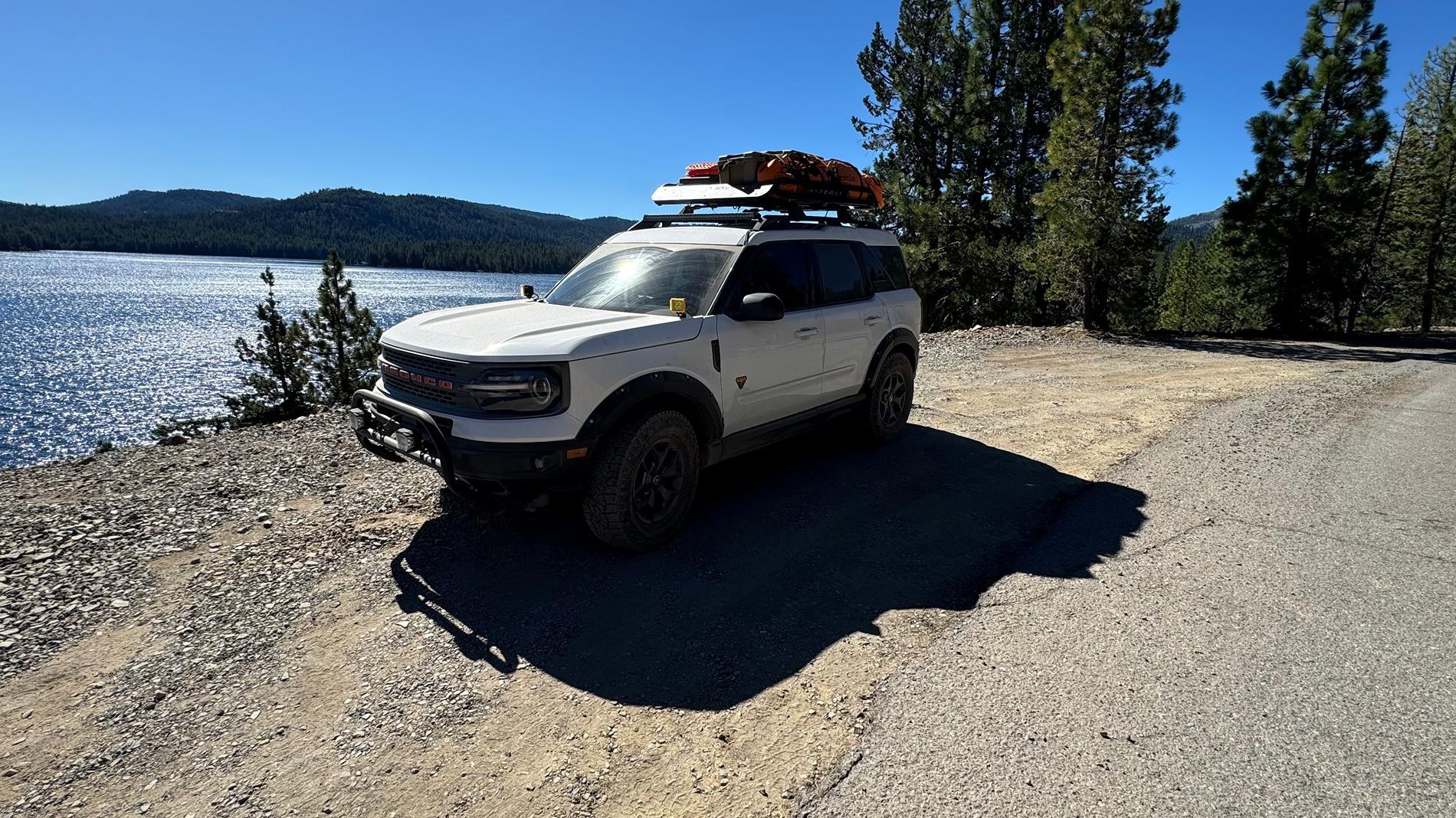

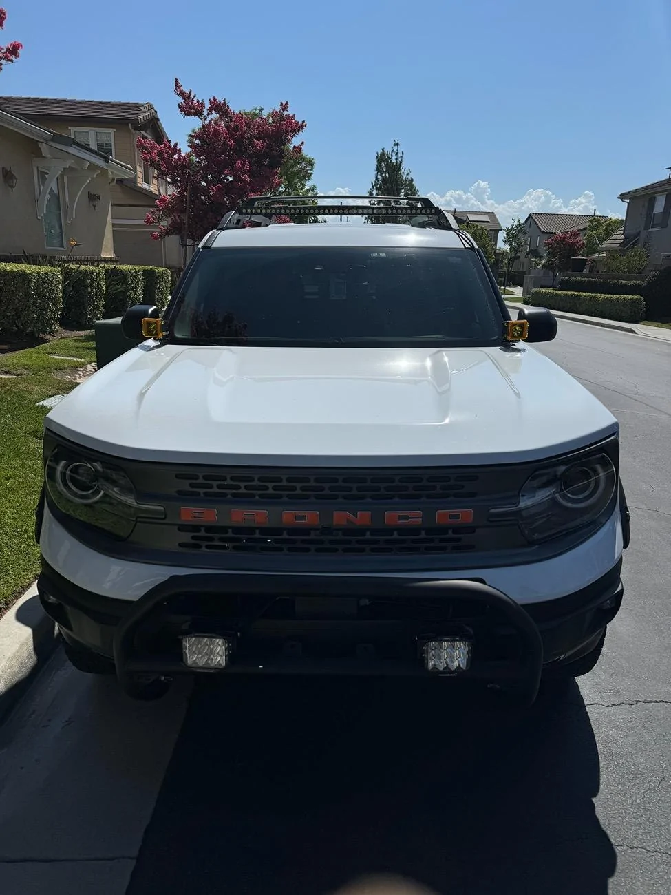

I have a Rough Country nudge bar on my Badlands. It is not an easy install. I had to remove the front tow hooks and customize the front mounting brackets with additional mounting holes and with additional grade 8 hardware. I had to cut about 2” to 3” off the bottom of the mounting brackets or the bumper cover will not go back on. All sensors work as expected.

Per the RC website listing, it specifically states for non- Badlands but I wanted what I wanted and love a great challange. I have adaptive cruise and it works perfectly without any sensor mods.
in retrospect, I would have a pre-runner style bumper bar/ skid plate fabbed up and cut the lower bumper valance near the wheel wells to add more approach angle. I desert wheel and overland quite a bit in our BS and the mods would be to allow to reuse the tow hooks and integrate a removable skid plate like a trophy truck. Still thinking about making it anyways and scrapping the RC nudge bar. The ford ranger lifts nudge bar would be a lighter weight nudge bar option if you want a bolt in nudge bar. The RC nudge bar is very heavy for the BS.

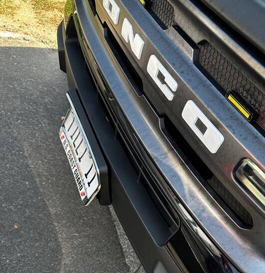

Speaking of interference, as I was waiting to exit a parking lot, I was behind a HRV. For whatever reason, this idiot throws it in reverse and BAM! right into me. Luckily, only the plate and it's frame were damaged. If I had a nudge bar, I'm quite certain I would have lost the grill ad well
