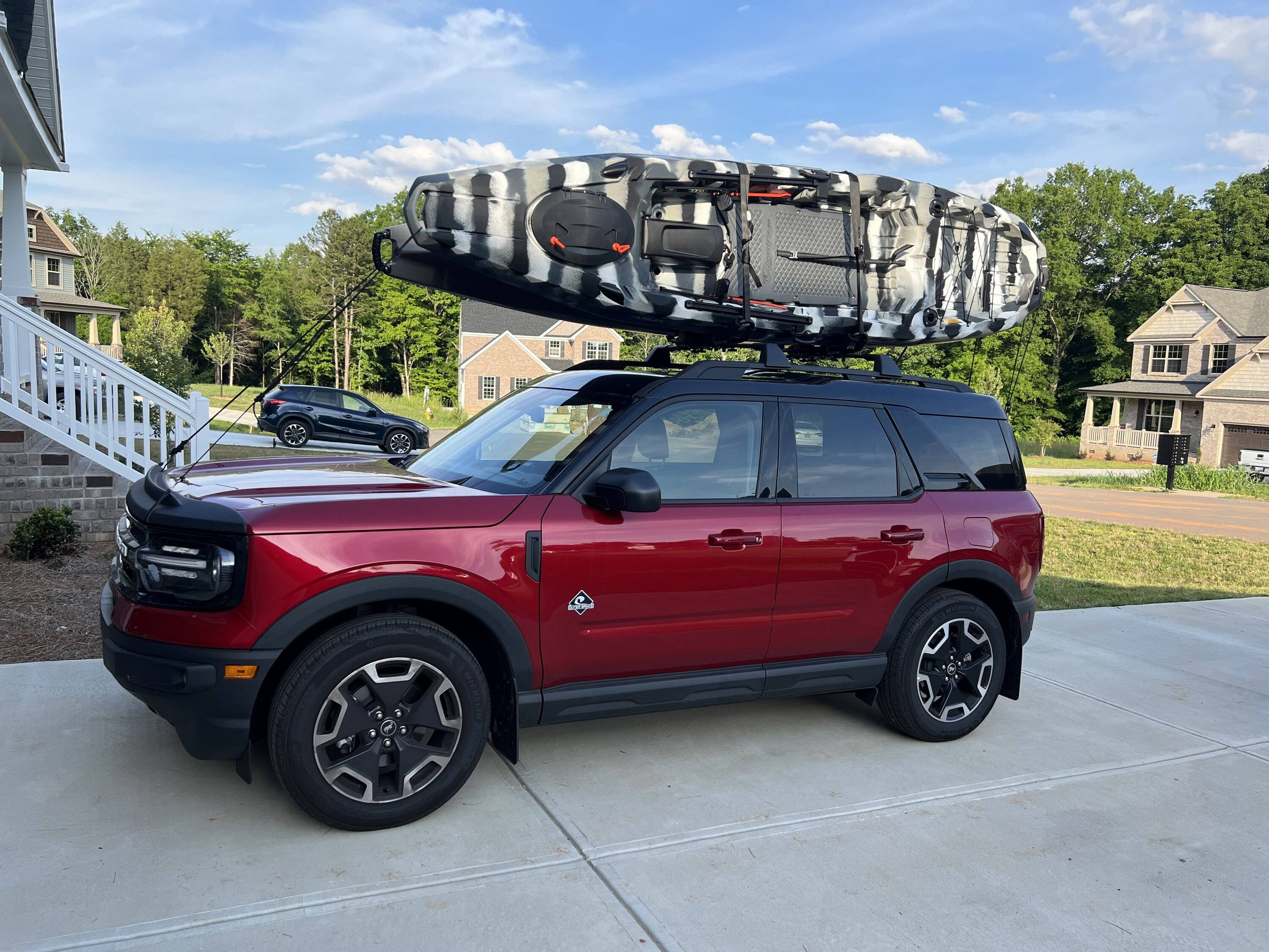

Hi all, I'm transporting a kayaking soon on my BS' roof and wanted to see if anyone could give any pointers for tying down the bow and stern. I am strapping the kayak down flat to crossbars I have installed on my roof. I plan on feeding my bow/stern straps through my kayak's handles (photo of my kayak), but am not sure where to mount the straps on the vehicle itself and how to tie/ratchet them down correctly. I do see in my trunk two mounting points on either side, and also found this video. I am hoping to get more clarity though so that I do this safely.

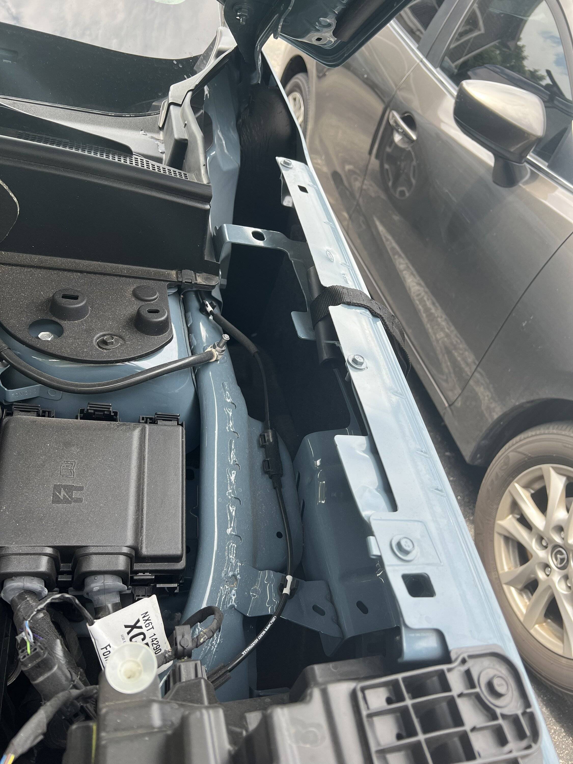

After getting my kayak I was actually able to figure it out and nail down a good system. There are two ropes on the front tied down to hood straps (same kind in my original post). They actually fit snug in a specific spot on each side:
Ford Bronco Sport Bow/stern tie-down points for kayak? 572C6A40-19B2-4F3F-B58E-7C74BFFD7E7A
For the back, I have the ropes going underneath the lift gate. They hook onto two tie-down points that come factory. I don’t have a picture of them right now, but they’re hard to miss and more down towards the trunk liner. Overall it’s a little tedious to tighten down but once you do it the first time you feel pretty confident.

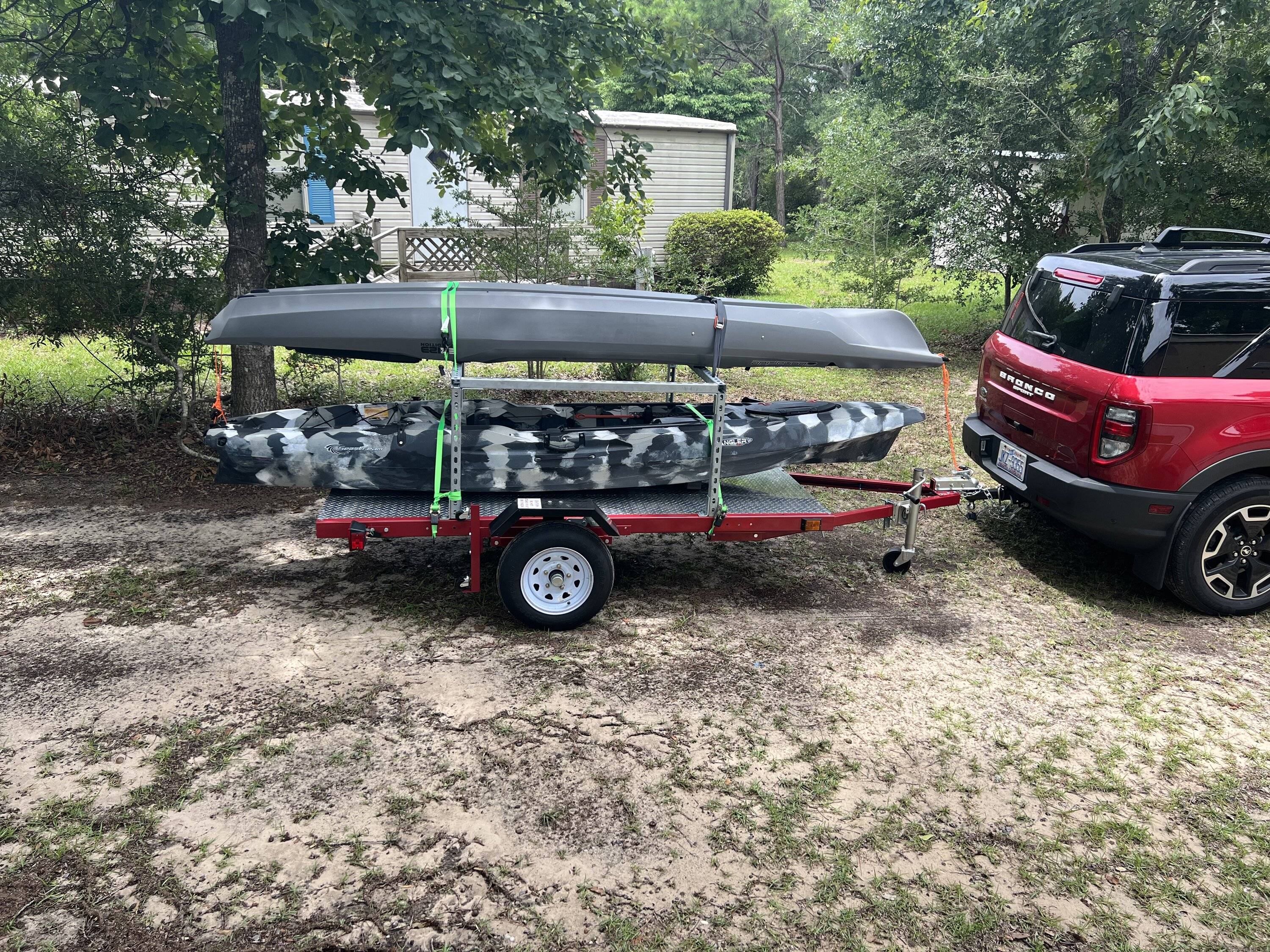

I can honestly say the hood straps worked perfect. For the stern, I had already installed the trailer hitch, and I just tied them to my trailer hitch. Purchased a double J-Hook carrier and strapped them in.
Trouble I had was with the shape of the back end. It is contoured just enough that you can't use the suction cup rollers to get your kayak up there. This combined with the weight and length of my kayaks, and how short my girlfriend is... I finally broke down and just bought a super cheap trailer kit from harbor freight and built a rack on it out of unistrut and secured the kayaks down that way.

No worries about scratching. Because the hood loops are under tension, they pull away from the hood. Even if they did touch I don’t think it would be any more abrasive than what the hood already faces while driving.

Yeah, a smart man would’ve thought of that. I had been itching for a small trailer, and used it as an excuse to buy one. I made the rack removable, so I could have a small flatbed trailer when I needed it.
Option 1:
Ford Bronco Sport Bow/stern tie-down points for kayak? F122CCE3-E057-46CD-BC20-0A37F1DCE495
Option 2:
Ford Bronco Sport Bow/stern tie-down points for kayak? 71ADB7D1-AC3B-4A15-BB2F-1F62C52940DB
