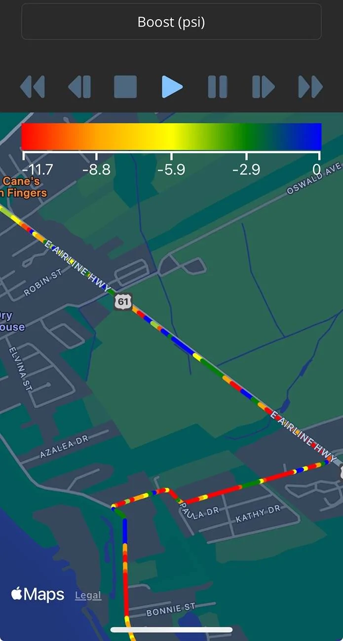

I'm wondering whether anyone has installed a Boost Gauge
Using the OBDLink MX+
This is their default display for the boost gage. Haven’t customized the displays yet.
Still have to figure out how to mount my old iPhone for best viewing.
Ford Bronco Sport Boost Gauge IMG_6797

if so, where they picked up/tapped in for the boost signal. Picture would be nice!
And it gives a nice map result.
I presume they are calculating boost from the installed barometric pressure less the installed intake manifold pressure.
Ford Bronco Sport Boost Gauge IMG_6798
