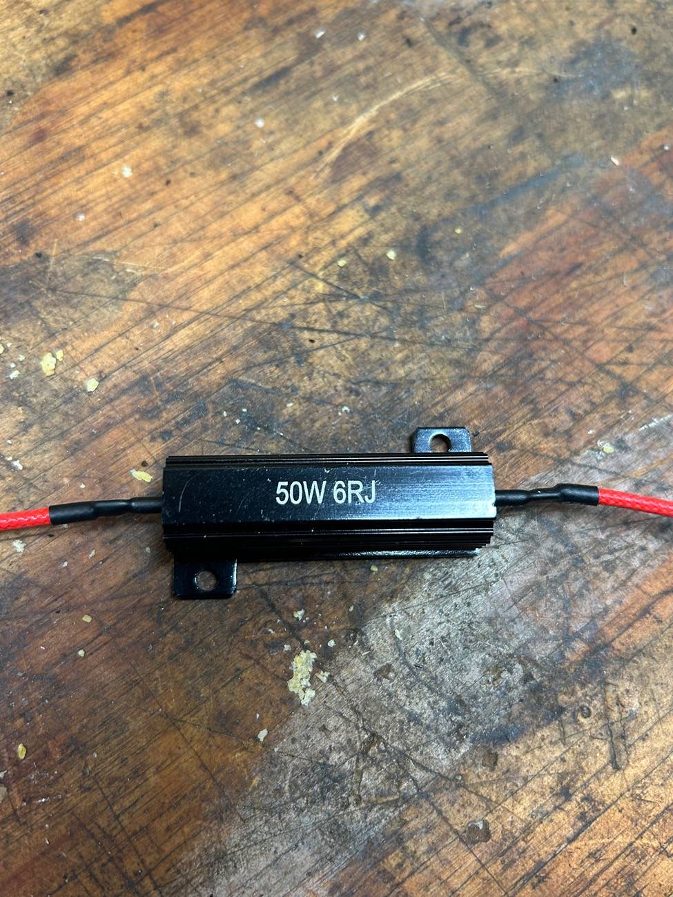

Used 50w resistor. (Really could find no information about what value to use). No pic showing how it was installed, but I tried them both ways and got the same result. I put one resistor in each wire except for the ground.

Resistor goes in parallel with the LED so across the leads of the LED

Here are a couple of calculations, from my owners manual the rear turn signal is 16W:
Voltage: 12V
Incandescent bulb Power: 16W
Resistance = V² / P = 144 / 16 ≈ 9 ohms so an 8 ohm or 10 ohm 50W resistor
Many rear turn signal bulbs are 21W so here is the load resistor calculation for that:
Voltage: 12V
Incandescent bulb Power: 21W
Resistance = V² / P = 144 / 21 ≈ 6.8 ohms so a 6 ohm 50W resistor
The load resistor goes in parallel with the LED so across the leads of the LED
The load resistor will get warm so should be a metal clad resistor as shown in your pic and bolted to the clean metal frame of the vehicle (away from any plastic or anything else that could be damaged by heat) in order to dissipate heat from the load resistor
Your pic shows the resistor is 6RJ so likely that is 6 ohm - if the incandescent bulb you took out is the WY16W it is a 16W bulb so the load resistor should be 10 ohm or 8 ohm (50W).
