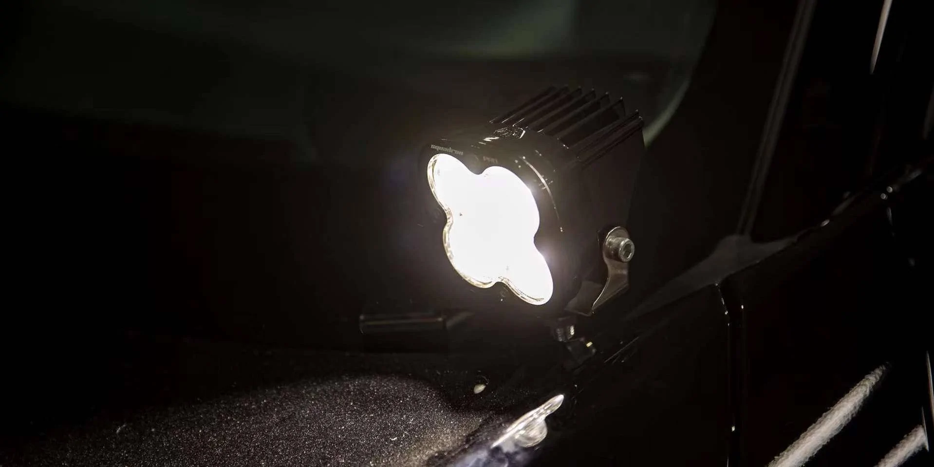

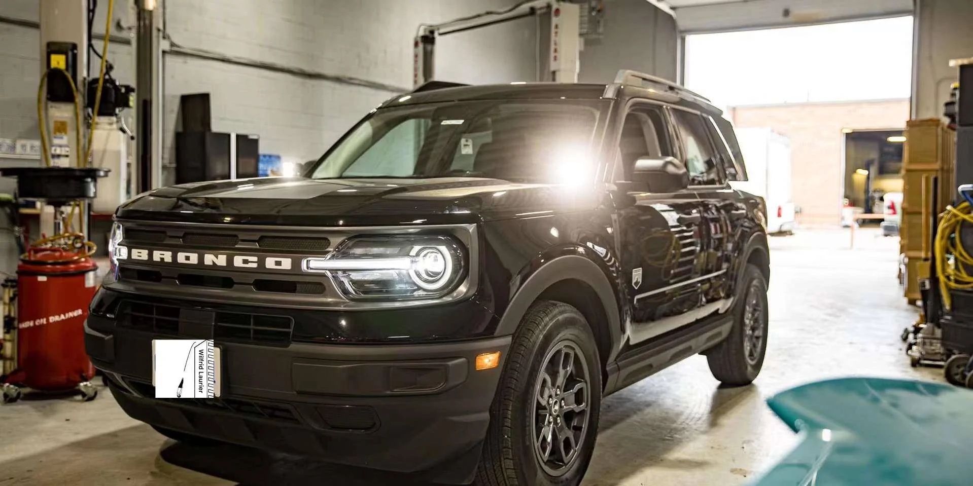

Obviously as a international student living in Canada there will be a lot less options for vehicle modifications than in the US. I chose to use the lights as my first upgrade because they don't require extensive cutting and drilling of the vehicle, nor are they too complicated to install (compared to the nudge bar I'm thinking of installing next spring).

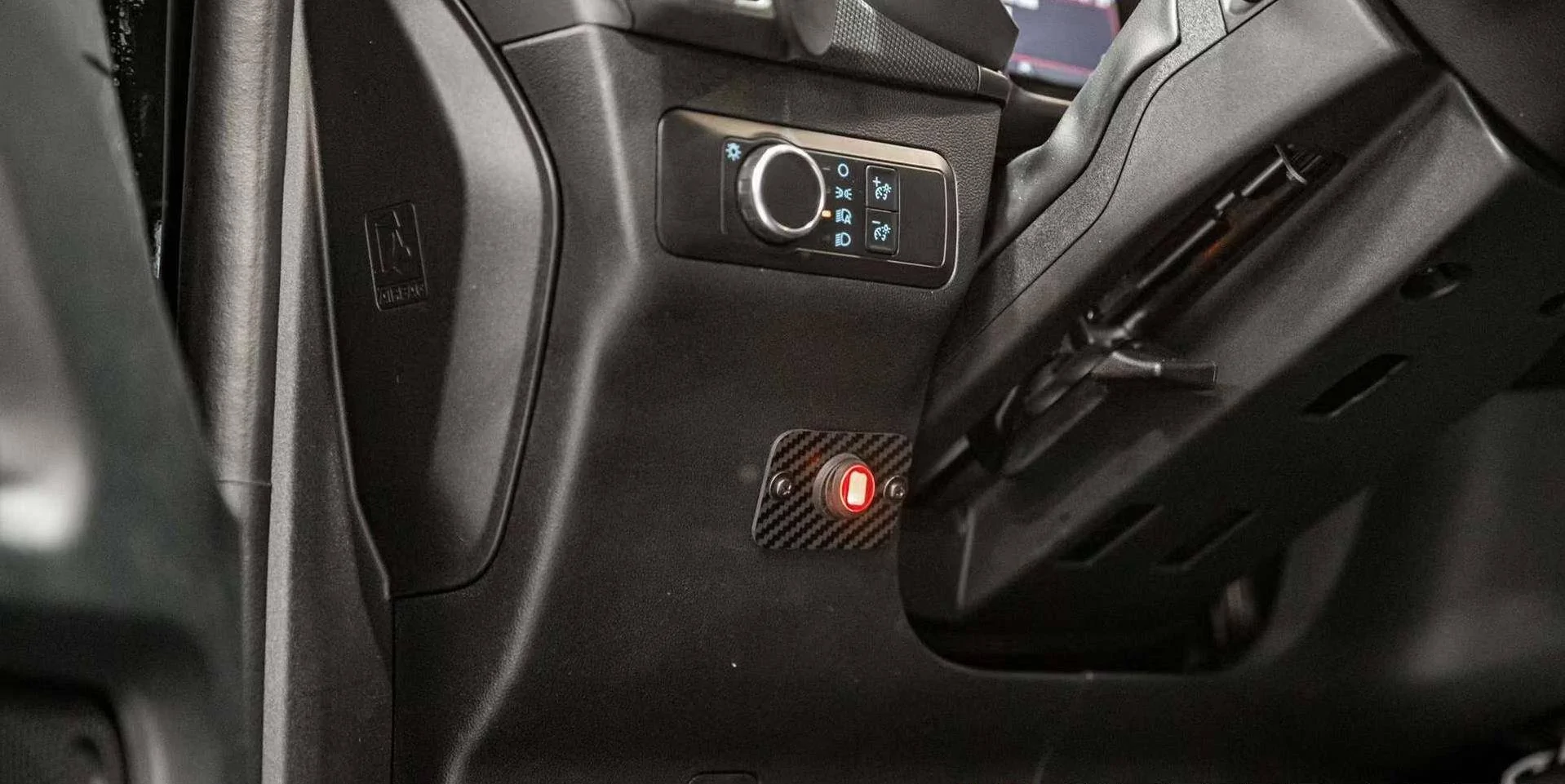

Baja Design was the best solution for me after choosing between brand and price(and also shipment to Canada). The total time spent on the installation was 5 hours. Most of that time was spent on wiring and cable management. The only possible problem was that the switch that came with the light didn't fit my car well (I miscalculated the radius of the hole), and I ended up using a small piece of carbon fiber plate from my university's robotics club to grind it with lathe to hold the switch.

sorry for the late reply (what's 2 years for fellow group members!) the result of your "mistake" looks fantastic!
