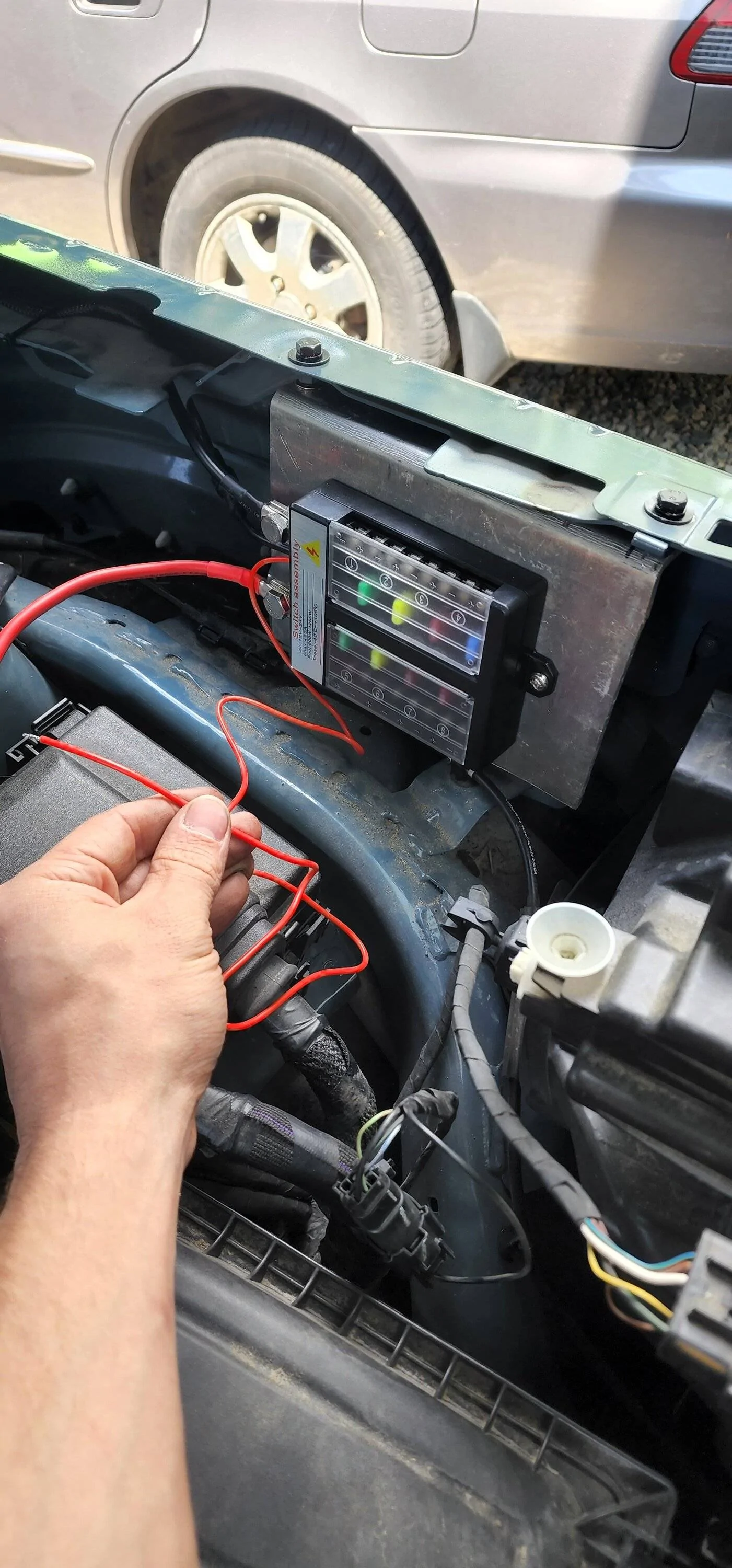

I ordered and installed an auxiliary switch box, got the box mounted and wire ran through to driver side. The iddue I'm having now is connecting the fuse to power. I quickly realised the under-hood fuse box is a pretty sealed box and won't realistically get a tap in there, and the box is a long way from the interior fuse box. Has anyone had to splice onto an exiting ignition-on wire (possibly in the headlight) and had success?

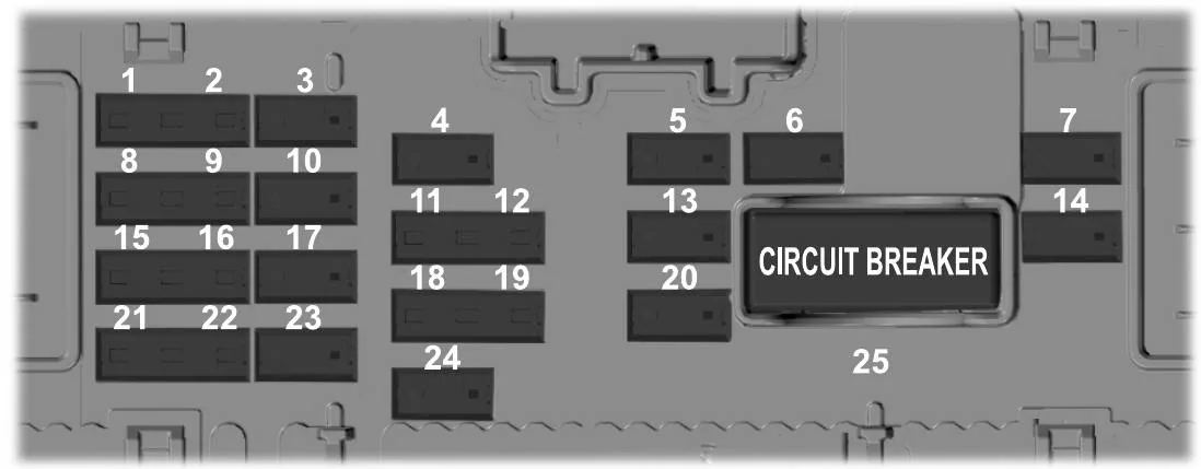

The easiest one for an ignition-only on fuse is probably number 3 on this diagram. it`s un-used and is on the correct side for a fuse tap. 15/16 also works if you have a triple tap instead of a micro. This is all on the interior fuse panel as well, the engine one is pretty well sealed from addons. Either run the wire through the firewall or you can slip it through the rubber grommet at the side of the door
