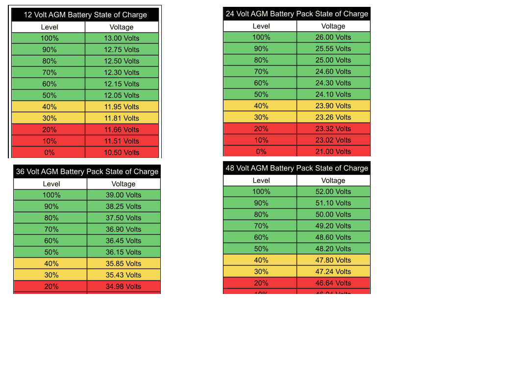

That 12.2 sure looks low, maybe stop by an auto parts store for a check..... Here's a chart I keep for my batteries.

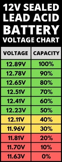

Good chart, note those values are on the AGM batteries. Mine came with a traditional lead acid one. LA is similar but different.
Ford Bronco Sport Battery Voltage Reading Lead-Acid-Battery-Voltage-Charts-Image-10
