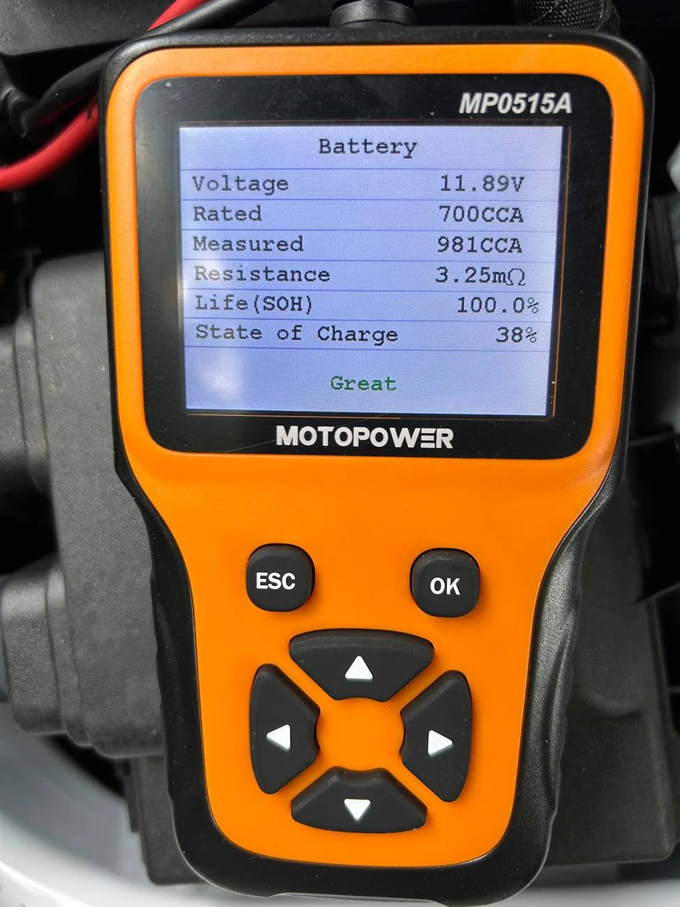

I just tested mine directly connecting to the positive and negative terminals. If you are charging the battery, definitely connect to the battery monitor terminal other than the negative terminal. I hadn't used mine in past 3-4 days so state of charge and battery voltage is a little low but actual CCA exceeded the CCA stated on the battery.

Can this device conduct a load test?

It is an alternative to load testing and sometimes works better than a load tester. There is a YouTube video comparing the two. Presenter showed that his load tester had determined that a battery was good and yet these testers advised to replace the battery. He had to replace the battery. I have used mine on multiple cars, aircraft batteries, and batteries on a solar system. I also have a load tester but no longer use it. This one measures battery resistance and calculates remaining battery life with the stated CCA versus calculated CCA.

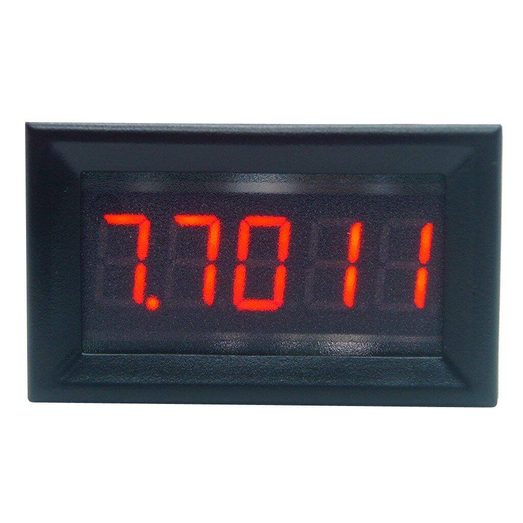

I know nothing about the tester above, but generally speaking, there are a lot of relatively cheap electronic battery testers (typically made in China). From everything I've read, they are mostly inconsistent and not durable. The mfrs & vendors often do not publish any specs. There are decent ones, but they cost hundreds of dollars.
Any device with a digital display (as opposed to the analog meter on a traditional load tester) may appear more accurate, particularly if it goes out a few decimal places. One of the first things we were taught in electronica class in high school was the difference between precision and accuracy.
Most BSF members may be aware of this, but, while a display like this is very precise, it may not be accurate:
Ford Bronco Sport Battery Load Testing 1728326744204-y9
The analog meter on a load tester is not very precise -- usually you can only interpolate to ~0.1V -- but they are reasonably accurate -- plenty accurate for a load test.
I like the idea of an electronic battery tester. If a good one could be had for (say) $50, I'd buy it. But from what I've seen/read, a decent $50 tester does not exist.
