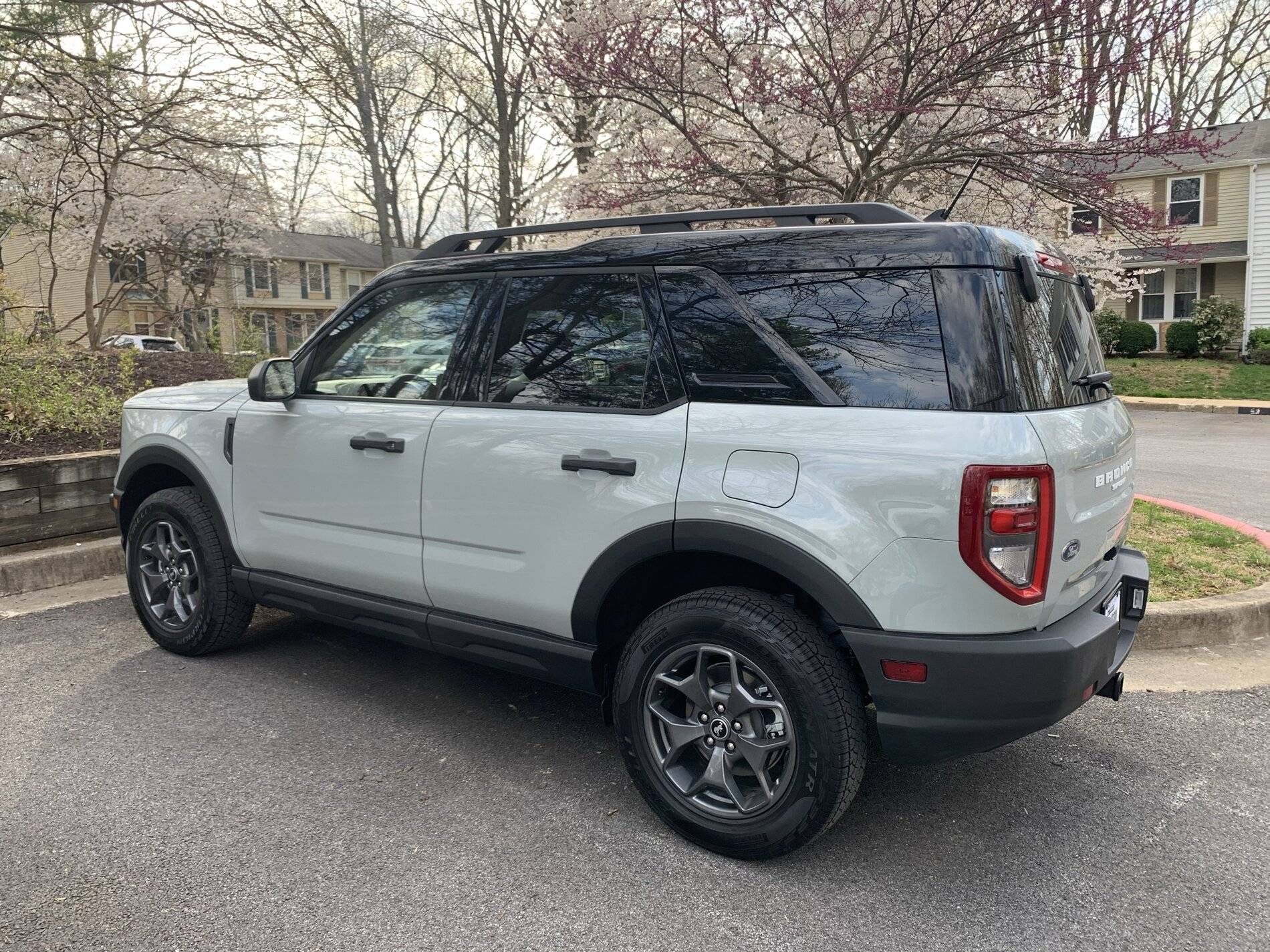

Was there any residual adhesive after peeling the badge? Did you require a heat gun/source to peel it off?

I used a heat gun for maybe 10-15 second over the badge and the sticker pealed off smoothly and easily. There was very minimal adhesive residue that a few wipes of WD-40 took care of.
I don’t think it would work as well without a heat gun.

Excellent - Thanks
