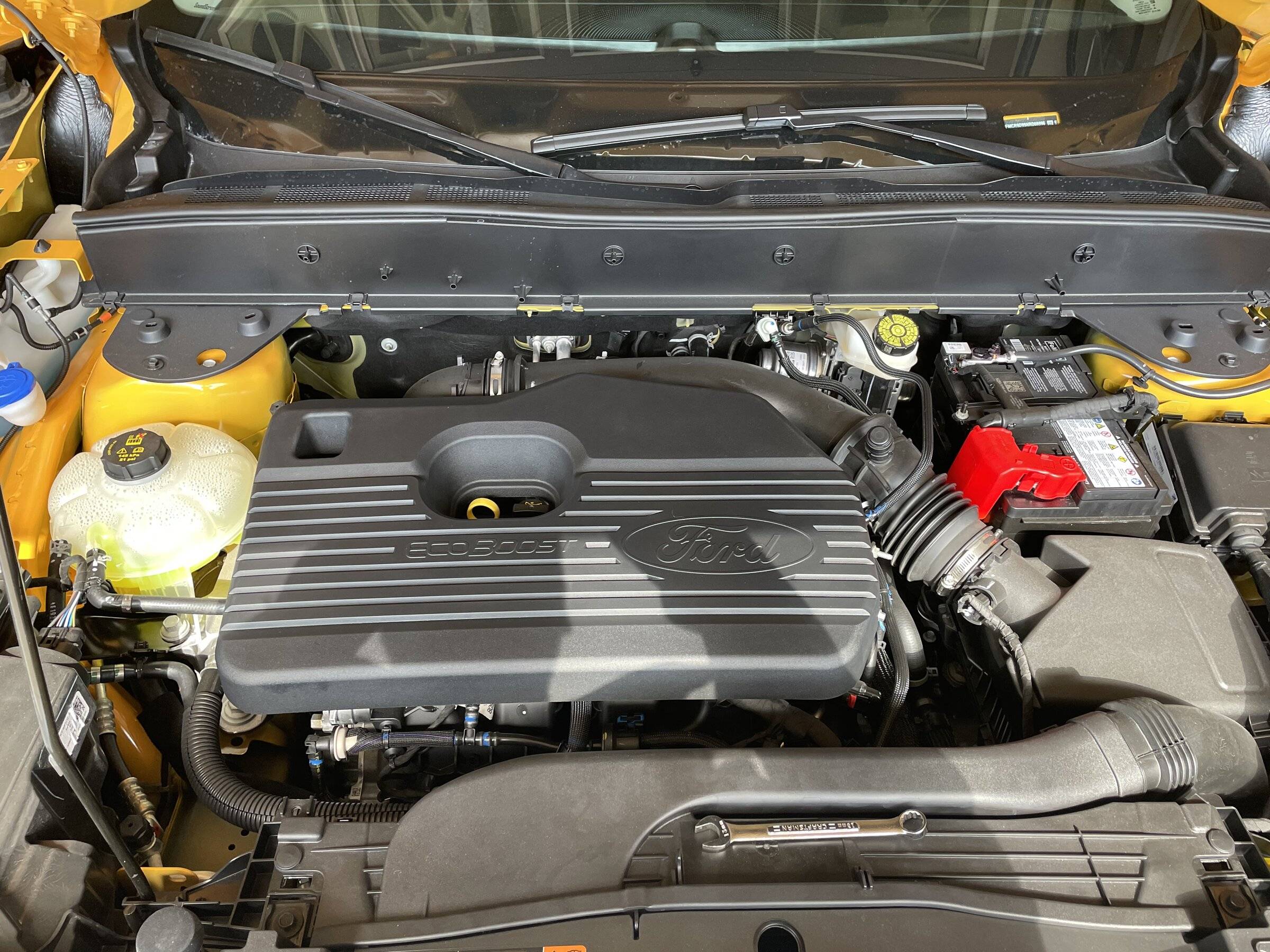

So some people are upset they didn't get and engine cover... I am just happy we got our car. So I went to Ford Dealer and bought the parts - seems to fit ok. Here's the list:
I used 1 of each of these parts:
K2GZ6A949A - COVER - $98
AA5Z6N958A - STUD (BAL) - $16.03
W520201S450B - NUT AND WASHER - $6.83
W714647S450B - STUD $3.68
I was able to get some discount, my total was like $107 with tax but I had to buy some extra parts. So here's my comments on the parts:
K2GZ6A949A
This is a foam cover - there are places for 2 ball studs that are incorporated into the Air intake that snap into the bottom of the cover.
AA5Z6N958A
This is a ball stud that screws into one of the brass inserts on the Cam cover
W520201S450B
This is a nut washer combo part - it is only 1 part. Sold in packs of 4, but the dealer had 1 so they let me buy 1. You could but this from Home depot I am sure. You could but a separate nut and washer.
This is an integrated fastener, with a washer and a nut washer - this attached to the CAM cover on a molded in brass insert - the nut/washer part goes on here after the cover and provides the 4th attachment point.
I had to buy 4 of these - I have 3, if anyone wants 1 let me know I'll mail for $6 - including shipping.
I'll post some pictures later when I actually put it on.
Very simple to do, my 15yr old figured it out on his own.

My parts are on the way, I may need to contact your 15yr old. :)
It certainly looks a lot more finished under the hood.

Thanks for posting the part numbers, i ordered mine from levittown ford and have it installed already.

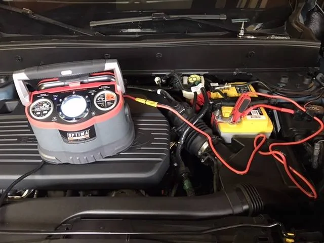

Dumb question...what are the benefits of the engine cover? Neither my old mustang nor mariner have one. Wouldnt a hood liner be more beneficial?
It’s a good spot to set my tools when I’m working on my truck or place for my battery charger.
