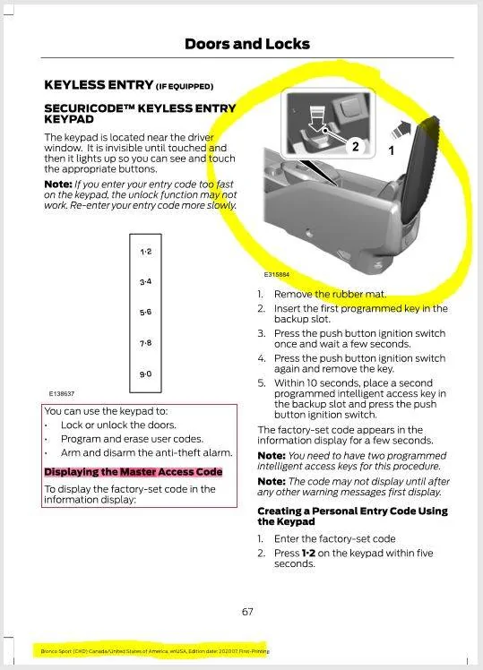

Backup slot location?

had to walk out and see if I had the card under the console....
Nope
Next time you are in your car, pull out all the removable mats in the car, cup holder, wireless charger mat, storage slot above it

My dealer had removed the physical card and put it in with the paperwork that came with the car.

BSBL
I was given the wrong card with the code written on it, I was just trying to retrieve the master code from the BS's brain. Looking for a slot that is non-existent, turns out to be an indentation that the fob is laid upon. Not sure how i function in society.
Did the same for me, but gave me a card belonging to another vehicle. So of course I am like a crazy person trying to enter the code and call upon family, friends, neighbours, random people off the street,trying to get the bleeping code to work!!!!

The master code is physically printed on a sticker on the interior fusebox panel.
The first version of the owner manual told you the key recess was IN the center console. So good luck with that. It's below the media tray as pictured upthread.
