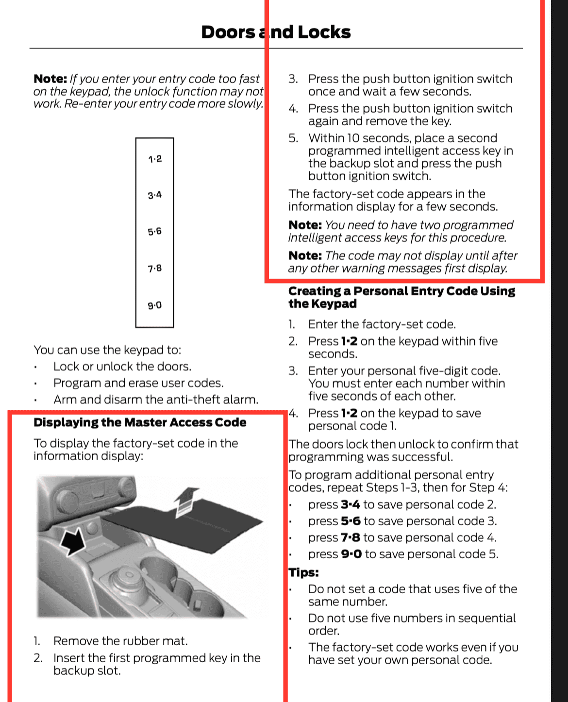

Could someone please tell me where the backup slot for my 2023 BSBL is located? I have removed the rubber mat no slot. Searched the whole console area I can’t find it. I am trying to recover my Master Access Code. The one on my card doesn’t appear to be the correct one as it states the code is incorrect when i enter it. And because I am just a boot with a head, I had my partner try it, to no avail.

Weird, owners manual and on my Ford pass how to videos they talk of this slot?
Yes I have panel installed, as well as a hood insulator. Things are looking up!
Yes it’s the code for my door I am trying to verify the one on the card matches the vehicle.

Yes there is supposed to be a slot to enter both key fobs(one at a time) to display the master door code. That is the slot I am trying to find.

Read the manual?
For my '23 at least: There is no physical slot. Take the rubber mat from the lower stack cubby, lay the keys there in some spot. It's in the manual.

I read the manual and it does say insert in slot. Page 73. Are you referring to the indentation? In my world slot and indentation are completely different.

There is a indentation for sure!

Apologies for the snarky reply. But yes the manual's "slot" is indeed a mere indentation in the cubby floor.

And to add to my pitiful lack of reasoning, on the Ford Pass App, it has a video of how to by showing actual slots, but located in the cup holder! I am done with this day!!
