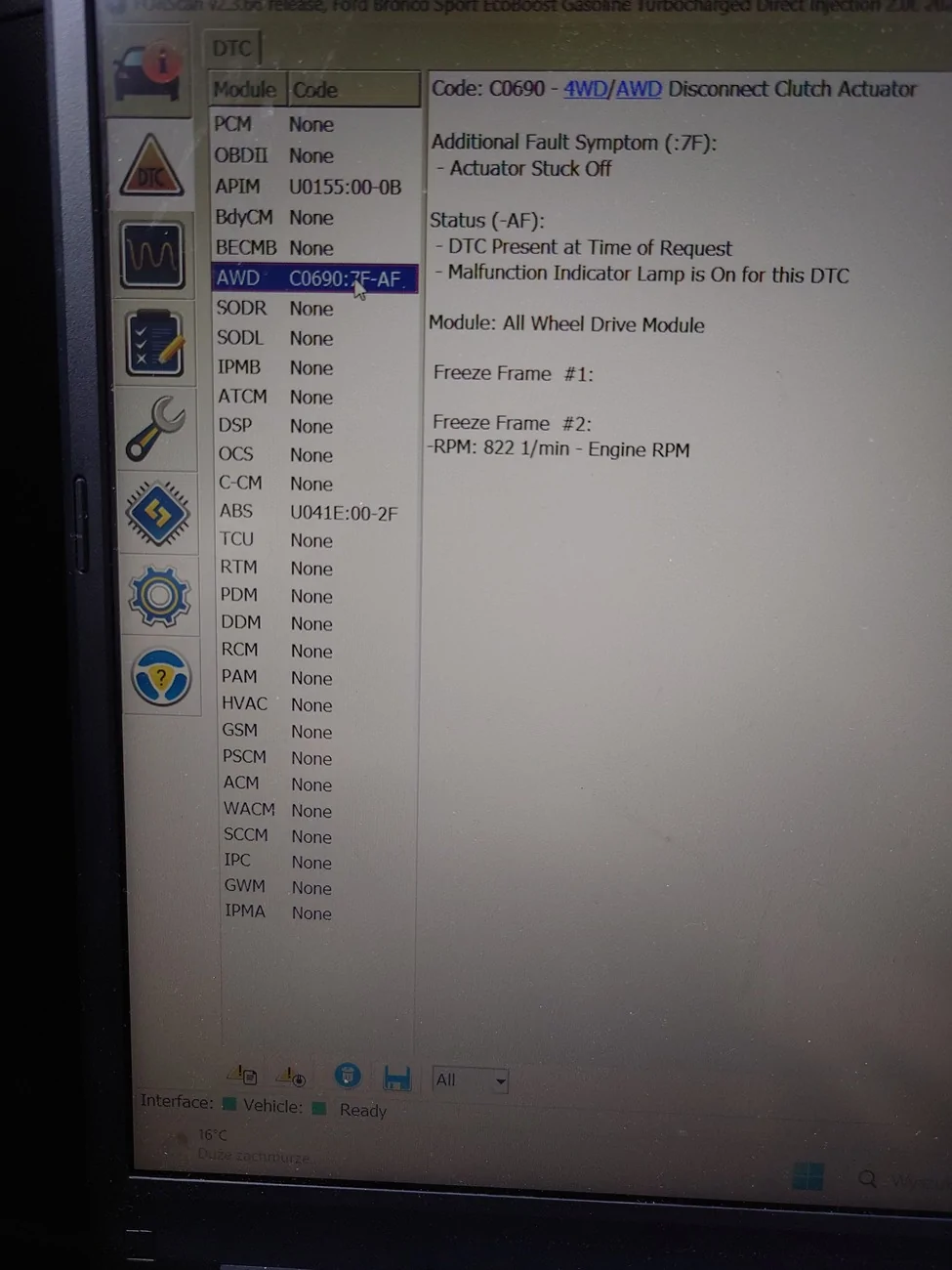

Hi , can anyone help?
On display I have wrench and AWD Fault, in forscan have C0690:7F-AF
Ford Bronco Sport AWD Fault C0690 20250911_122051

Yes, thanks but what first? Module? Which motors ? In badlands are two, left and right? What's parts number off new module?

You have other posts from April with possible RDU problems, was that resolved or is this a continuation from April.
You don't want to just throw parts at the problem, you need more information like an actual diagnosis otherwise its just a guess of what the cause is.
If the 4WD module is the problem the replacement module will need to be programmed to the RDU.
Module P/N M1PZ-7P238-C

Yes, that's a continuation, the problem persists. Is the module number the new 2025 module for the Badlands version?
The diagnosis is either a faulty module or a damaged left or right actuator.
