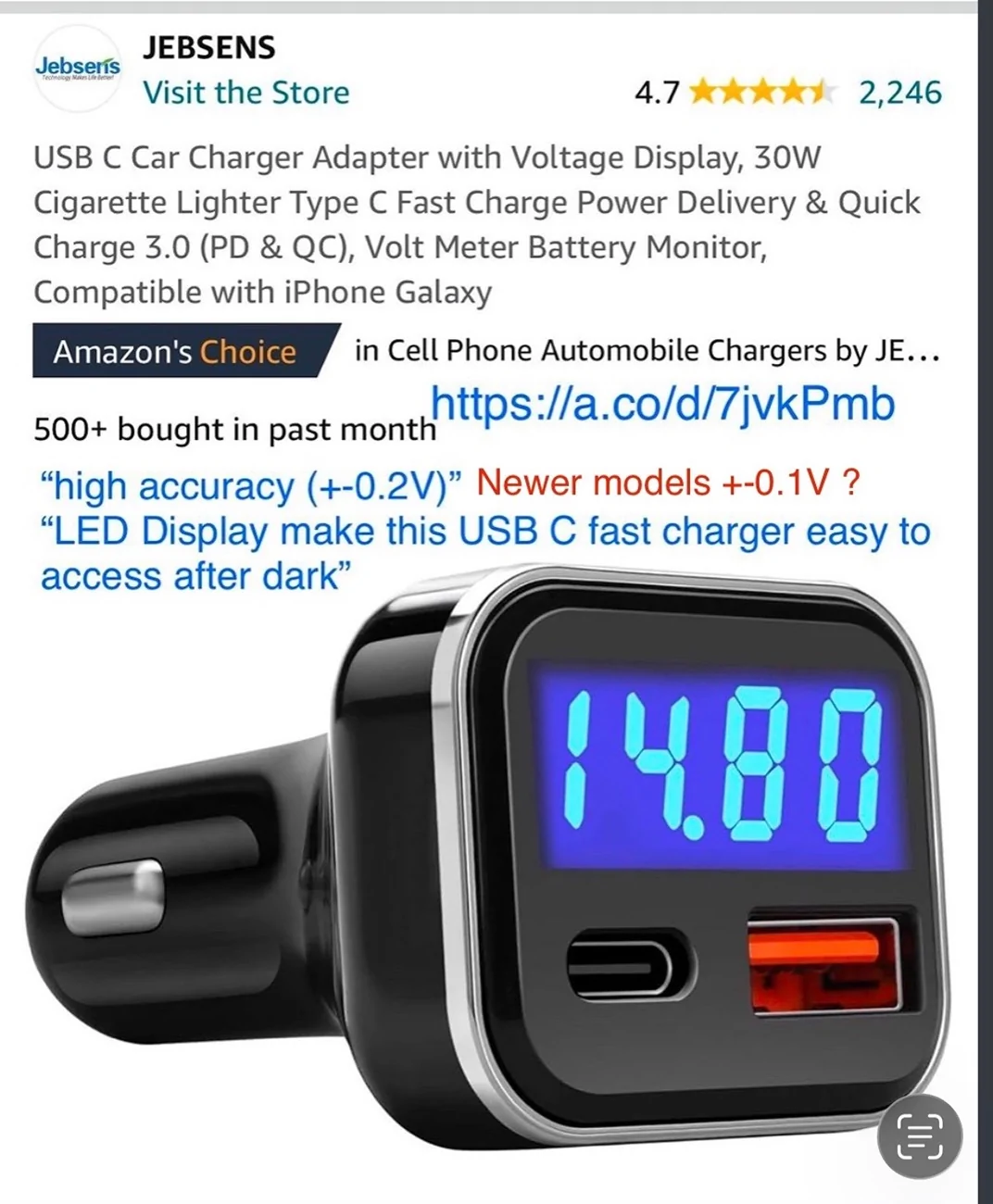

there are various devices you can use to check the health of your battery including Bluetooth devices but I like this simple 12V meter you plug into the 12V port in the center console, you can keep tabs on the battery voltage in real time when you are driving - pretty easy to see the alternator is always (or almost always) charging the battery no matter how much you are driving in which case the auto stop/start will be disabled - and could be a good indication your battery is close to failing
