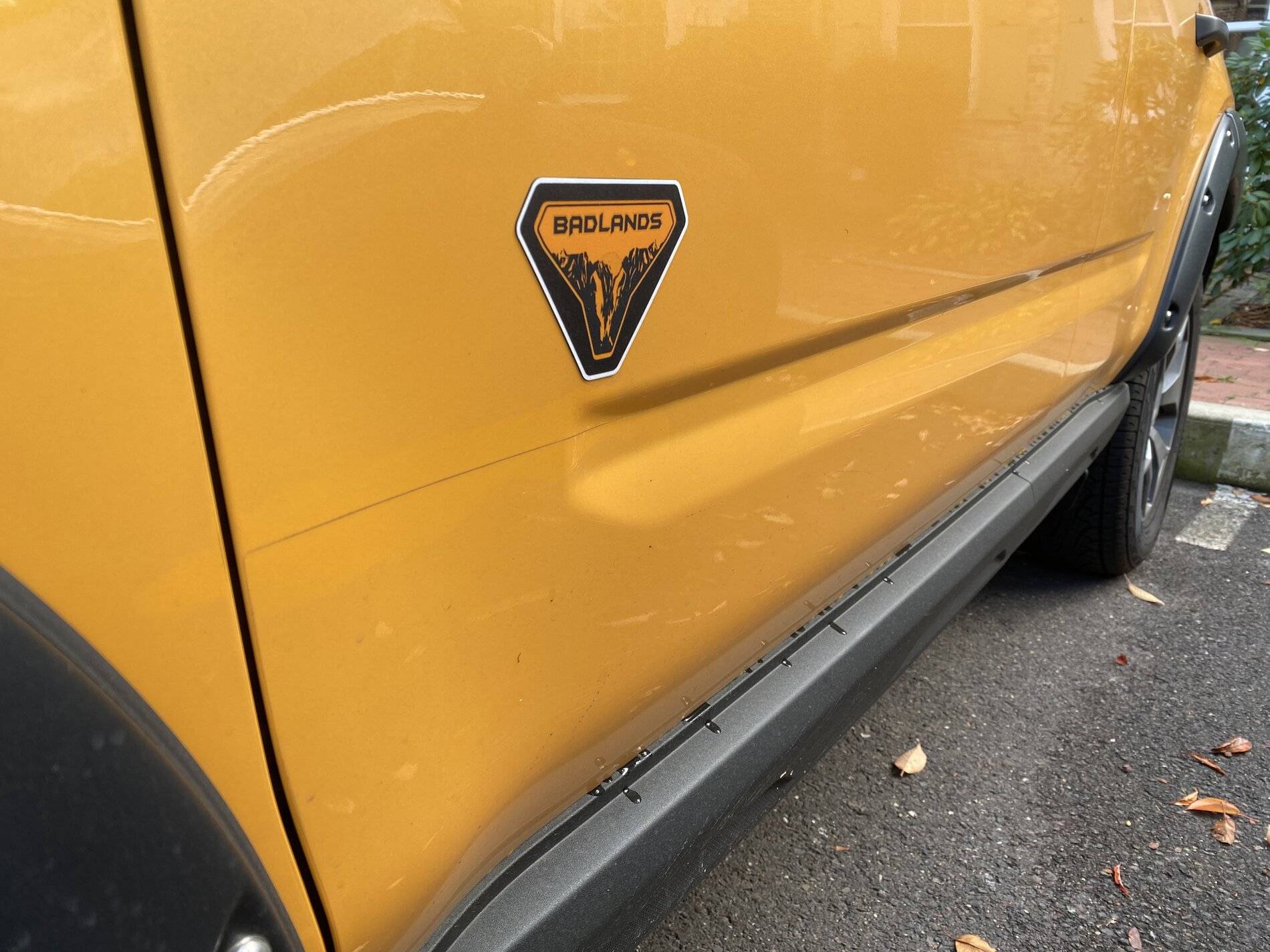

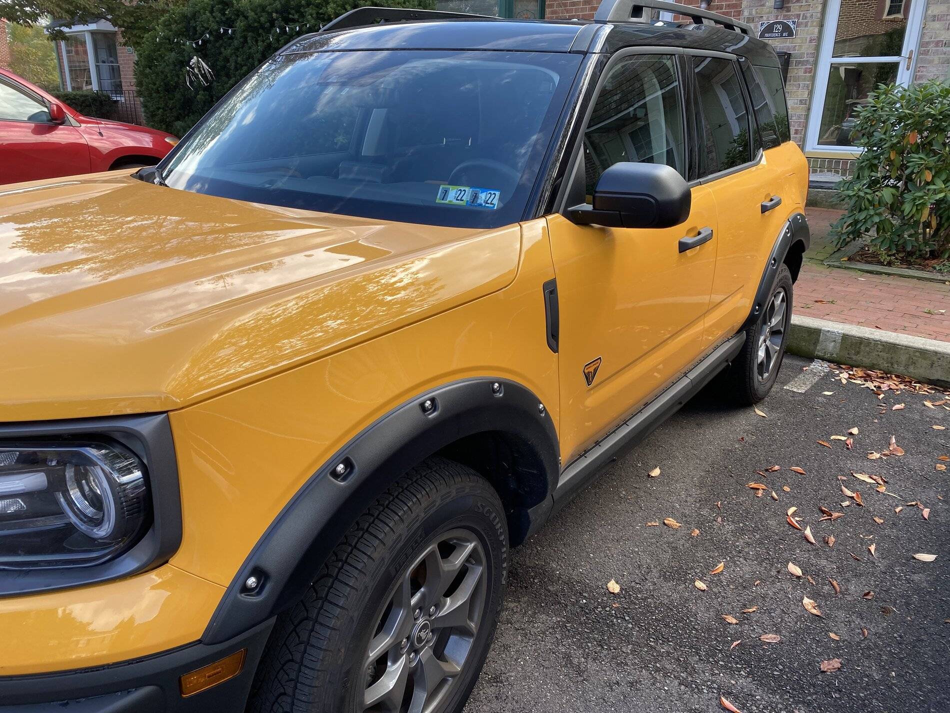

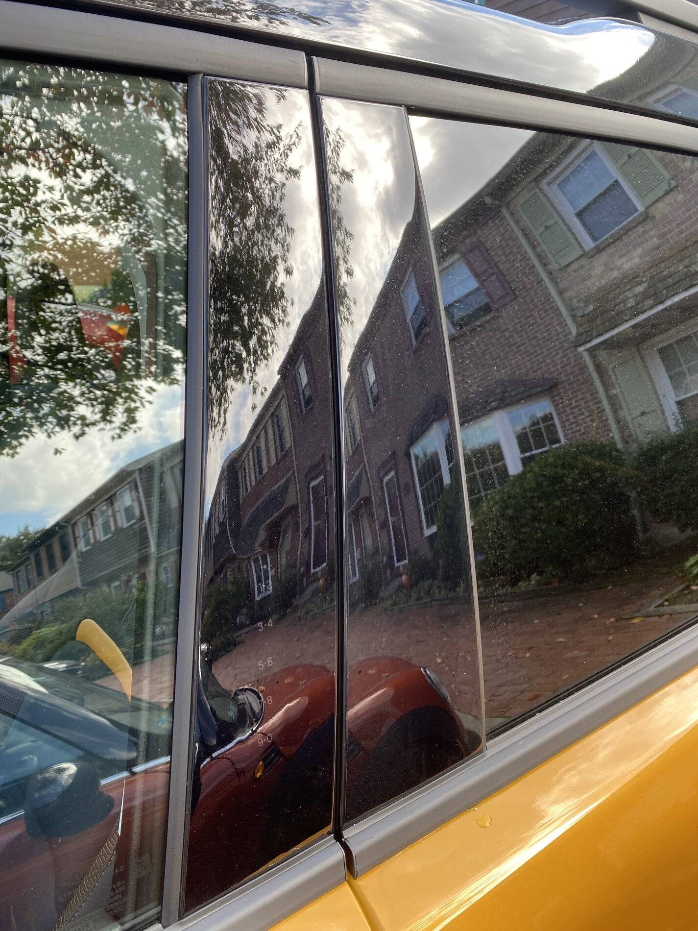

We had XPEL professionally installed. We had the entire front end, the bottom of the doors on both sides, and the installer did our B-Pillers for free with some of the leftover pieces. (I rubbed some dirt at the edge of the door panel pieces so you can see where it stops. They typically can’t be seen.)
Total job was around $1,400.
