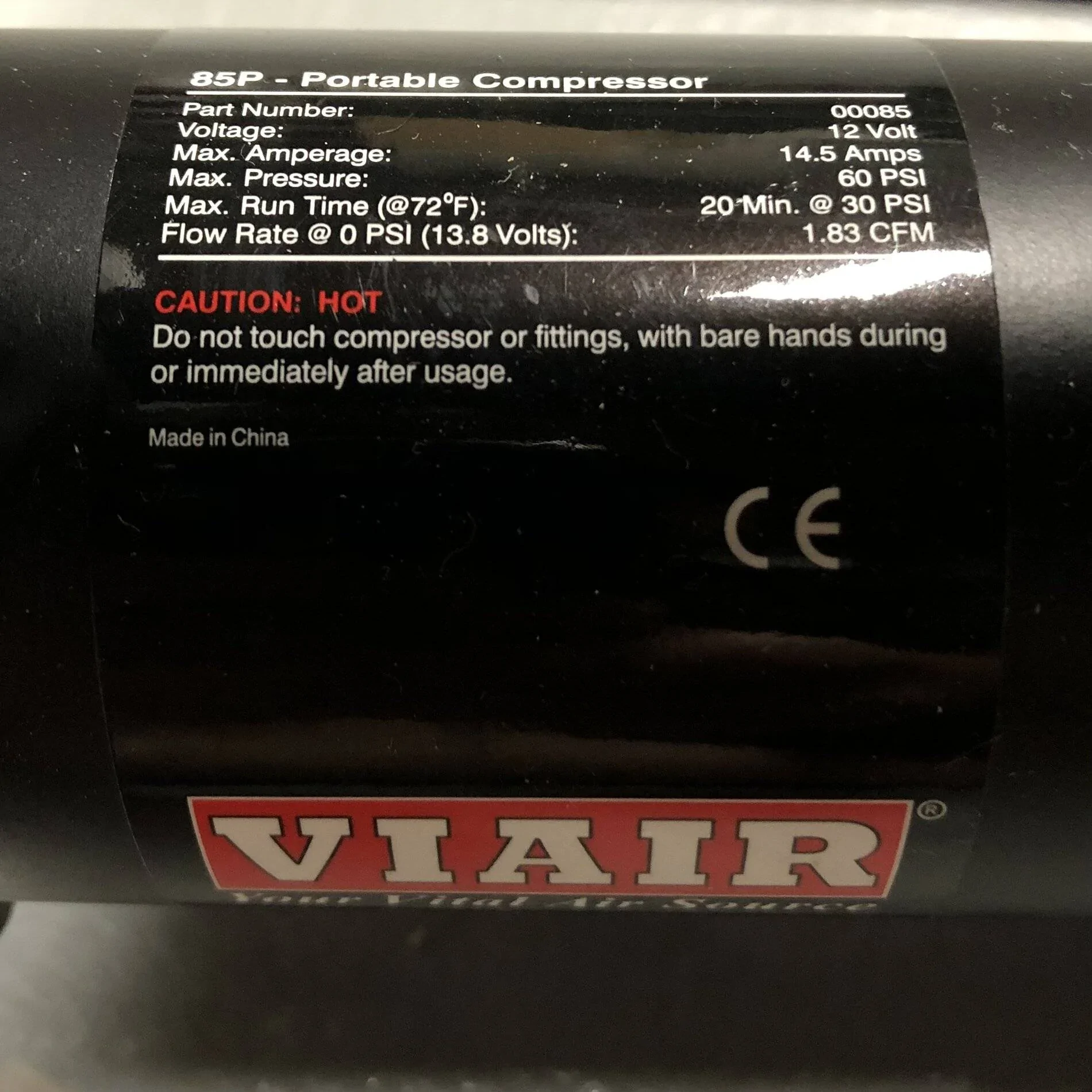

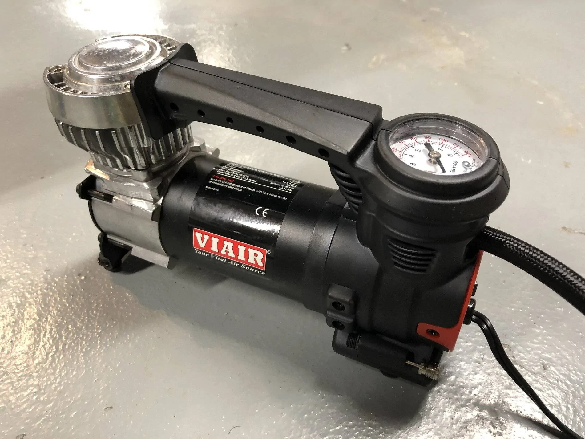

I’ve got an viair 85P that I picked up for a previous vehicle that didn’t have a spare. It came with a can of fix a flat. It always worked great for keeping things properly inflated but I’ve never used it to do a full air up on four tires. Its label says maximum run time is 20 minutes at 72 degrees and 30 PSI. Probably under spec but I already have it so I’ll give it a whirl (assuming my Badlands ever gets built)

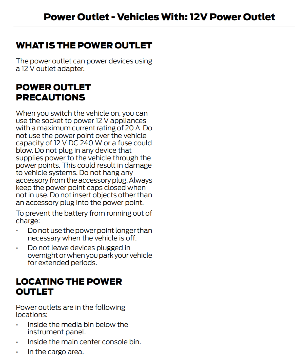

from the owners manual, the 12V power outlets are all rated at 20 amps

If you look at the second picture on the label it says not to use it for than 10 minutes continuously. If you use it for 10 minutes give it 15 to cool down. With my flat from 5psi to 33psi took about 3-4 minutes. If you set all tires to 18psi it could 'probably' bring them back up to 33psi in one attempt. You will have a little bit of cool down between tires. Was just throwing out another option.
