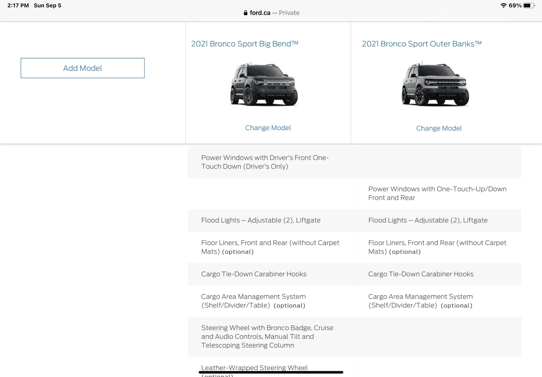

Does anybody know if its possible to add the one touch roll down to the drivers window? My wife's bronco sport has the one touch down and I'd like to add the up feature if its just a few parts and computer flash.

Which model of Bronco Sport does your wife have?
I know the Outer Banks comes with one touch up and down on all four windows, but the Big Bend only has one touch down, Drivers front window only.

Yes its the big bend. I know it doesn't come with the one touch up; I would like to add it though if possible.
shouldn’t be any parts.. seems no one here has or figured out the forscan codes for these vehicles yet. It’s possible, just may need a little time before codes are available
Unfortunately, it's probably not doable via just a programming change. This is something I looked into with my Fiesta ST as the European models support one touch up/down on all windows (but the U.S. model is just one-touch up/down on the drivers-only) and Ford does typically use different drive motors as well as wiring and switch controls between the two options.
Doing a quick look at the service manual wiring diagrams for the Bronco Sport, it looks like this is also true for our vehicles as well.
