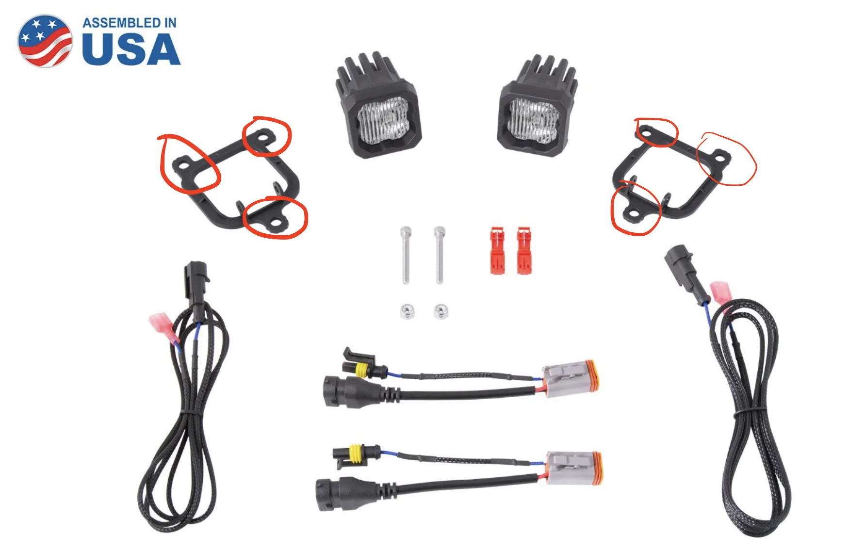

I have a 2025 Bronco Sport big bend with Black diamond offroad package.
It didnt come with fog lights and i would like to add the OE set. I can find the correct headlamp switch and the fog lights from the dealer and a set of brackets and screws.
Should the the wiring be there behind the bumper or is this a separate wiring harness? The dealer doesnt seem to have this answer.
I plan on other upgrades so would prefer not using the upfitter switches at this time.
Thanks

As per my previous post, the mounting brackets in that image that your circled would not fit my 2025 badlands (the new mounting pattern is more rectangular). But i can't speak to what you'll find in a big bend bumper.
