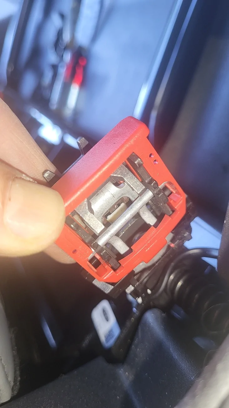

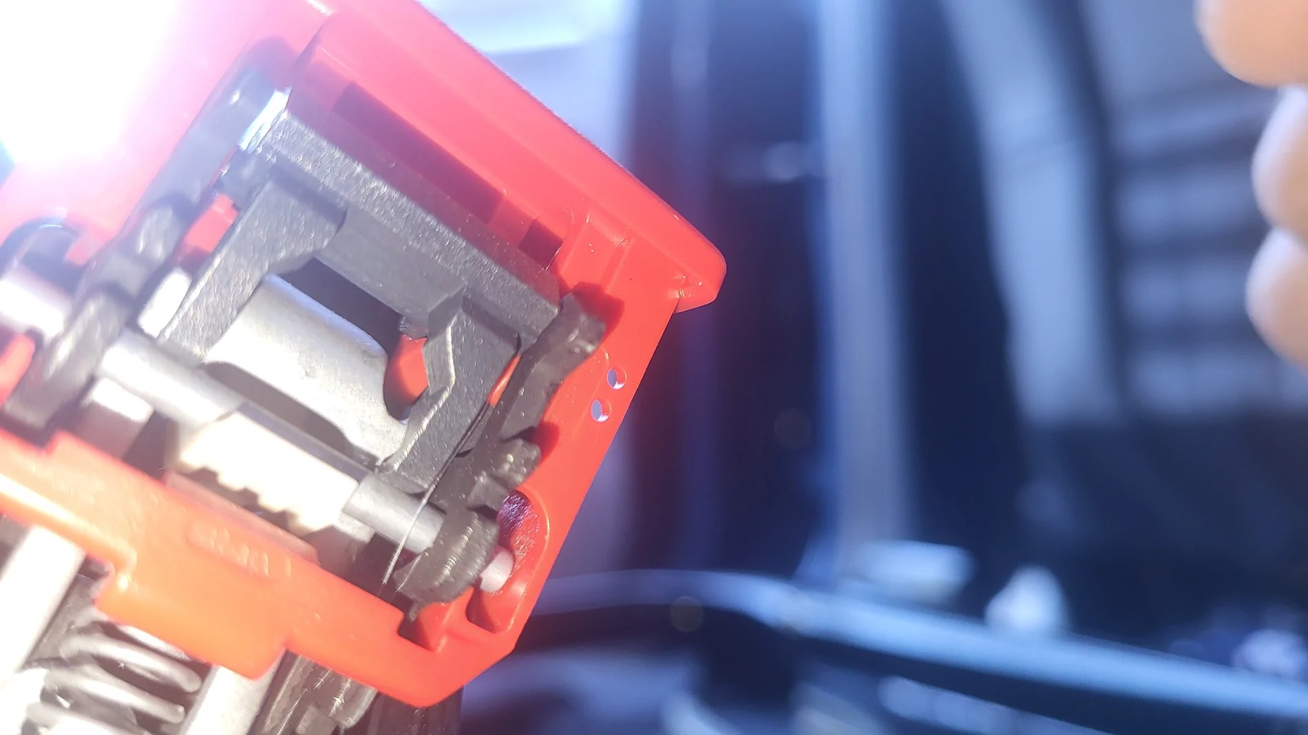

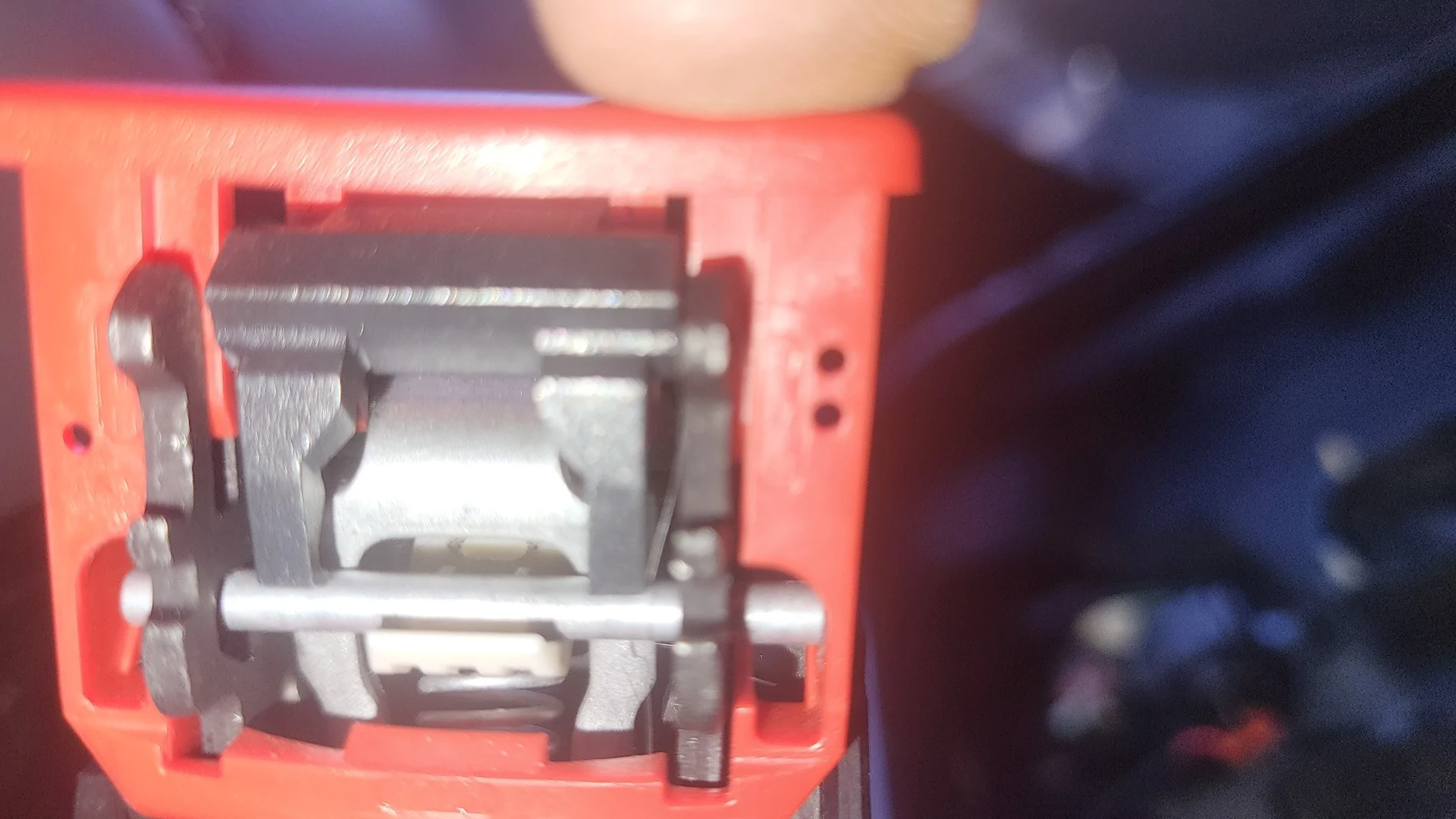

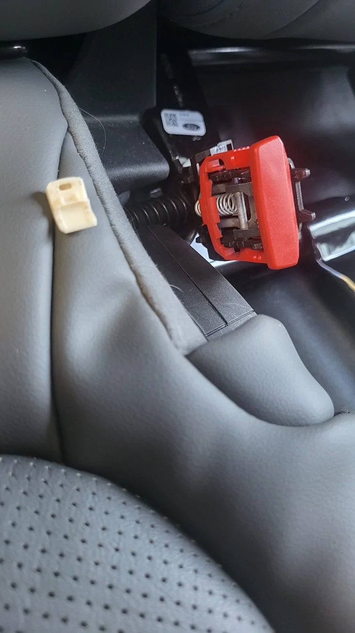

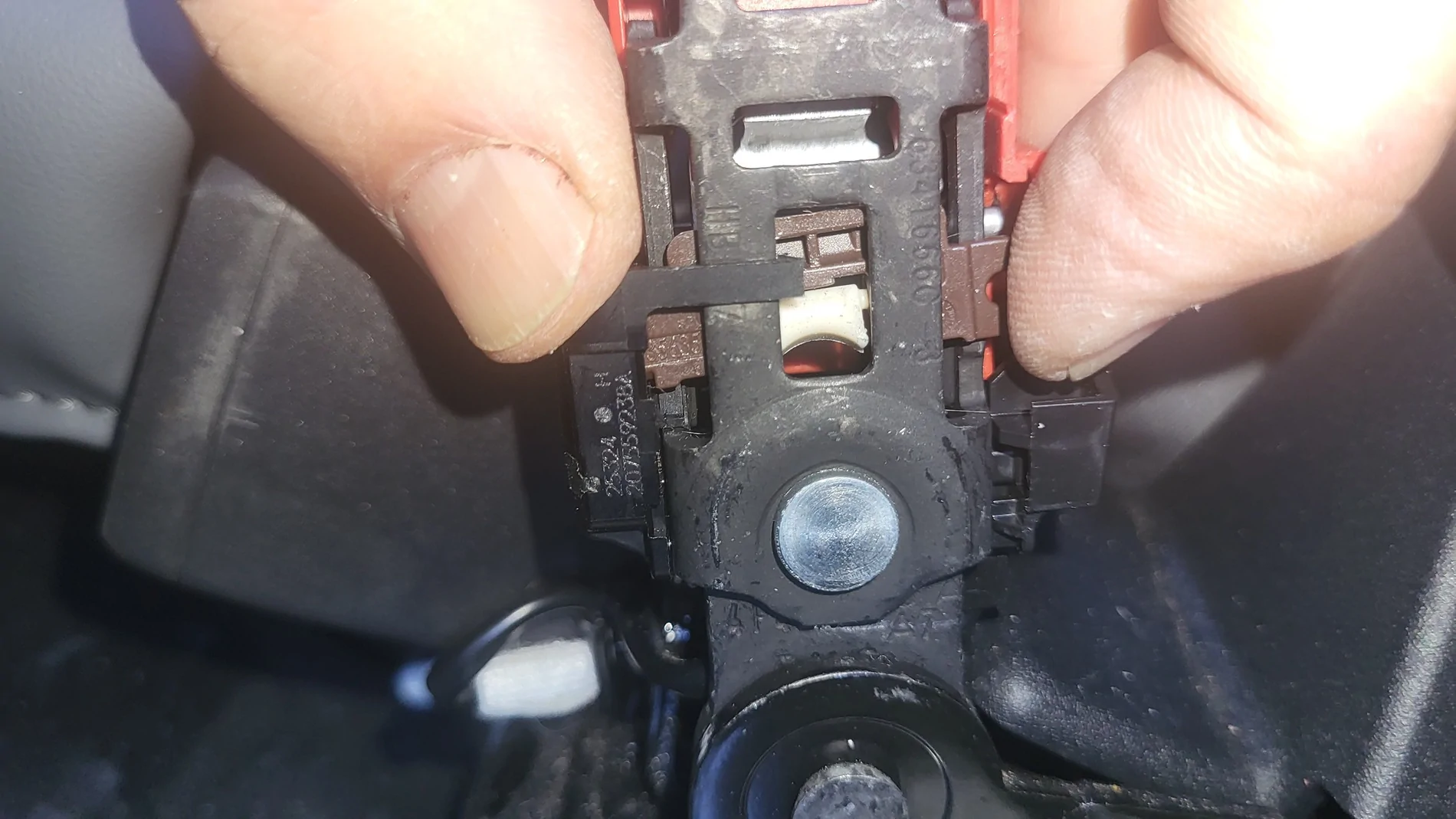

Well, I disassembled both buckles. Rear driver side turned out the tongue insert got bent severely and was bind up the buckle. Just used a flathead screw driver to help push the latch pawl back enough to release. The belt tongue was belt almost 45 degrees, and once straightened the buckle latched and released normally. The rear center buckle had a loose piece fall out when I disassembled the cover. Turned out an inner piece had broken on two. In the photos, its the white piece. The white piece is attached to the trigger that the belt tongue pushes down, which also activated the micro-switch for the seat belt sensor (medium brown colored price in the photo).
Guess I'll make a compliant with Ford, and spend the hundreds of dollars to buy a replacement.

Here's what the "good" buckle looks like. Notice the white piece reaches under the metal pin... the rear center buckle broke the white piece here (brike off at the metal pin).
