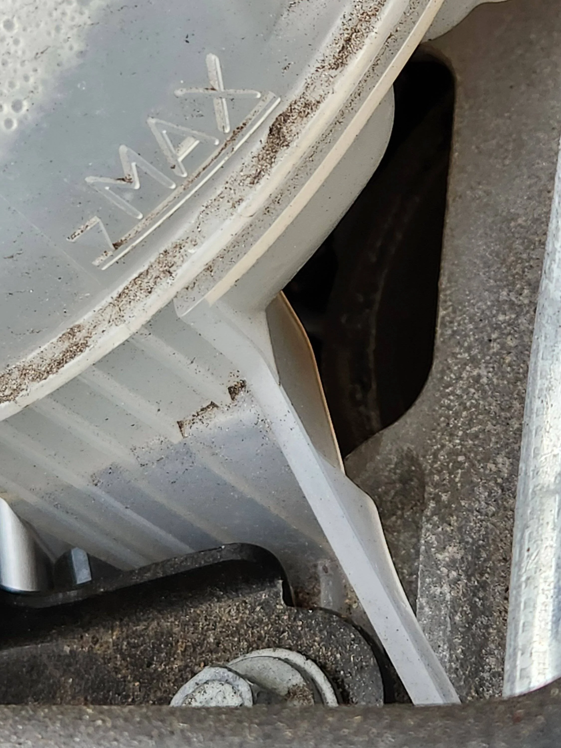

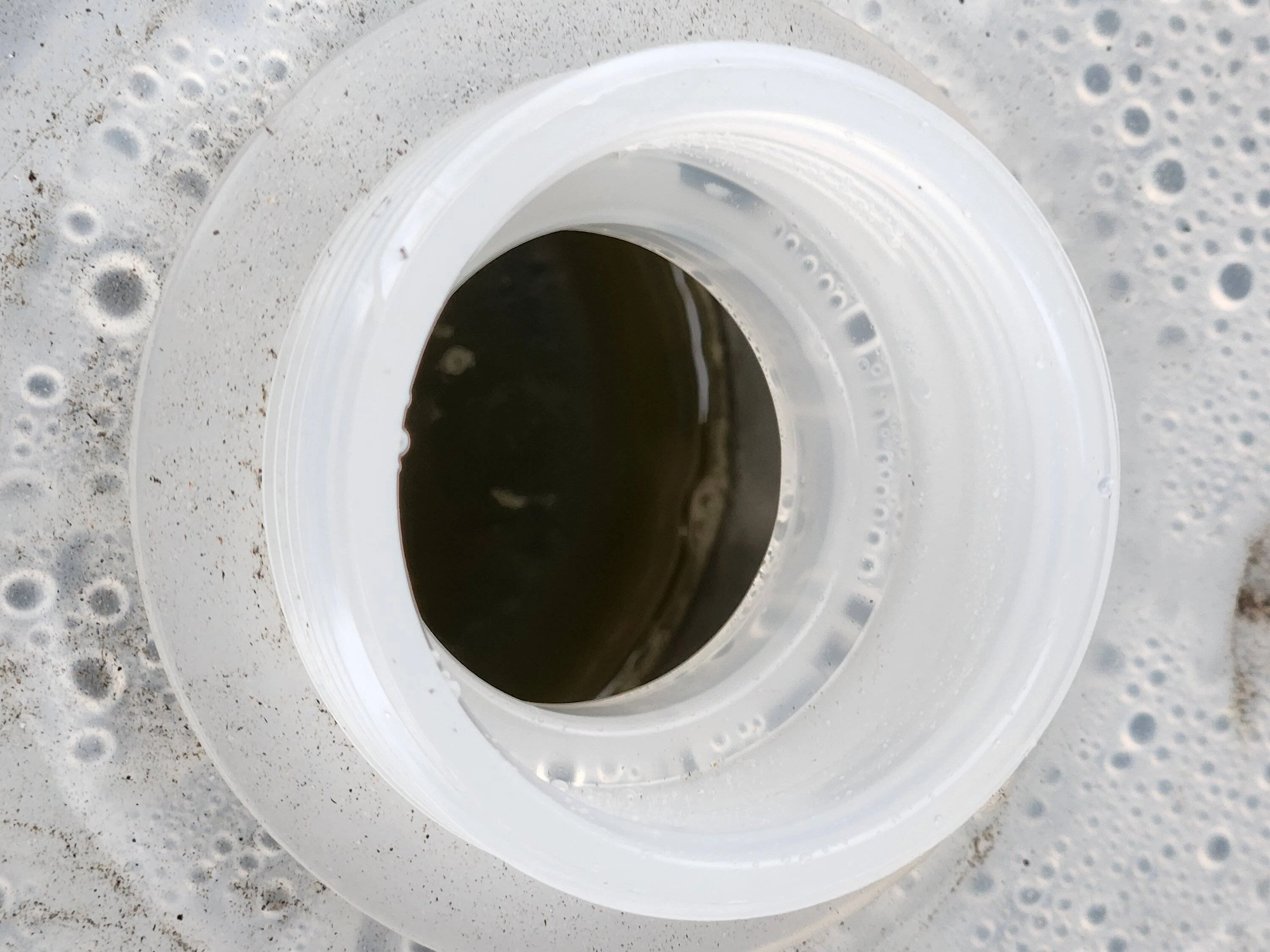

I noticed the leak last week Thursday 20th. Make appointment For Friday 27th. It was low but not terrible, but low. Sunday 23 it just above the tube leading down fromthe reservoir. Topped it off 3/4 between min/max. By Thursday 27th night when i dropped it off the reservoir was bone dry. I am not sure how long I had the leak, because I was checking my wiper nozzle when I noticed rhe reservoir was below min on the 20th. From this Sunday, to Thursday night the reservoir went from reccomended to empty. Pic was Sunday before fill.

Wow that is a huge loss in a short time. Very surprising the dealership can’t find where it’s going. It’s almost like you could watch the level drop but it’s not quite that fast.

They said they put the pressure test on and watched the pressure and coolant go bye bye, but checked everything. They scopped all 4 cylinders, all hoses, water pump, no idea where its going. 0 evidence of any leak past the head gasket, no evidence of burning. No drips, no smoke, no smell maybe its going to where lost socks go. But when he said bone dry Thursday night I was like jesus. And they have no loaner cars to give, and ford wont get me a rental until they find the source of the leak to determine if it is warranty 31.5k, 2 years 11 months old.
