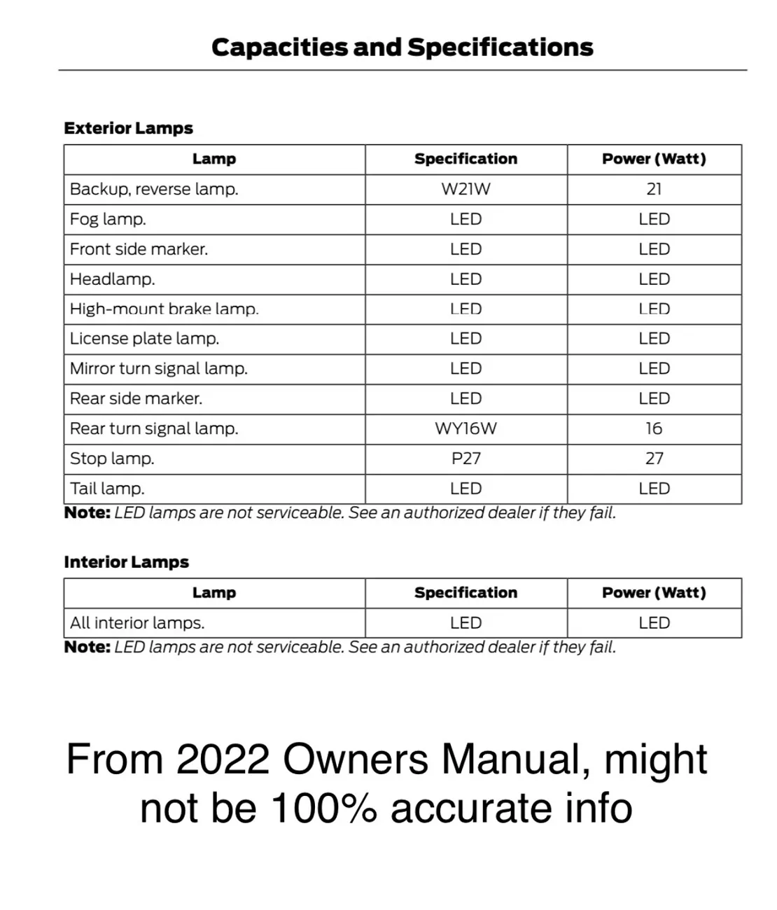

2022 Big Bend. I got the rapid turn indicator on the passenger side about 10 days ago. Looked at the blinkers, they were both fine. It seriously took me 5 minutes of scratching my head to figure out that it was the fog lamp not turning on once the indicator had been activated. Okay, no big deal, right? Ordered a new fog lamp from amazon. Original Ford part arrived 2 days ago. Installed and tested. When I click the button for the fog lights directly, the bulb comes on. When I activate the turn signal, no fog light plus rapid indicator in cab. (exterior turn signals operate as usual though.)
I do not have forscan, but I do have a stage 2 obd scanner. Any ideas?
