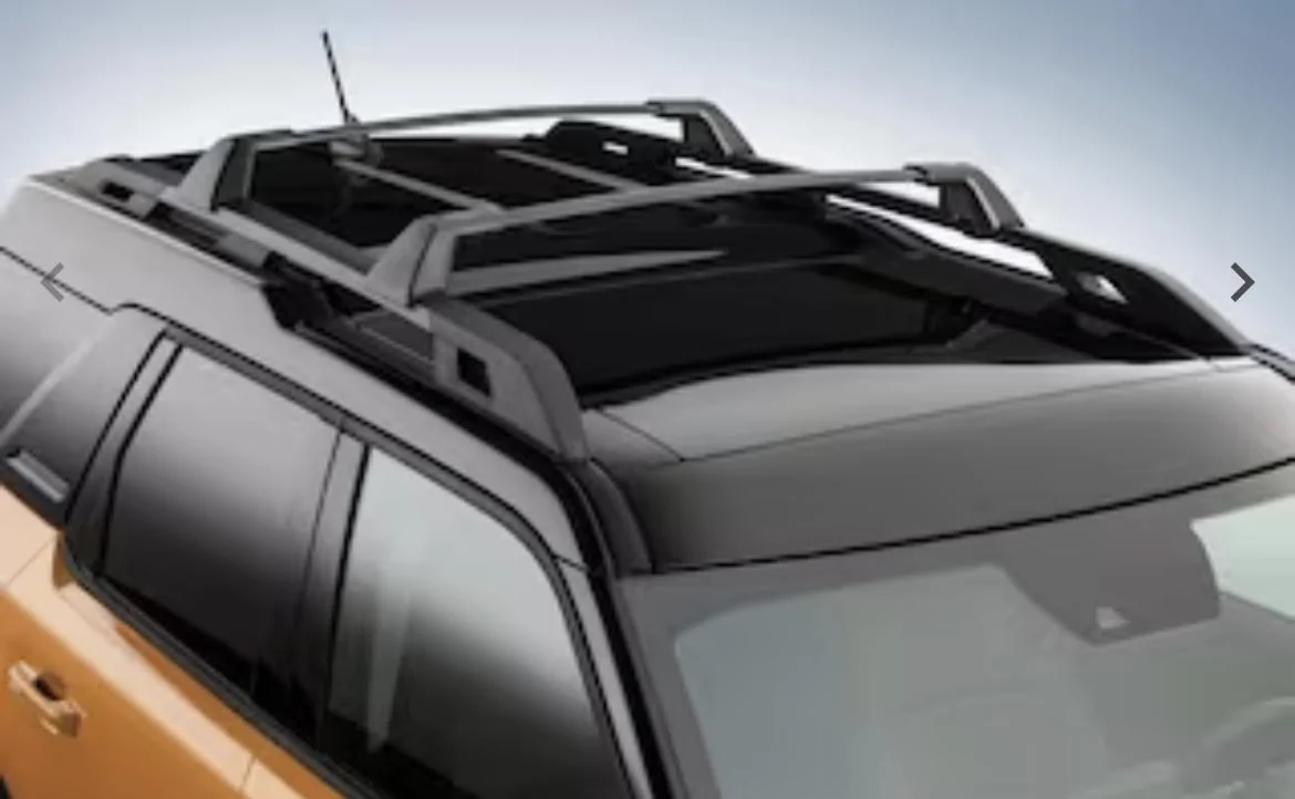

Hello,
A year or so I upgraded from a 2021 outerbanks to a 2021 badlands and ended up with a set of OEM cross rails from the outerbanks.
I ended up selling them to someone who has a 2022 outerbanks, as it had said in the part description on ford's site it would fit 2021-2023 ( this link no longer exists)
But the person I sold them too said they don't fit.
Are the rails on the 2022 outerbanks a different shape/size than the 2021??
Thanks

Inform the customer that there is a front and back bar . They must be exact.

Yes they are different. For 2023 model year, OB adopted the BL off-road style cross bars.

If you remove the rubber pad/bushings, they will fit a 2022.
