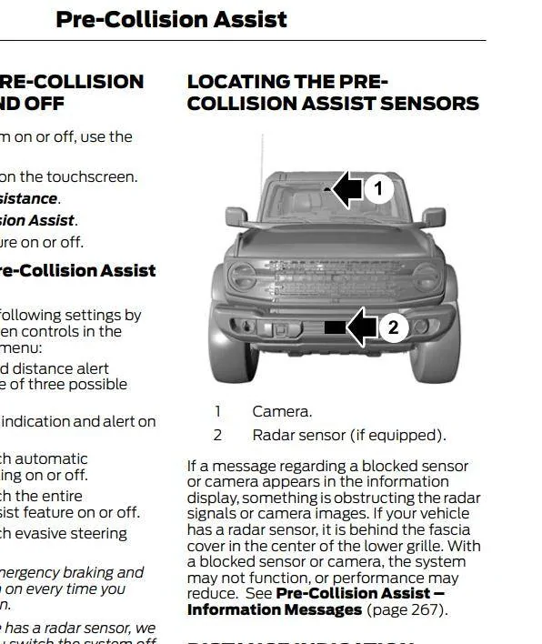

Any ideas ? My car has UNIT #1 , not radar sensor Unit #2 - see below ....
Ford Bronco Sport 2021 Bronco Sport Pre-Collision not working ? 1741135382476-q3
Ford Bronco Sport 2021 Bronco Sport Pre-Collision not working ? 1741135368644-po

Odd that the owners manual pics show the full size Bronco
But is similar locations for the BS being depicted

If there's no errors, the system is probably working as well as it can solely being based on vision.
Vision requires machine learning to have models that identify what an object is, approximate distance, etc... however, it's dependent on the quality of the input.
A major downside of a camera only approach (the same approach that Tesla uses with multiple cameras on their cars ADAS functionality) is that they can fail to recognize objects as what they are and thus can go careening straight into, say, a semi truck that has flipped over.
If you had the Copilot 360+ with the adaptive cruise control, then you have the secondary input of the radar sensor with the camera. The radar can detect solid objects in front of you, and for vehicles, how quickly they are moving. Even if the camera cannot recognize the object (unusual conditions, too dark, rain/snow/sleet, sun shining in the camera washing out the image), radar would still detect a potential collision in front of you.
Better than nothing, but a camera only approach will never be perfect...
