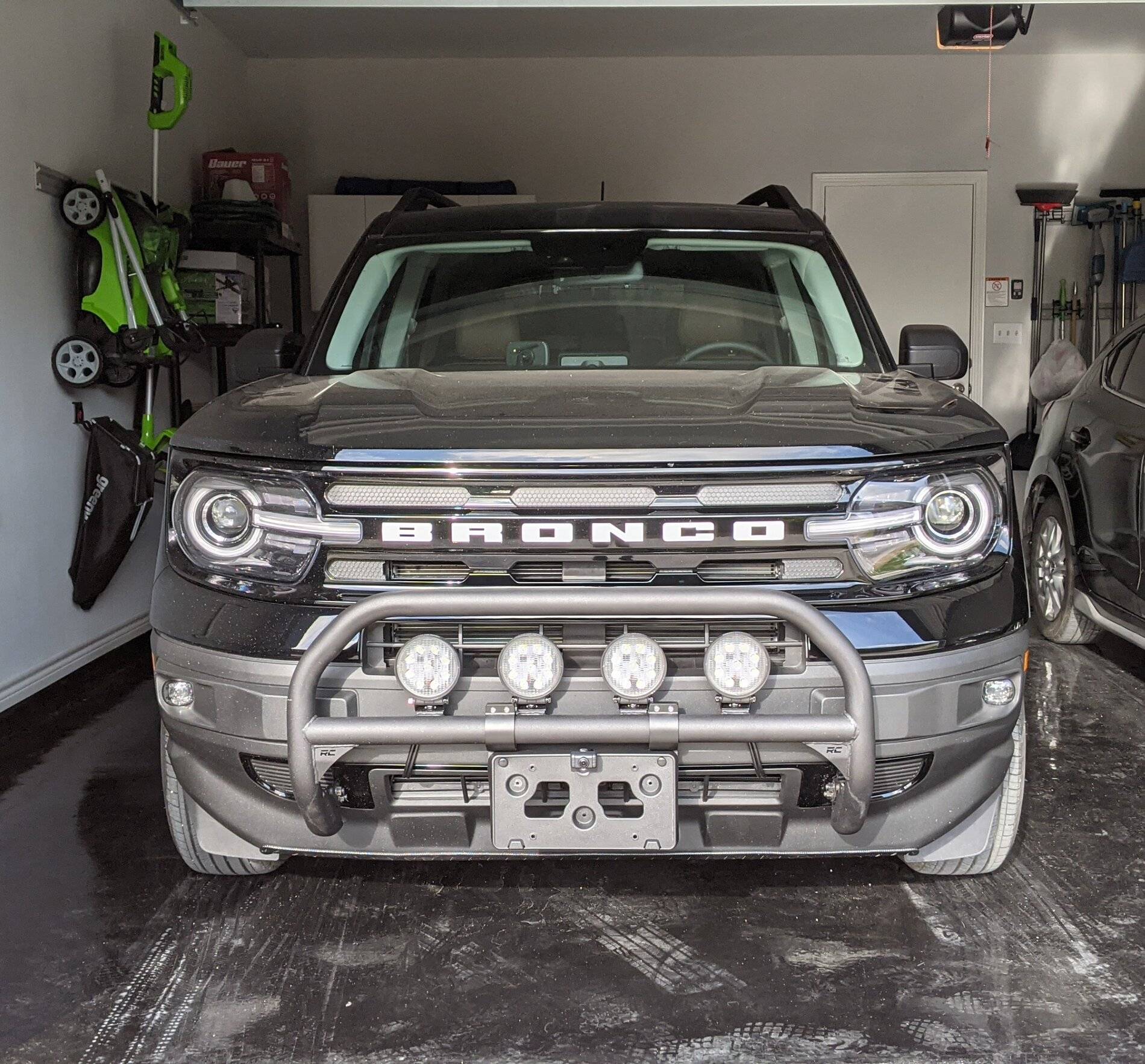

looks great! i've been eyeing the bumper lightbar from rough country myself. where do you have the switch?

The switch is under under the other light switches on the left driver side. I went through the wire access grommet behind the battery to get the wires inside the cabin

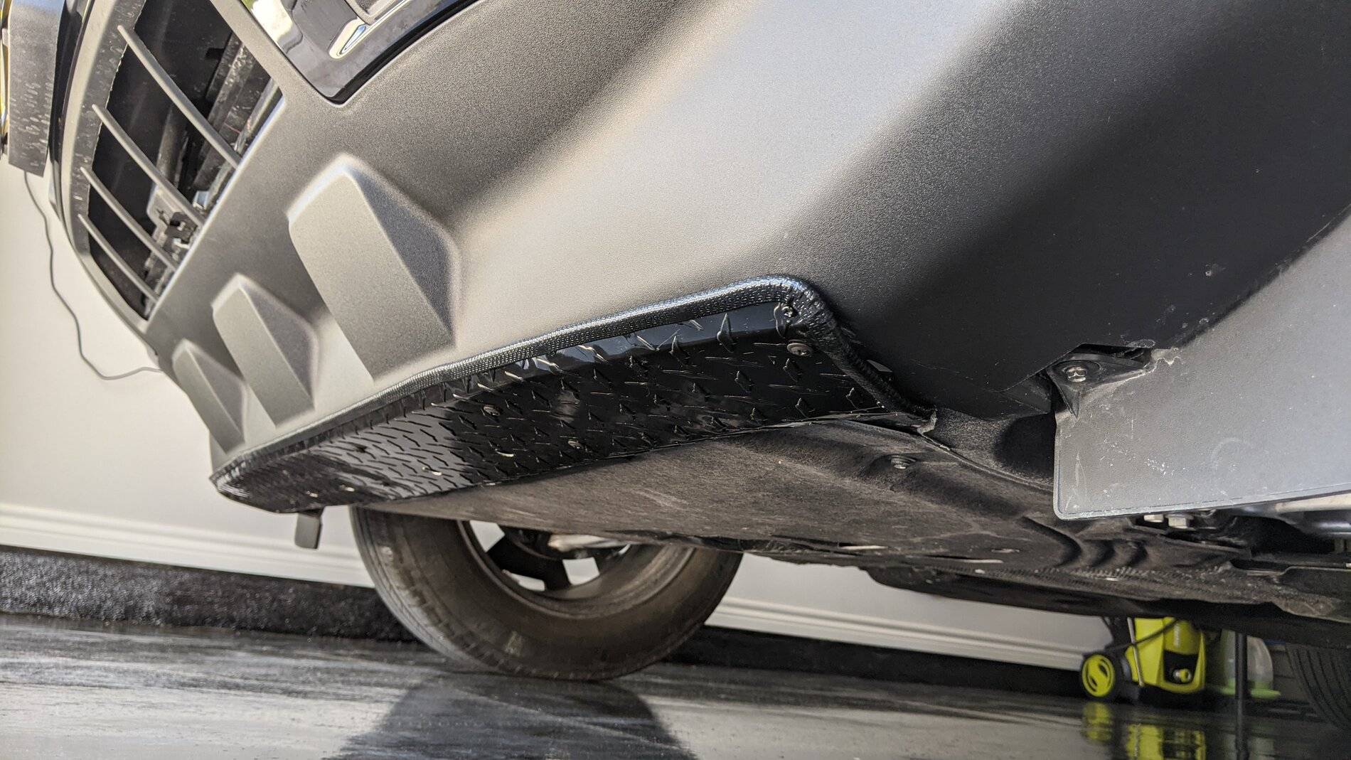

I added threded inserts to the bottom of the bumper and used bolts to attach it. It also has holes allowing access to the original bolts under attaching the bumper to the car. So the the bumper can be removed without removing the skid plate

I just got my bar/ lights. Do you have to remove bumper for install? How is routing, light switch located? Thanks for info.

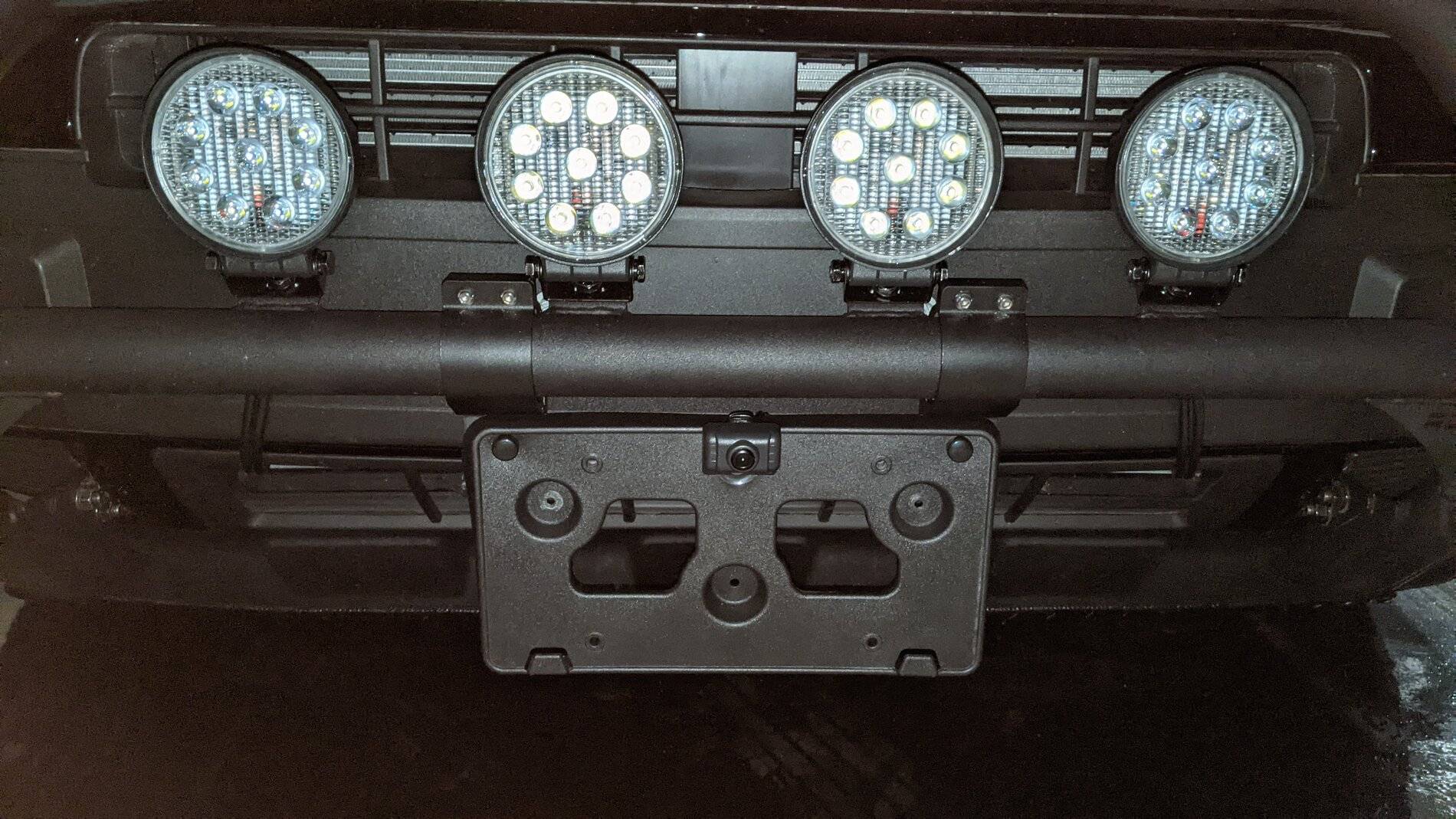

The bumper has to be removed and lighting is routed before you put the bumper back on. The switch gets routed through the firewall access point behind the battery to inside

10-4 I'm considering getting the R/C switch cluster for the various components vs having multiple switches drill points.
