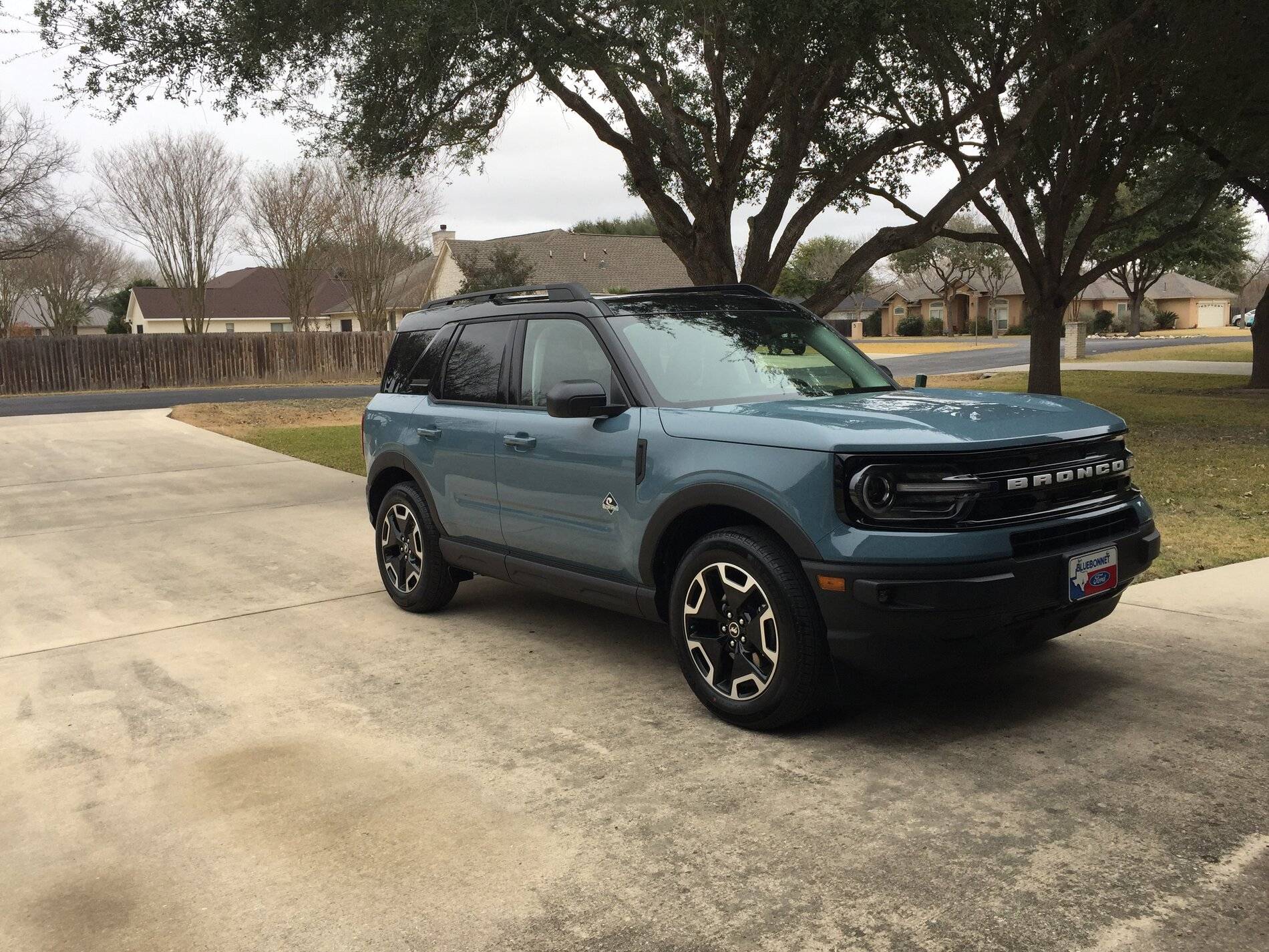

Thinking of getting a Toyo Open Country ATIII or similar tire put on our new BS today, and wondering if anyone knows what the absolute biggest that can go on with no lift and no rubbing? Thinking about a 235 65 R18. I have seen one other here do it successfully.
Anyone else?.
245 60 R/18?????
Thanks for the input!

Please keep us updated on this. Several also have done 245/65/17 but I haven’t seen anyone try the stock 18 rims yet.

Here's a pic of my stock 18" wheels with Goodyear Wrangler Trailrunner 235/60R18 tires. They're not much larger and fit just fine.
Ford Bronco Sport New AT tires on stock 18” Outer Banks wheels? IMG_0308
I did, however, decided to change the wheels, so here's a pic with the KMC 721 Alpines in Satin Gray.
Ford Bronco Sport New AT tires on stock 18” Outer Banks wheels? IMG_0331

So who did 235/65/18 and did you ever have troubles? I'm leaning towards that over 245/60/18 for the extra height.
I did 235/65/18 Toyo AT3 on my OB and I don't have any trouble with them...naturally MPG will go down a little but other then that, I didn't have to trim or nothing!
I feel like 245's will scrub, but I haven't seen anyone attempt to do it.
