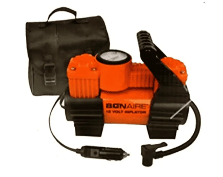

2022 Badlands here... I have a small 12 volt Bonaire tire pump (see below) that I've had for several years. (Home Dept around $39) It's fed by a long cable that plugs into a 12 volt outlet. I have no idea what it's output is, but it's not much. Of course in my Badlands, I have both 12V and A/C outlets in the rear. I will certainly never have giant 33, 35 or 37 inch tires, so I do not need a monster air pump but would like one with a little more power, but still reasonably compact. Any suggestions?

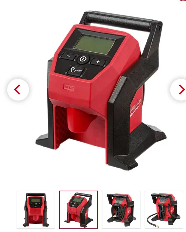

Milwaukee M12 compressor, tiny and powerful. Set your psi on the screen and it inflates to that pressure!

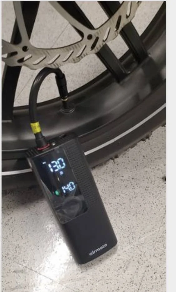

I’ve got an Airmoto. Not my tire, but you get the idea.

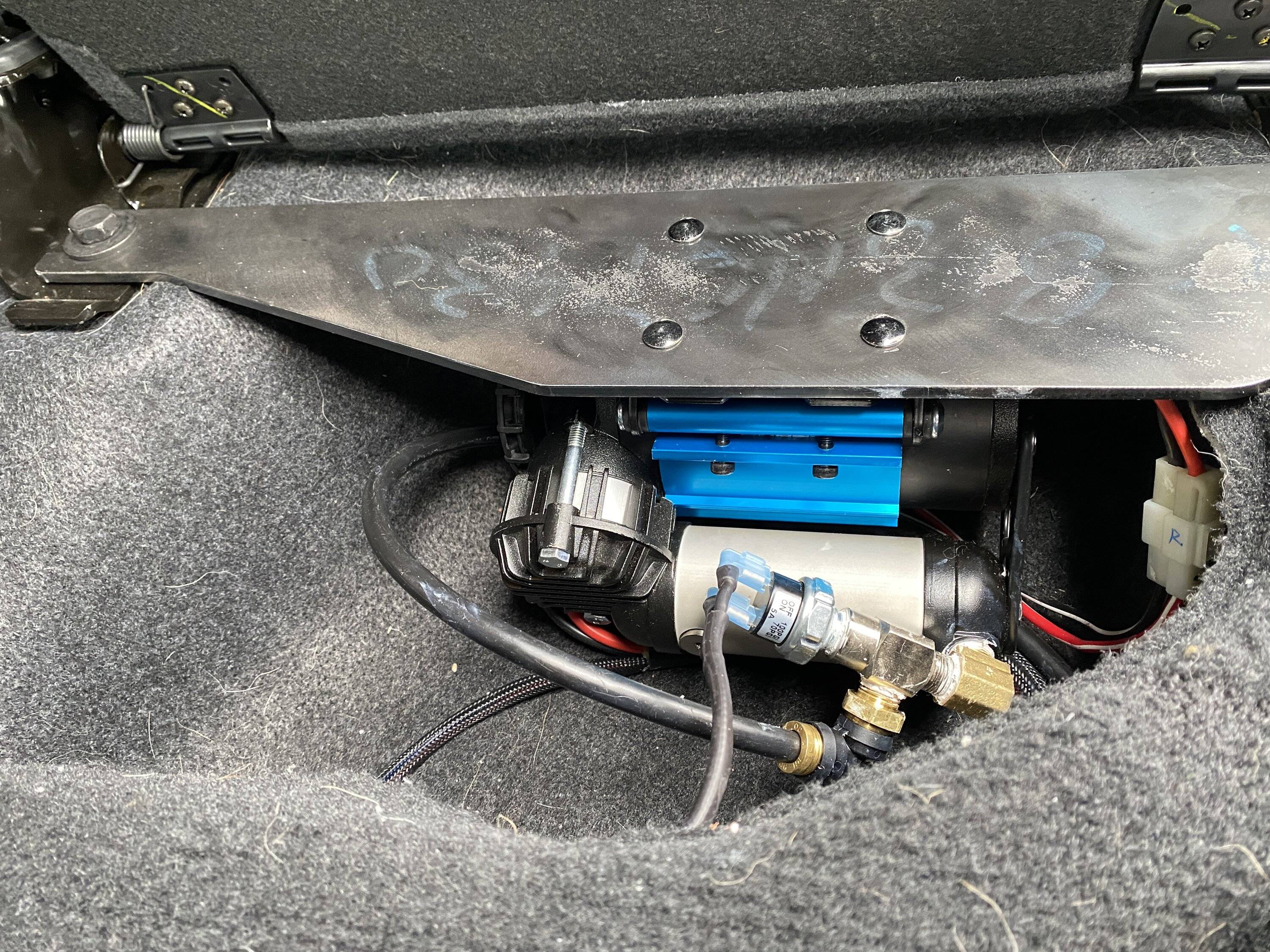

Whatever style you're interested in, look for short power leads and a long hose rather than long leads and a short hose. It's more efficient to compress a long hose and maintain that pressure than it is for electricity to flow through a long cord. Heavy gauge wire will also help reduce power losses through the leads.
I hard-mounted an ARB single in the engine bay and just carry a coiled hose. But to do so I had to fab a mounting plate. ARB offers this same compressor in a "portable" kit but I don't think it's very compact. It comes in what looks like a toolbox.

I have this same compressor in my truck. It’s pretty quick to air up my 35s…might be overkill for BS-sized tires though, but it will fill them fast and easily. Most people forget/ignore duty cycles for compressors and overwork them. Many are like 10min on/20min off. The ARB single is 30min on/ 30 off.
Exactly this. People use those el cheapo 12V oulet compressors for 20+ minutes straight. That's a good way to melt your compressor before you're done using it.
The ARB single is certainly overkill for our small tires, but it gets the job done fast and I don't have to worry about duty cycle. Which is great when you don't have signal, you're several hours worth of walking from the nearest human, and it's over 100°F (I put the ARB in before spending a week in the Chihuahuan Desert).

Where did got the brackets?
I fabricated a mounting plate from sheet steel and used the mounting bracket that came with the compressor. I used M6 rivnuts and bolts to install the mounting plate in the fender.

Actually, that looks nice for bikes! Assume it works well?
I bought it for convenience and size. It is rechargeable and can fit in the glove box or in the spare well with my other stuff. Puts out a decent amount of pressure and reading is easy to see and understand. Pricey compared to some, but I like how the hose is self contained in the body, until you need it. Doesn’t get caught on anything. It’s also heavy enough to be used in self defense. A brick in the hand, so to speak.
