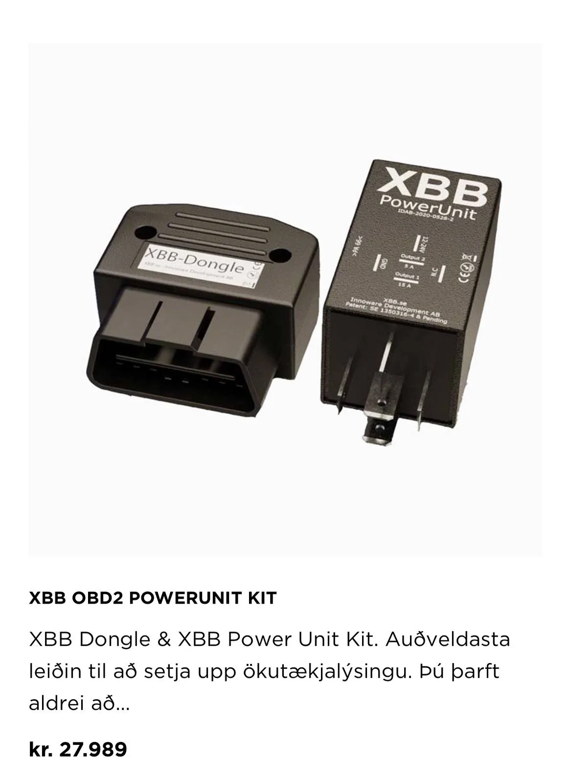

Hi all
I have been trying to let my off road light wor with the high beams and try lots of stuff for long time now and have found a nice solution it’s called XBB Power unit kit
it’s easy install just change relly in your off road harness and put another plug in your obd , get XBB app in your phone then pick Ford Explorer , pick high beams signal then save , then your off road lights should work with high beams lights.

Do they always work with high beams? Or is there a way to use high beams without the off road lights? I’ve had the need for high beams without the need for off road lights

Yes you can turn it off in the app , I haven’t found a way to use them with switch board like auxbeam ? maybe it should go in output 2 the switch board , yes i think so

You can enable that via software with forscan.

Looks interesting. I have been wanting to integrate lights that can be programmed to come on with the high beams and the auto-high beams, but interrupt that circuit if necessary with a switch for manual control. I wouldn't want a cop to see the auto-high beams with A Pillar Lights as well :cwl:

A normally closed relay with a switch to disable the lights you want to disable would work
