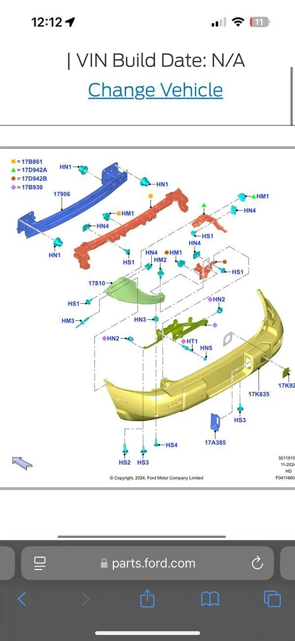

Ford Bronco Sport 2025 Rear Bumper Retrofit Research IMG_4453

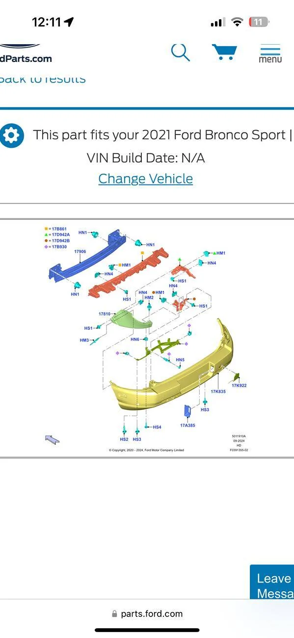

this is the 2021 rear bumper for comparison
Ford Bronco Sport 2025 Rear Bumper Retrofit Research IMG_4454
This is the 2025 “HEAVY Duty” rear bumper.
Off the bat it’s excellent to see that everything should bolt up the same. There don’t appear to have been any changes to the subframe it all bolts to (17906). The large orange bracket is different, but everything else (including the screw holes in the top of the bumper) appear the be the same. At the very least technically it should bolt right up!

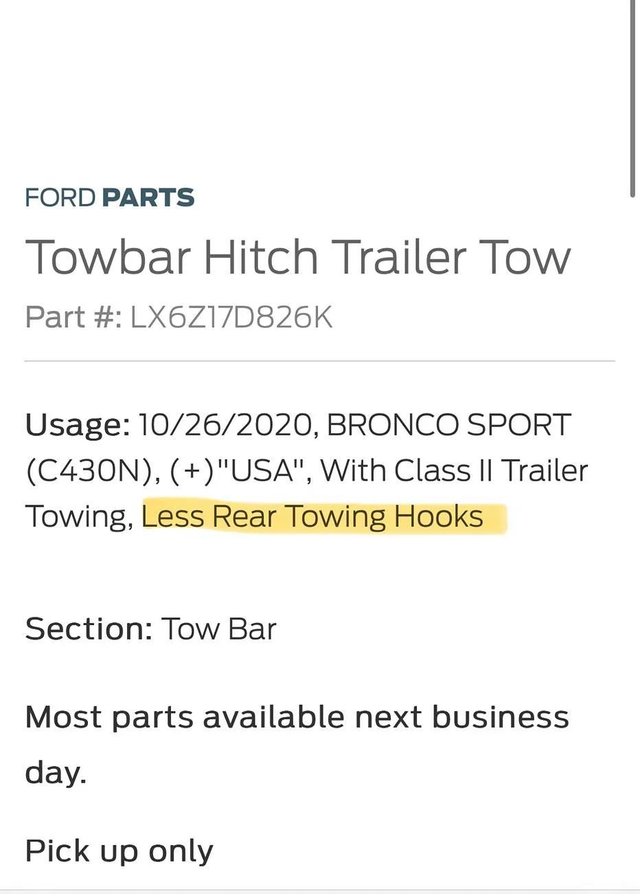

Ford Bronco Sport 2025 Rear Bumper Retrofit Research IMG_4455
As we know, tow package is now standard on 25’s, so they’ve all got them. It’s actually the same part as the first gen. There is only one 25 tow bar on the parts page at the moment, and it specifically calls out “less rear tow hooks”. My thinking is that the tow points are a part of a new tow bar assembly, and protrudes through the rear bumper when optioned.
This would make sense, given that if you DONT have the rear hooks then the rear tow hitch with an adapter is rated for recovery.

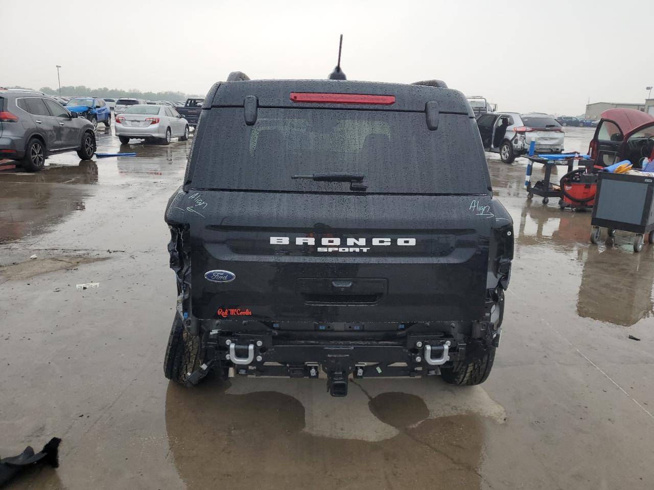

FINALLY got a shot of a 2025 with the rear bumper off; it does indeed look like the rear tow hooks are bolted to the tow bar, which is in turn bolted to the frame (they’re probably actually the same bolts sandwiching the entire thing to the frame).
Ford Bronco Sport 2025 Rear Bumper Retrofit Research 51549295_Image_
This tracks given that the rear crash bar has always been boron steel bolted to the frame or the tow bar sits in place of the crash bar and is recovery rated.
Two options here; swap the entire rear bumper, or just swap the tow bar and modify the existing bumper to fit the fascia for the tow hooks. Either way I’m fully confident this is an easy swap to get some rear built in hardpoints
