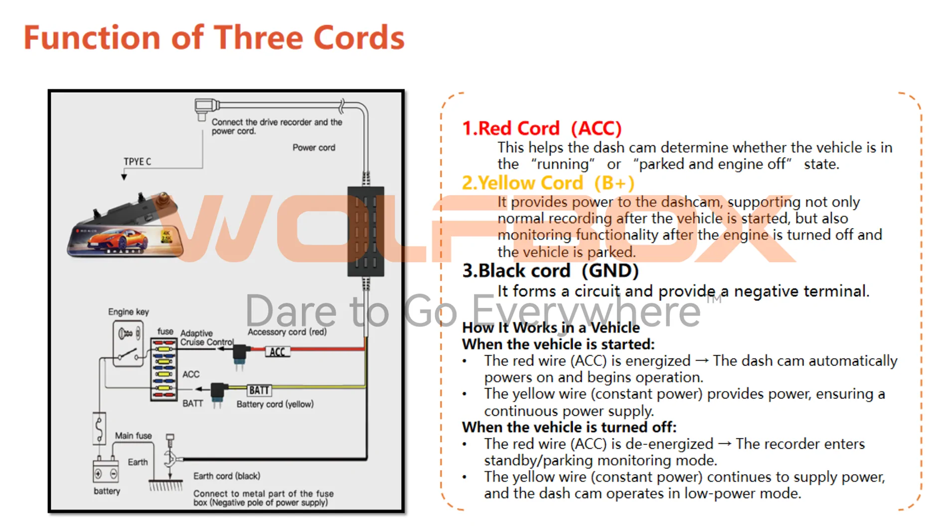

Welcome back to our Knowledge on Hardwire Kit and Installation series. Over the past few episodes, we’ve explored the basics of hardwire kits, including their functionality, importance, and detailed insights into voltage management. For those who may have missed the earlier parts, feel free to check them out to catch up on everything you need to know about hardwire kits!
Wolfbox: Knowledge on Hardwire Kit and Installation [Part 1]
Wolfbox: Knowledge on Hardwire Kit and Installation [Part 2]
Wolfbox: Knowledge on Hardwire Kit and Installation [Part 3 Video]
Wolfbox: Knowledge on Hardwire Kit and Installation [Part 4]

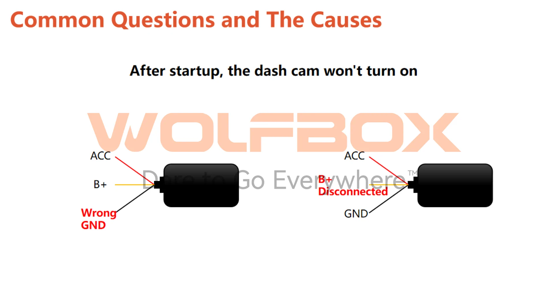

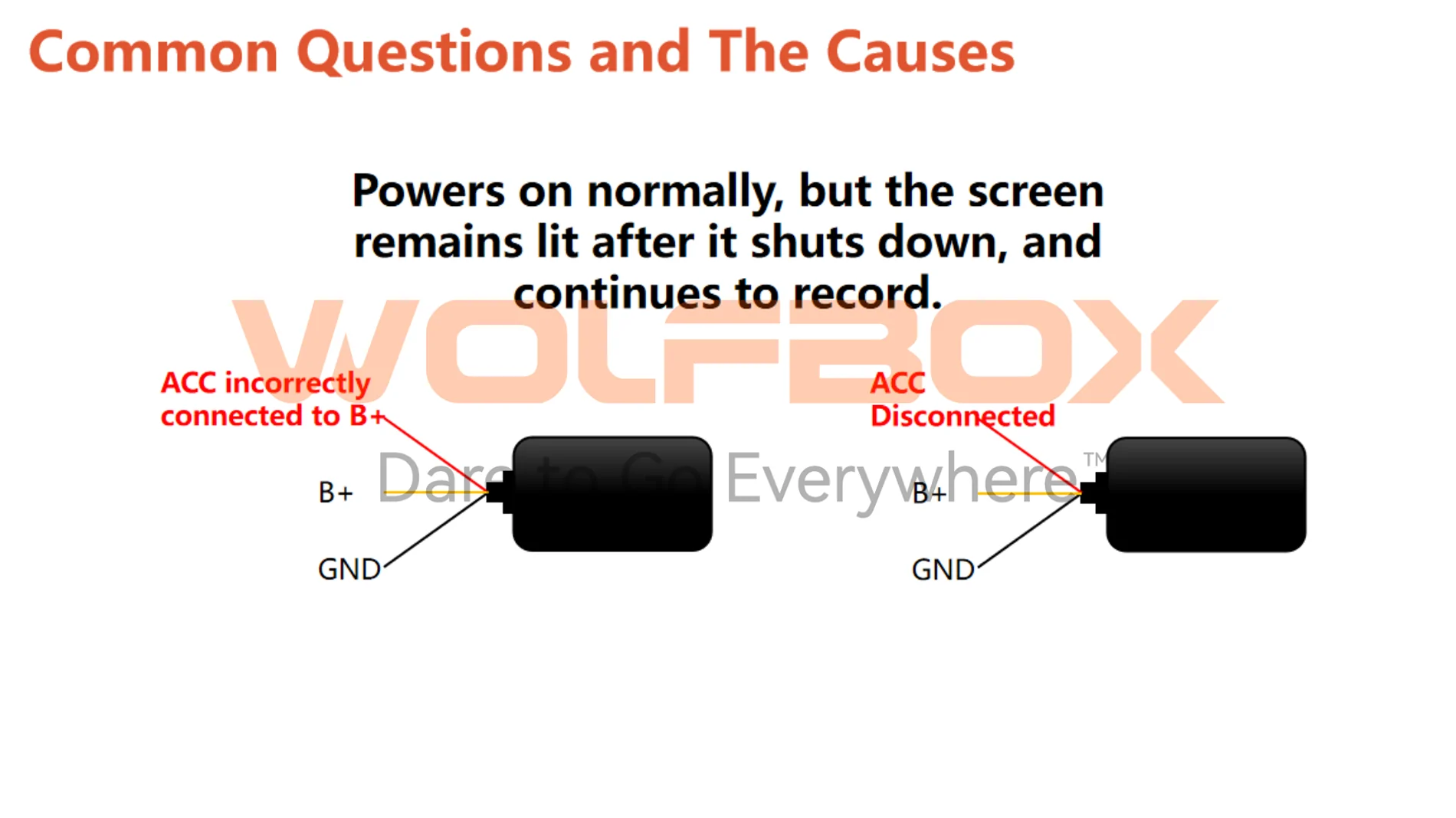

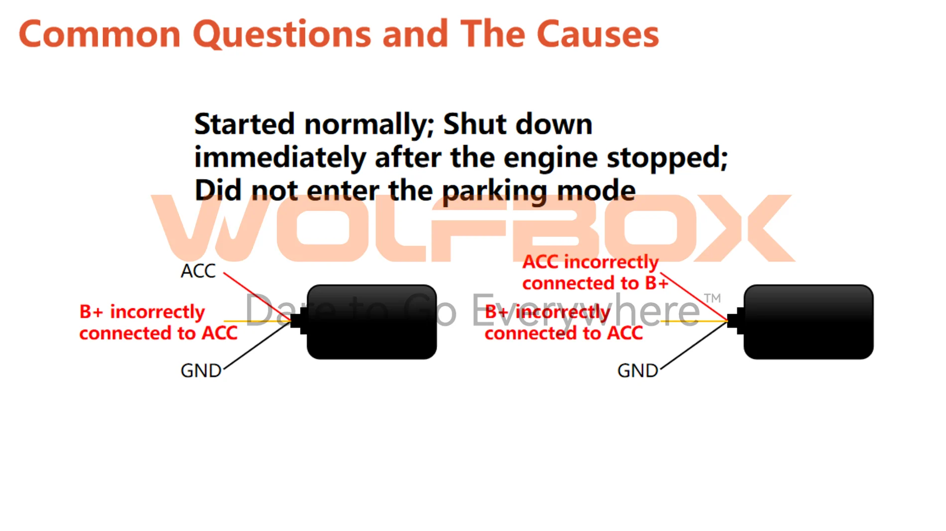

In today’s article, we’ll dive into common issues that may arise when a hardwire kit isn’t working properly and explore their possible causes. This guide can help you troubleshoot and ensure your dashcam setup is running smoothly. Let’s get started!
